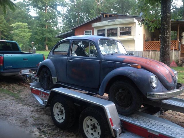

My son just turned 13. He'll be driving in just 3 years. Found a pretty cool deal on an old beetle. Rescued it from redneck hell. Hoping to teach him the value of sweat and elbow grease. Hopefully he'll treat it with respect if he has to work on it to get it running.
1971 Standard Beetle. 1600 DP engine. Body and interior are in surprisingly good shape. Floor pans are rusted to hell. We've got 3 years.
Almost had it running today. It tried

PostPosted: Mon Aug 11, 2014 5:36 pm
Nice simple car to start with.

There's so much that needs to be done. The guy I got it from ran a speaker wire from the battery to the coil and a couple from the starter. The key does nothing. The wire harness appears to be all there and intact. Gonna get the test light and multimeter out over the next few weekends and check everything. Fortunately, there aren't many wires.
PostPosted: Mon Aug 11, 2014 11:01 pm
The valve stems didn't even have cores in them. None of them. It was fun rolling it off the trailer.

PostPosted: Tue Aug 12, 2014 10:49 am
Got it cranked just a little bit ago. Gave the distributor a twist 90 degrees clockwise and it fired right up. (Hotwired coil still)
Now to chase down some electrical demons. Pray for me.

I'm going to try to figure out why the ignition switch does nothing this weekend. The driver side back glass is out and I suspect the voltage regulator has gotten soaked. Then I'm going to rebuild the carb and see if there's any salvaging the distributor. The mechanical advance is rusted and doesn't move freely.

I worked on these cars cor many years, if there s anything I can help with let me know. To free up the advance I usually but the drive claw in a vise, gently put vise grips on the top shaft where the rotor goes, WD40 or something like that in the shaft hole and rotate the grips back and forth. Usually within 3 minuets or so it's free, check the vacuum can. It it has a retard side it's most likely blown and leaking. Timing it the death of these air cooled engines, get it right and they run for a while.

Pretty sure it's just a single port distributor. No retard just advance. Will check for sure this weekend. I'll try to free it up that way. Might be next weekend. Had a death in the family and got folks flying in. I think I'm supposed to be around them or something. Never been good at that.
