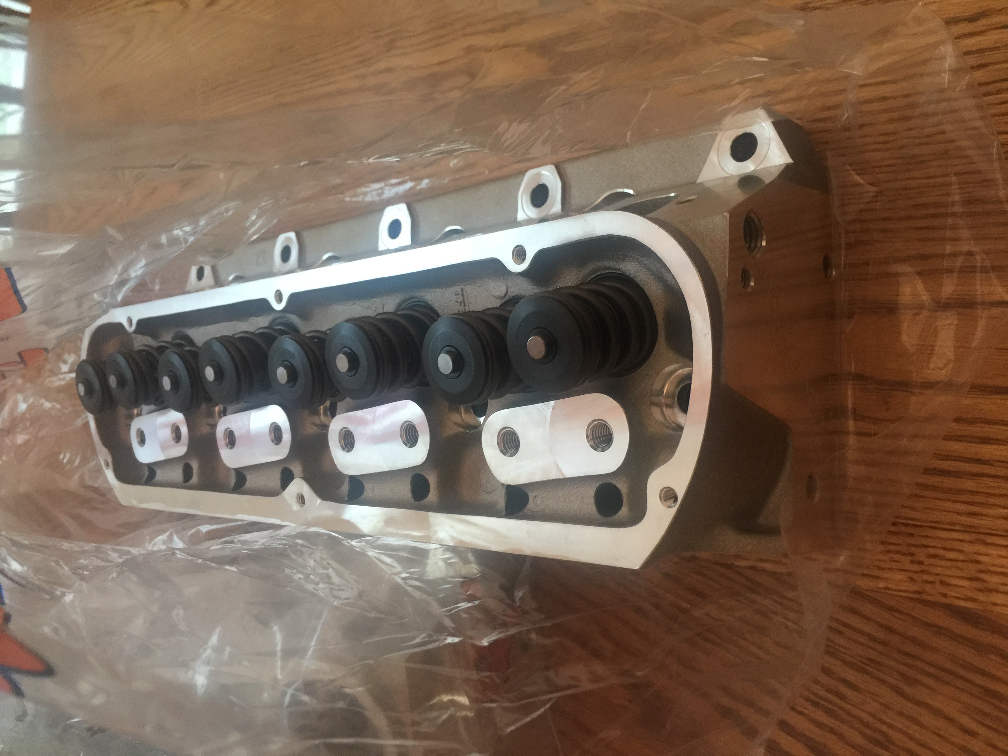

So I'm FINALLY putting the finishing touches on my shop this week and can maybe start working on my car again.
My wife and I had a pretty big argument the other night about how much money I've been spending on projects. I told her I make more money than her, so I'll do what I want.
So anyway she doesn't know I bought these...
 Post subject: Re: My next project...
PostPosted: Sat Sep 15, 2018 9:04 pm
Nice! I was looking at a 347 Stroker today a friend got in trade from a supposedly knowledgeable guy. The pushrods are way too long, so the valve train needs to be gone through. Easier to check and repair while it is on the stand...

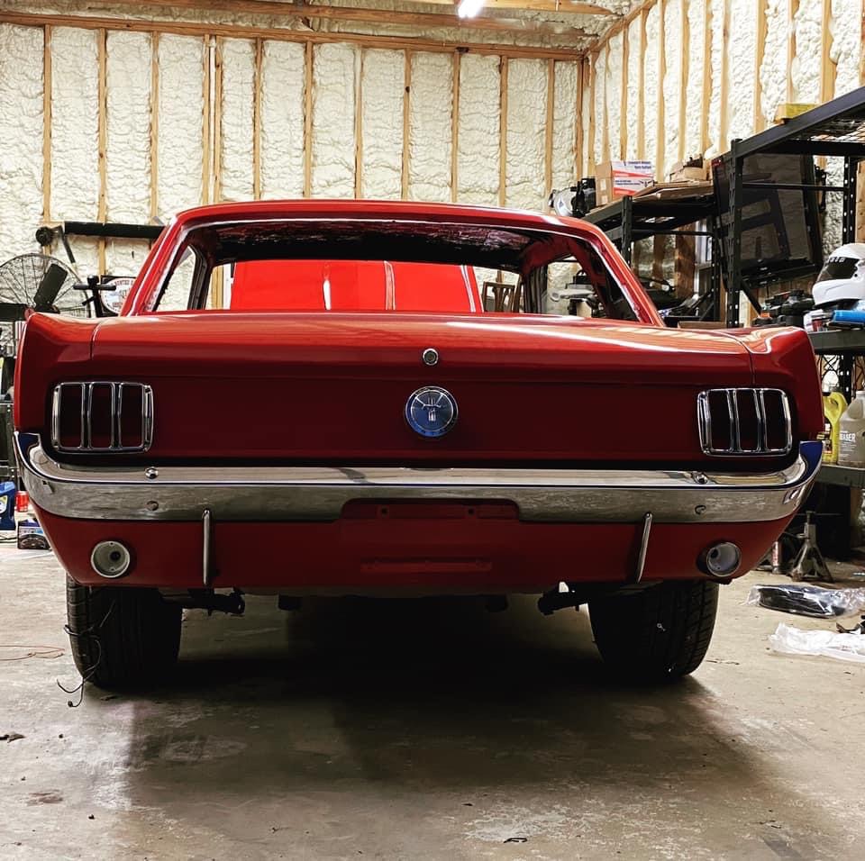

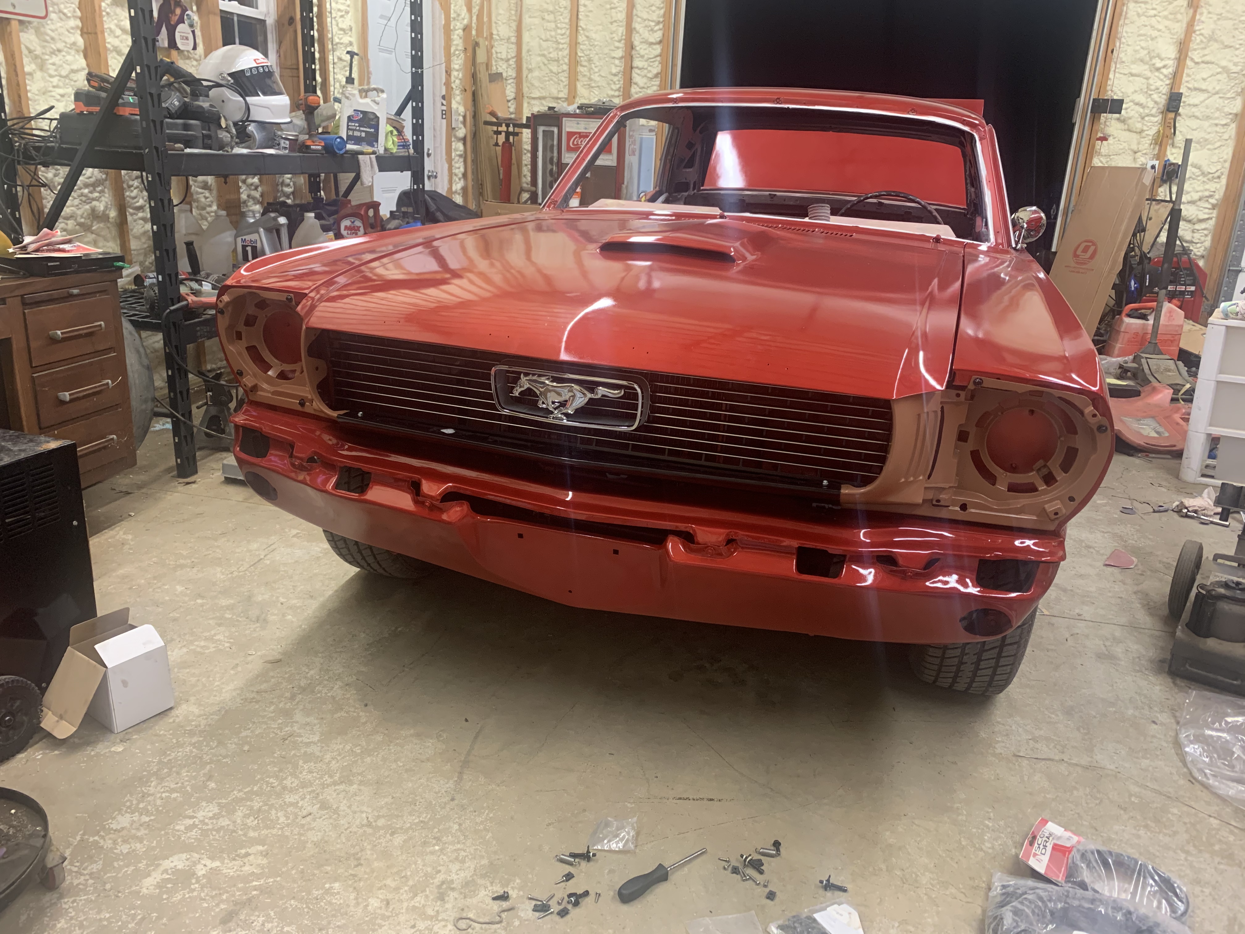

PostPosted: Sun May 16, 2021 11:07 pm
Finally got paint. Still have to paint the Fender extensions / Headlight buckets.
