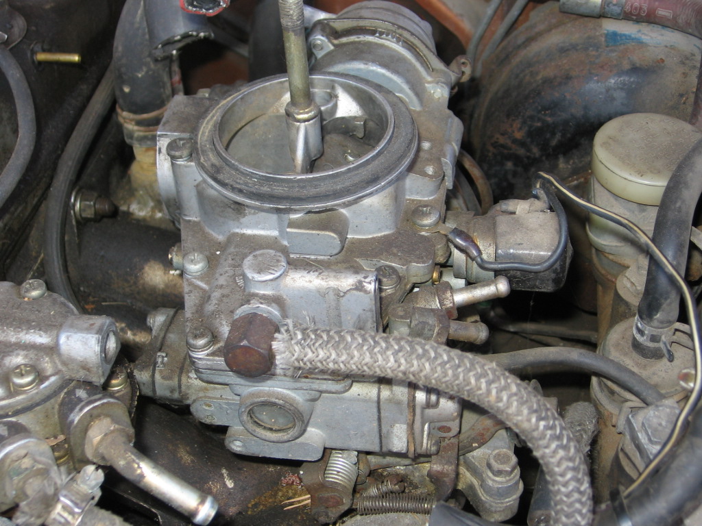

Does your carb look like this?
File comment: Mikuni carb
The Mikuni carbs have about the same problems as the Hitachis.
Probably the accelerator pump.
Your best bet is of course,a Weber.

looks jus like that!

Look up the Weber site or a speed shop site and see if a kit is available for it.
 Post subject: Re: RAM 50
PostPosted: Sat Jun 14, 2008 3:51 pm
Posts: 590
Location: Spokane,Wa.
I would go the same route as with the LUV trucks.
Get a Weber off of e-bay used,rebuild it.
The adapter plate will be different,but is available I'm sure.
I'm not sure about the linkage as the Weber was already on the engine when I got it.
I do remember switching from the Weber to a stock carb was no problem though,keep in mind this was on a race car and I didn't have to worry about the vacuum lines so much.
