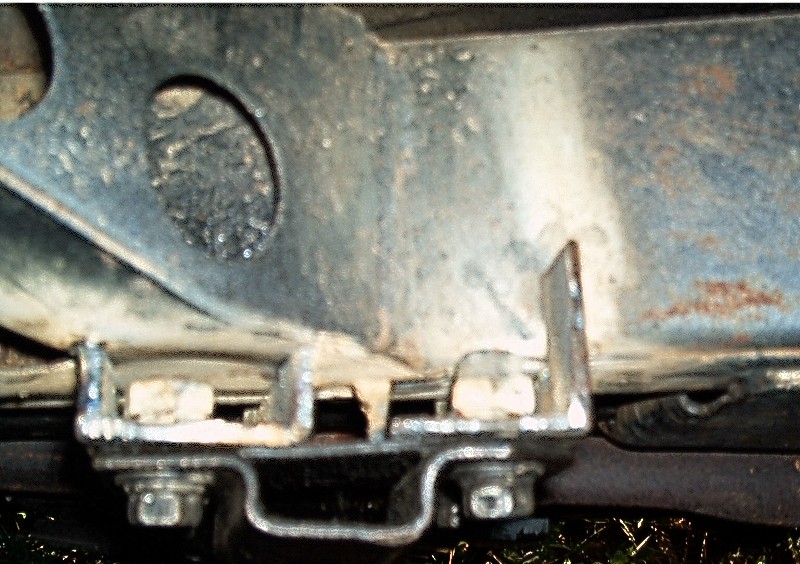

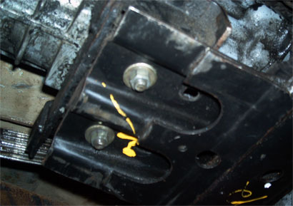

I went to the shop today, the tranny bolted right to the engine. However the crossmember that had the rear stock mount (for the tranny) Most of it was rememoved. There was a small bit left on each side where the torsion bars went through. The mechanic then welded brackets on the side of the frame for the removeable crossmember. A piece of the floorboard was cut out for the 4wd shifter as it is in a differnet place than ths stock shifter.

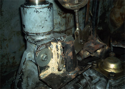

The 4wd driveshaft fit right it. There was a new bracket made for the
E-Brake cable to bold to the tranny. I took some pics and have to get them scanne evtentually.

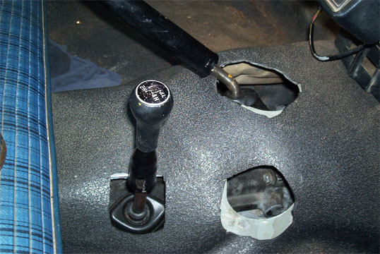

Zane, did you use the LUV front driveshaft, or did you take one from a Trooper? Do you have a picture showing how large the transfer knob cutout is? Where did you get the 5" measurement for the rear driveline?

I got a few pictures I am going email to BEN and one of them has a pic of the holes with the shifters.

http://www.hostingmojo.com/images/zanemurray/Bracket.jpg
http://www.hostingmojo.com/images/zanemurray/Mount.jpg
http://www.hostingmojo.com/images/zanemurray/shifterhole.jpg
http://www.hostingmojo.com/images/zanemurray/brakebracket.jpg [/url][/code]
