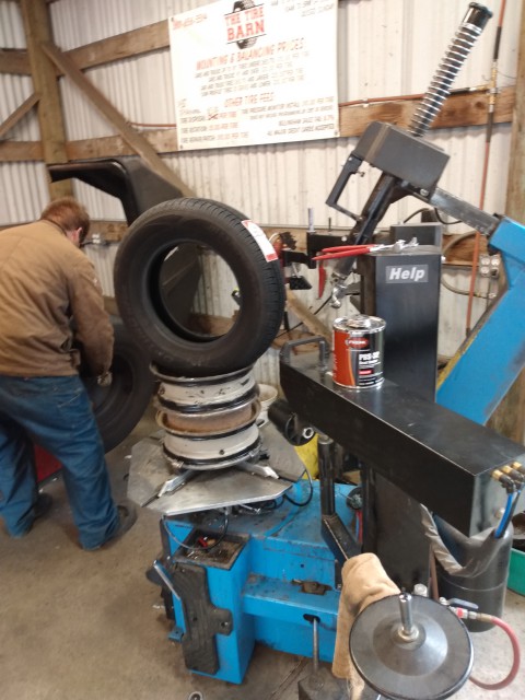

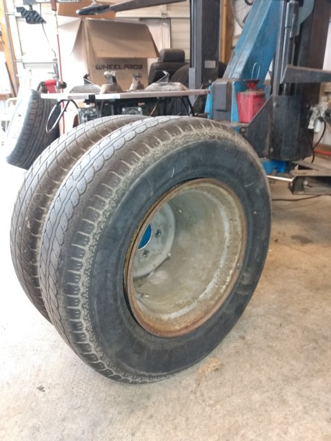

I took my dually luv in to get tires for the first time since I got it yesterday. I had assumed someone jammed a different rear end in it, buy it turns out each side has one really wide rim which holds 2 tires. Tire shop guys were tripped out!
