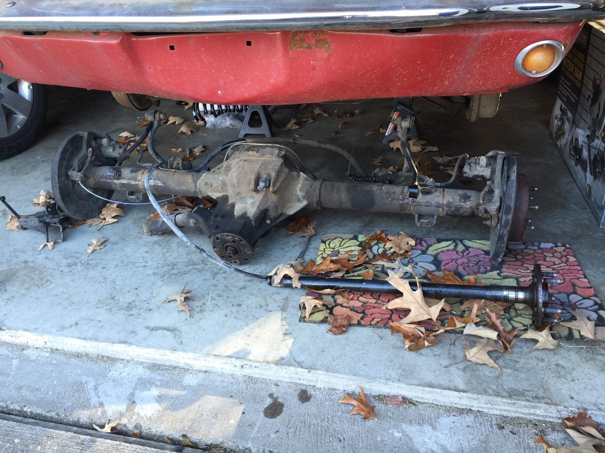

The local rear end was gone, so went to pull a part Saturday and got a 3.73 posi 8.8 with discs. Got an extra short side axle and hauled it home.

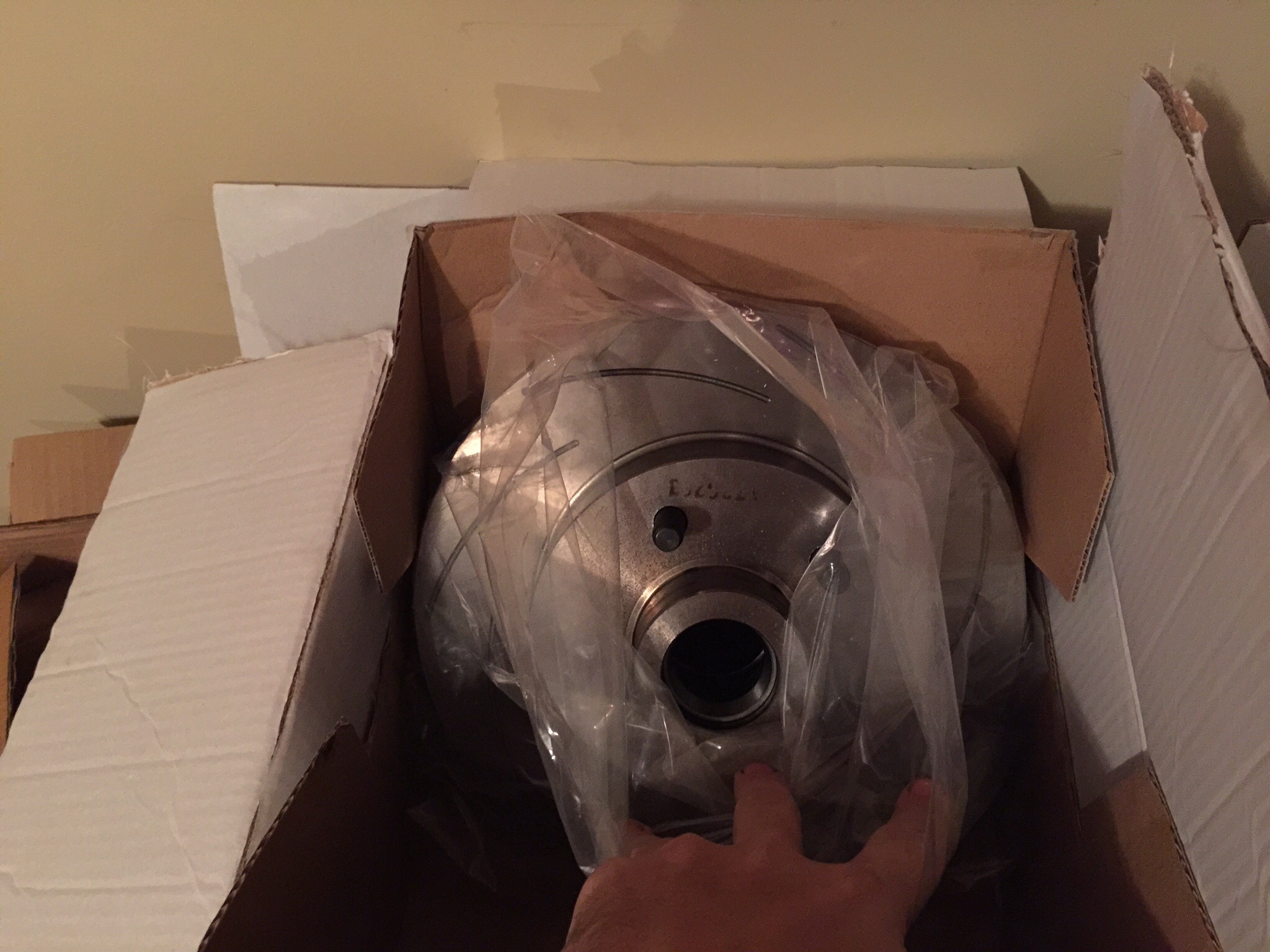

Parts are still trickling in. Should have the rest of the brake conversion stuff by Friday and have plenty to keep me busy for a few weekends after.
Ordering these wheels in a couple of weeks so I can get it off the jackstands when the suspension and rear stuff is done. Then hopefully I'm done with the expensive stuff for a while.

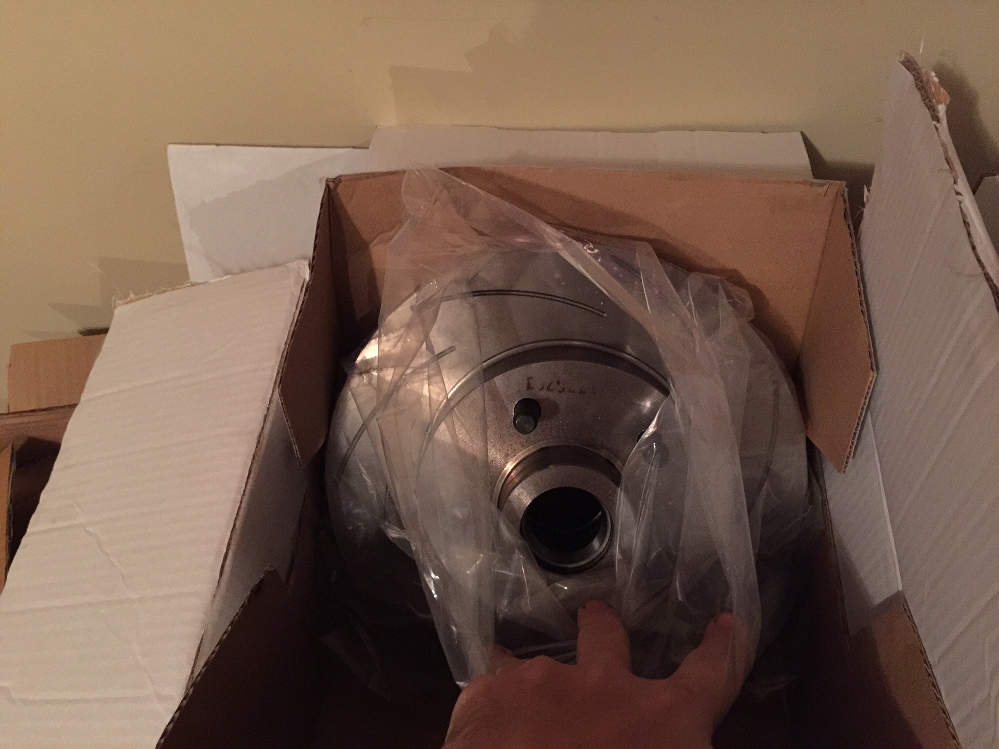

The front brakes and spindles are the 99-05 mustang style. Floating dual piston calipers.

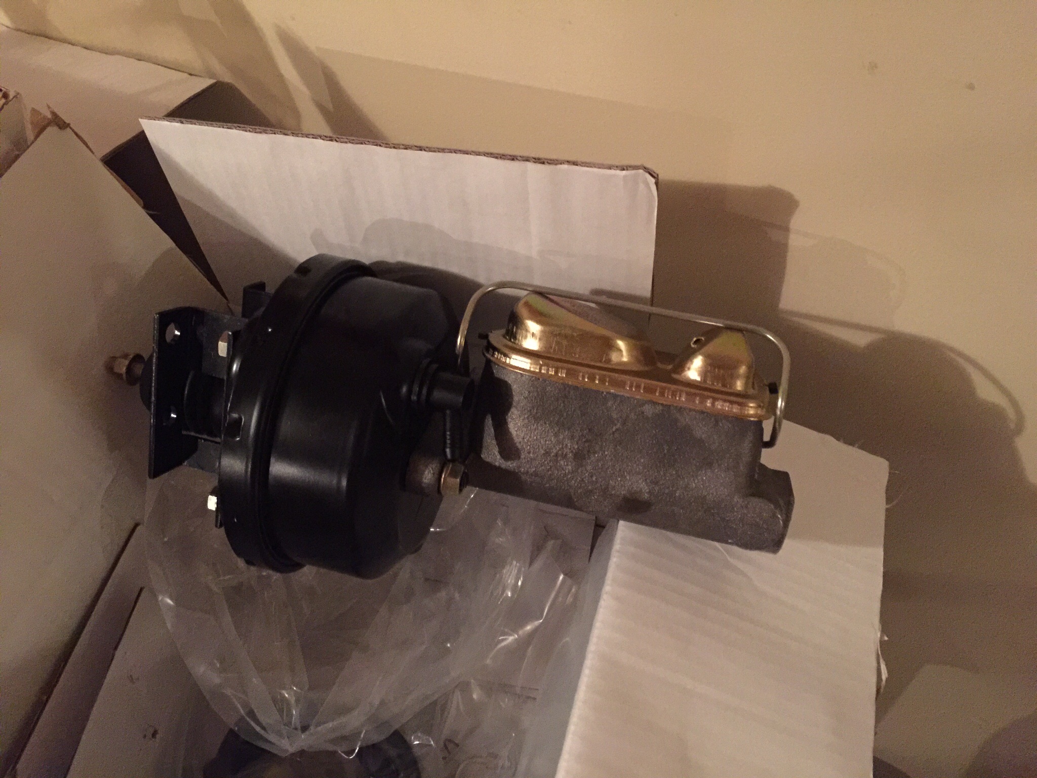

What master cylinder and booster are you using?
 Post subject: Re: Next project...
PostPosted: Wed Dec 16, 2015 12:33 am
I bought this kit from CSRP. http://www.discbrakeswap.com/Mustang%20 ... P%204.html

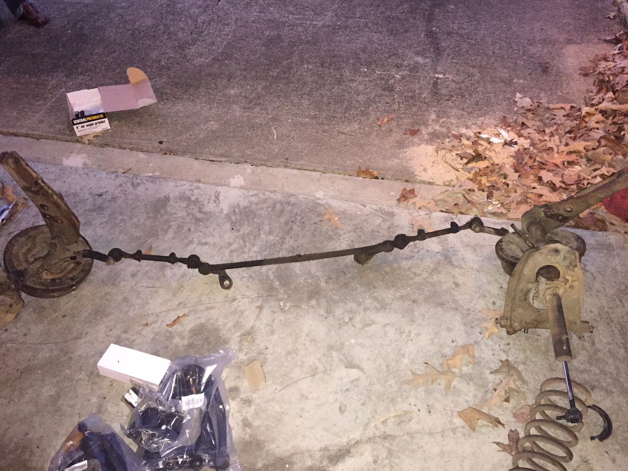

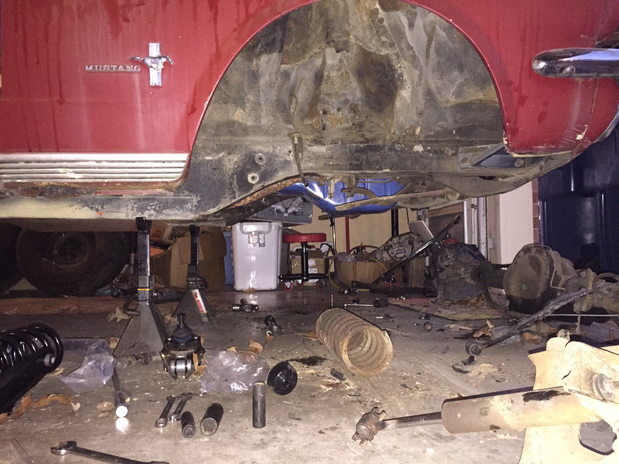

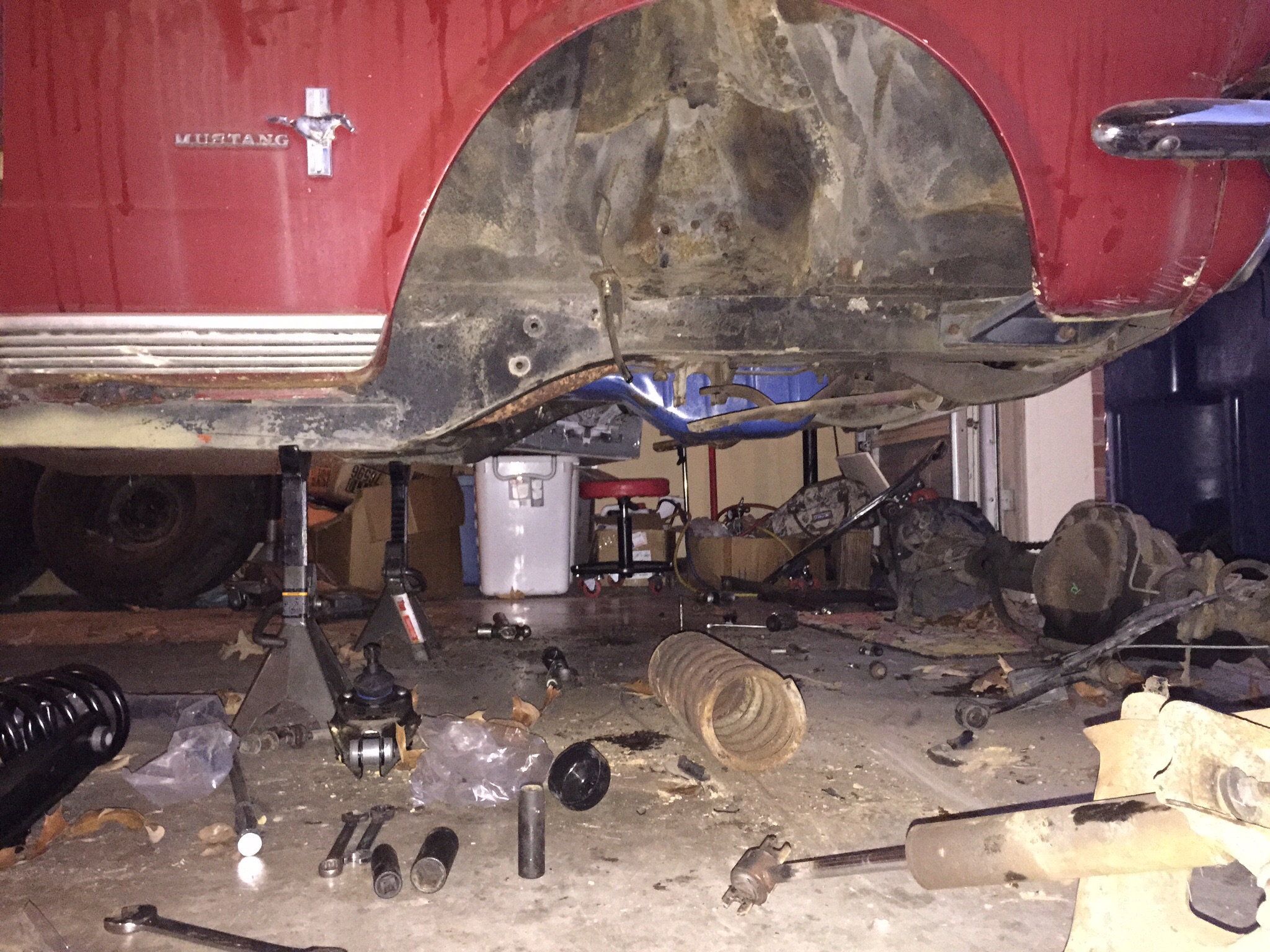

Productive weekend. Got all the front suspension out and off to the side for reference. I've got 2 long weekends coming up so I hope to get all the new stuff in before the first of the year. Still need to clean the wheel wells and shock towers while access is easy...
Still have to clean up the explorer rear and take it to my guy to get narrowed. Hope to have it back on the ground and rolling by the middle of January.

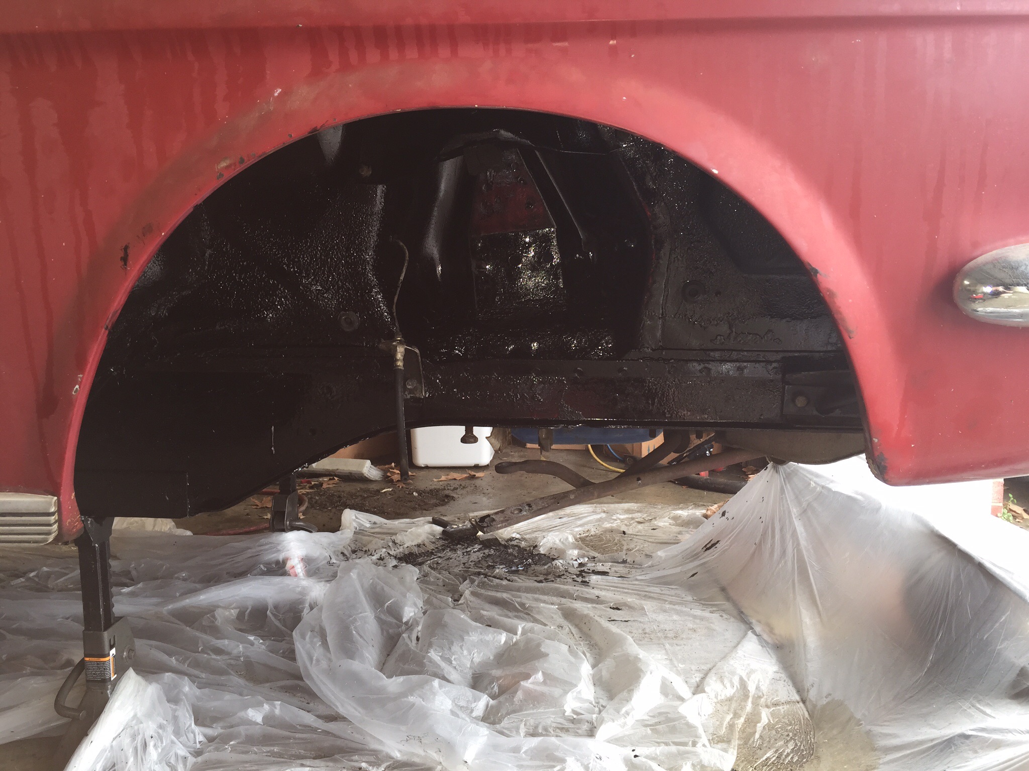

Got the wire wheels and cups and wire brushes and all out today and cleaned up the wheel wells as much as I could. After much grinding and brushing and blowing and repeating I was reasonably satisfied that the POR 15 would have a decent base.
As per the instructions, I sprayed the area with marine clean, and then with metal ready and allowed it to dry for about an hour. It was dry to the touch, but I went back with compressed air and a brush again to make certain that all the loose and flaky bits were gone. There was some old rust coating that came off pretty easily, but was really stubborn in a few places. After it was evident that it wasn't coming off without days of grinding, I decided that the stubborn layers were just another layer of protection.
I'm really satisfied with the finished product. I'll also be doing the whole undercarriage, the interior floor, and the trunk with this stuff once I get it back on the ground. It's pricey, but an ounce of prevention is worth a pound of cure, right?
