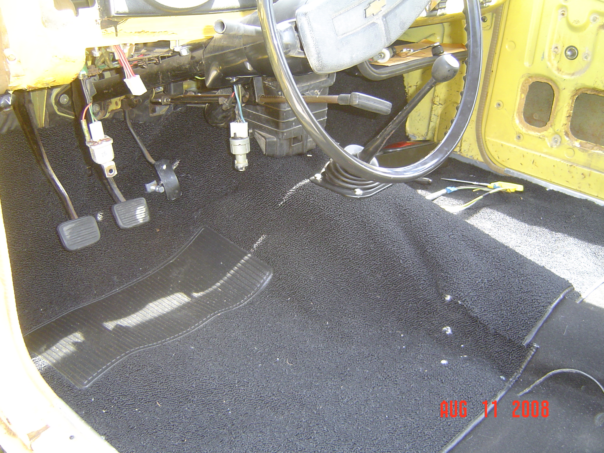

When i re-carpeted mine a few yrs back i found an good deal on a new old Chevy kit on eBay i think it was late 60's
impala. 66-68 it was preformed for the hump and i positioned the heal pad and trimmed off what hung out the doors
and only put a few self tapping screws near the edge of the hump to hold it in place along w/ my shift hole plate and side
metal pcs and used some black felt material for the floor to finish up to the back wall since its under the seal & saved the
other of 1/2 of carpet to hang on the back wall.....(which wasn't done in these pics).... Here's a couple pics of mine

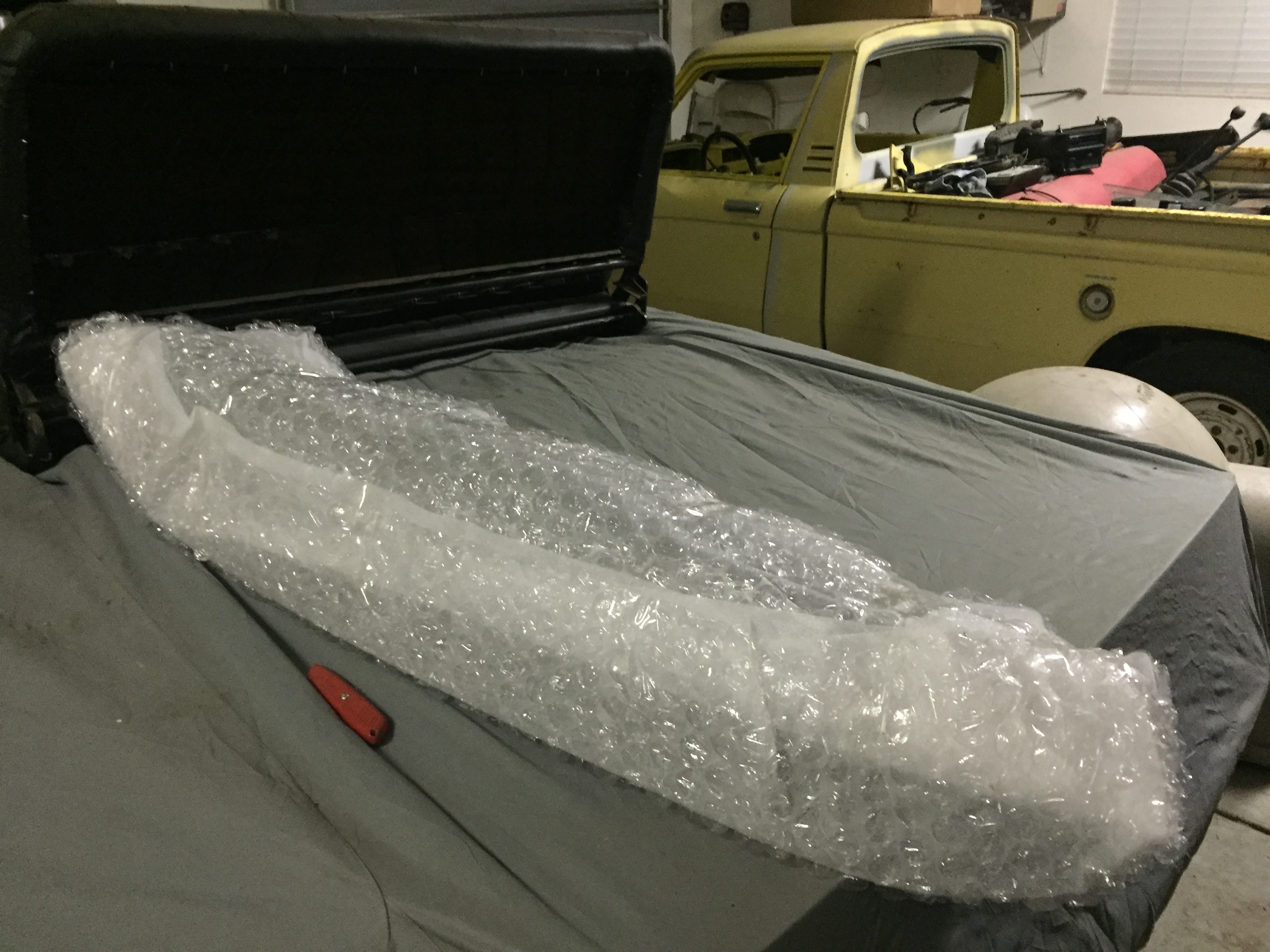

Dash is here.

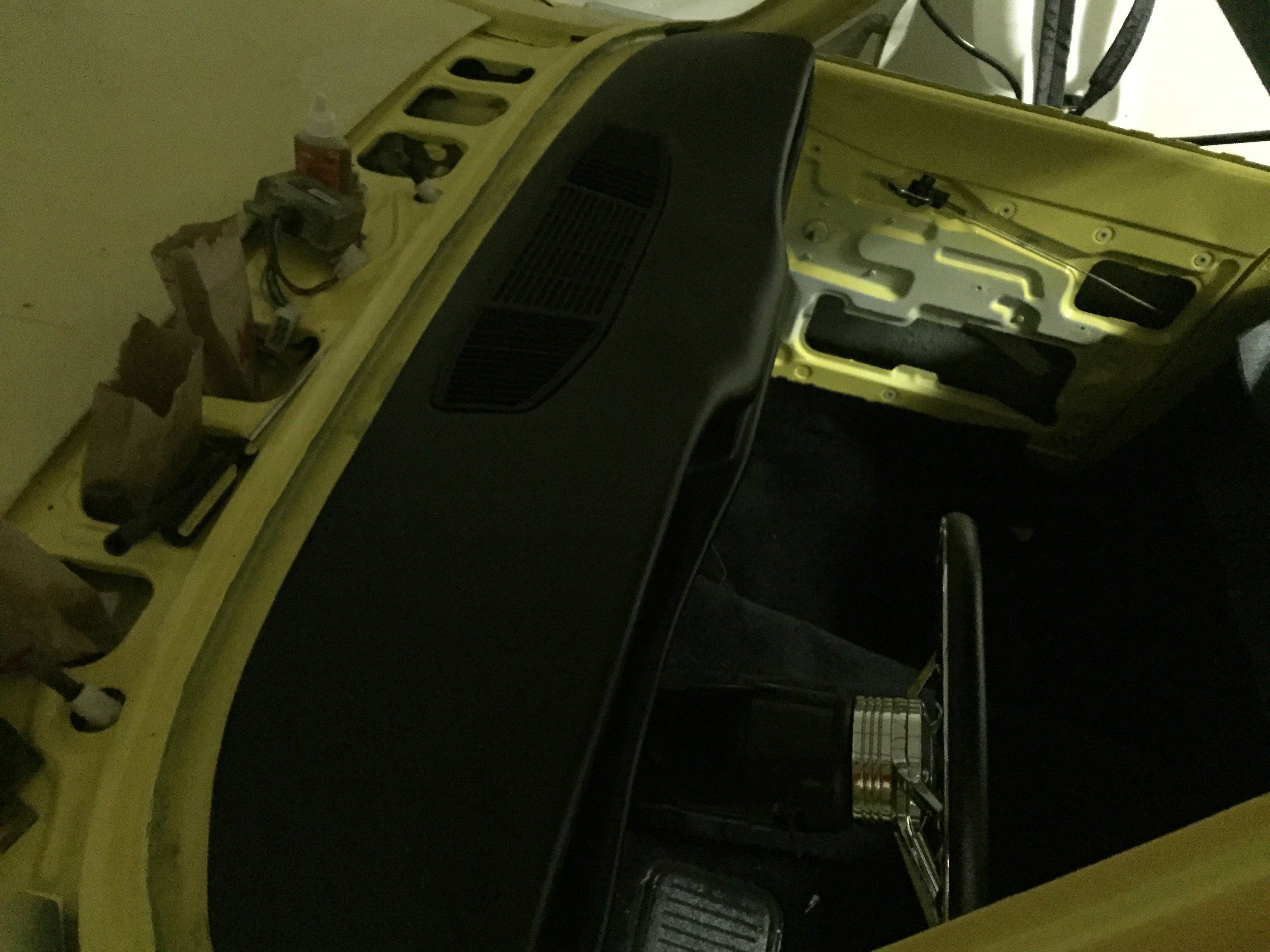

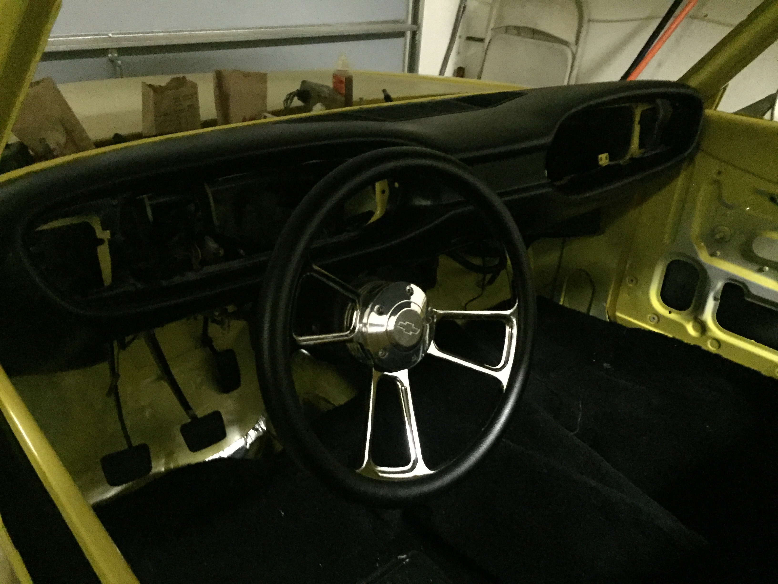

Turned out great.
