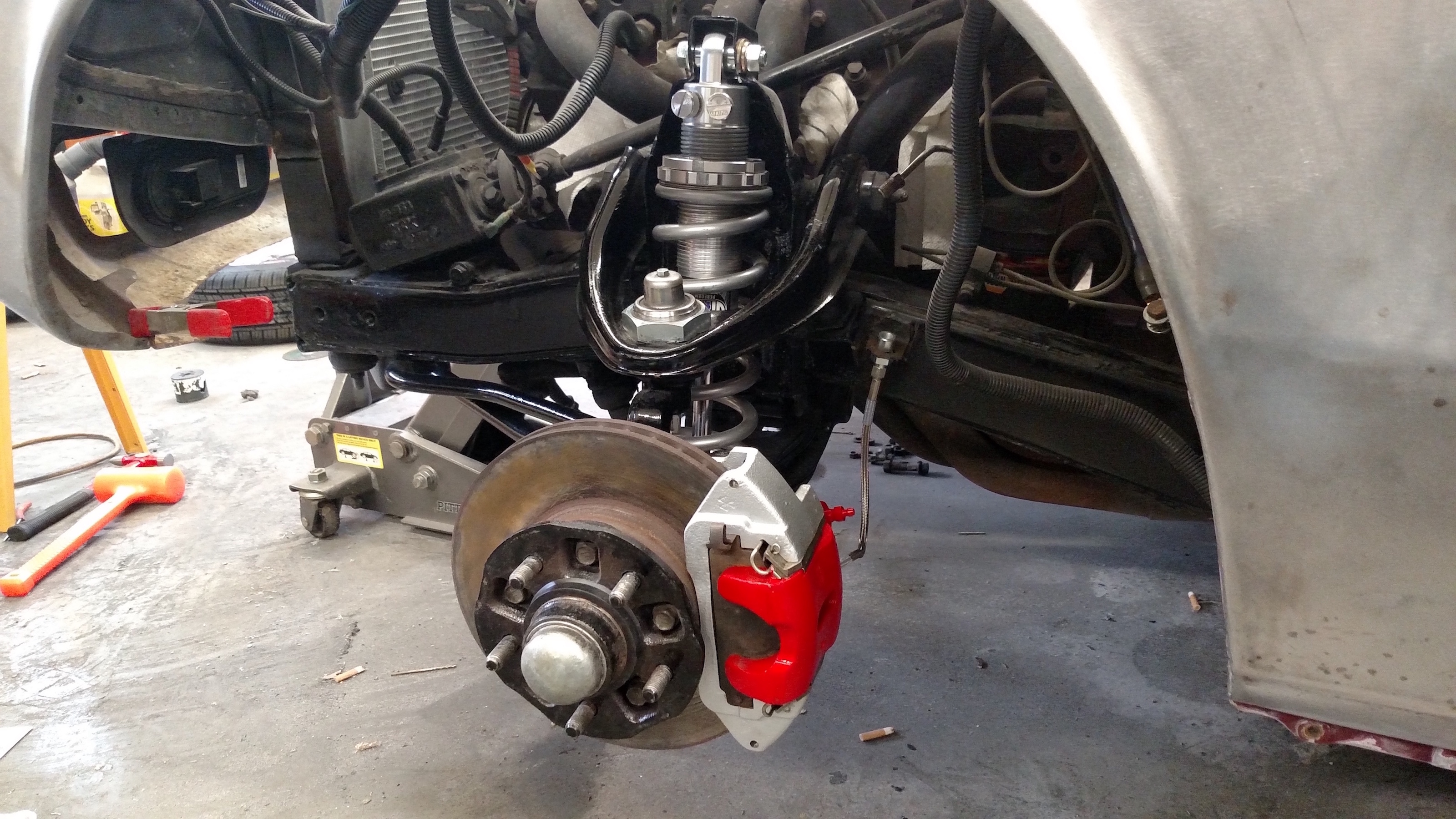

Mine are Art Morrison, not sure of the part number. I have right at 760lbs on each front tire. I run a 230lb spring.

Do you happen to know the compressed and uncompressed lengths of these coil overs? and are you able to get it to a ride height you like?

No I don't. I know they came with a 10" Spring and you could lower it to the bump stops. I wanted to go way lighter so I use a 12" Spring and collapse it more. I am happy with the ride height.

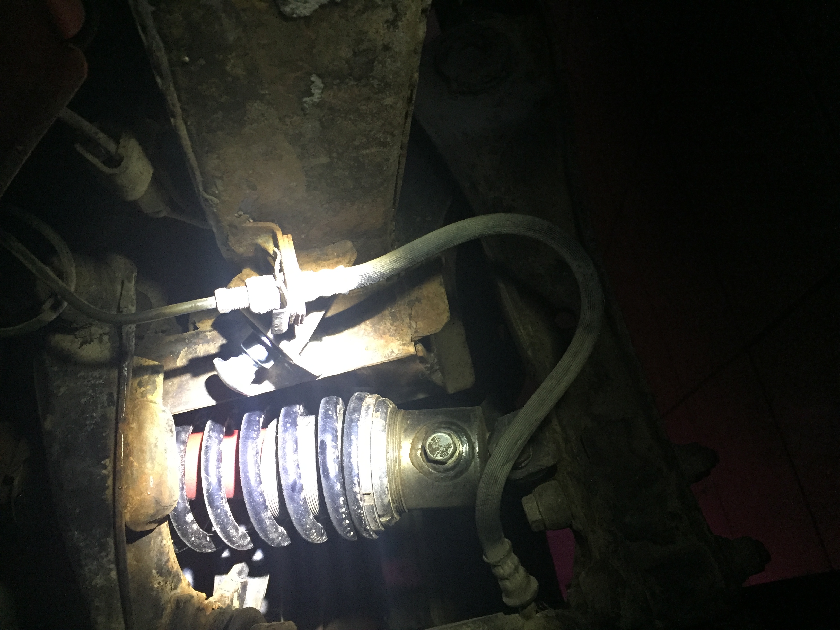

I got the Viking Performance double adjustable for the front of mine. Looked at the qa1's, viking performance was about $100 cheaper total price, & the warranty is twice what qa1's was. Very nice pieces. My springs are 9" & rated for 400lb. Compressed height was 10.04, extended was 14.24. Part # c205w. These are what the guy from viking recommended after telling him what I had (76 luv & sbc) They bolted on perfect. Hope this helps. :D
