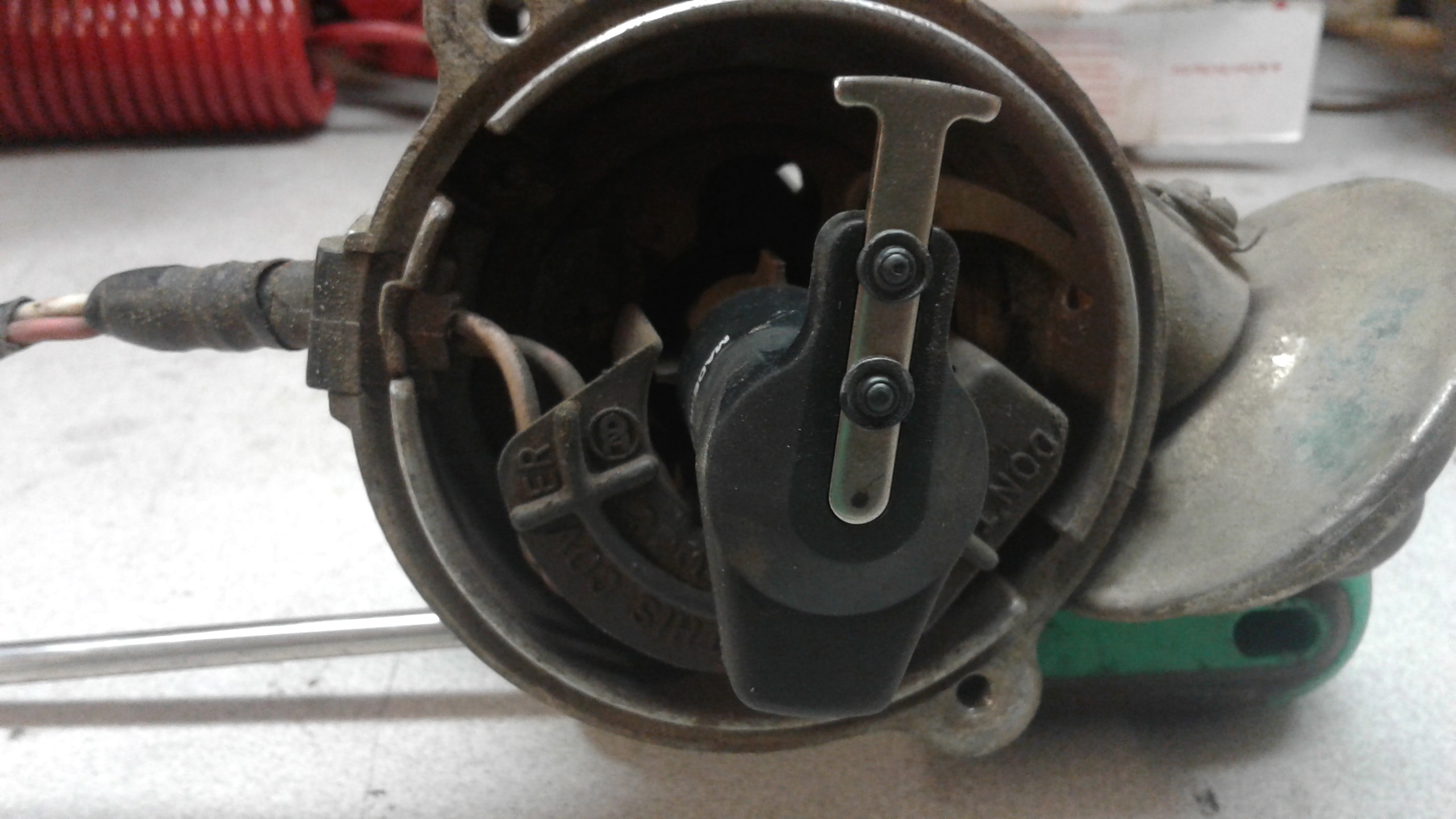

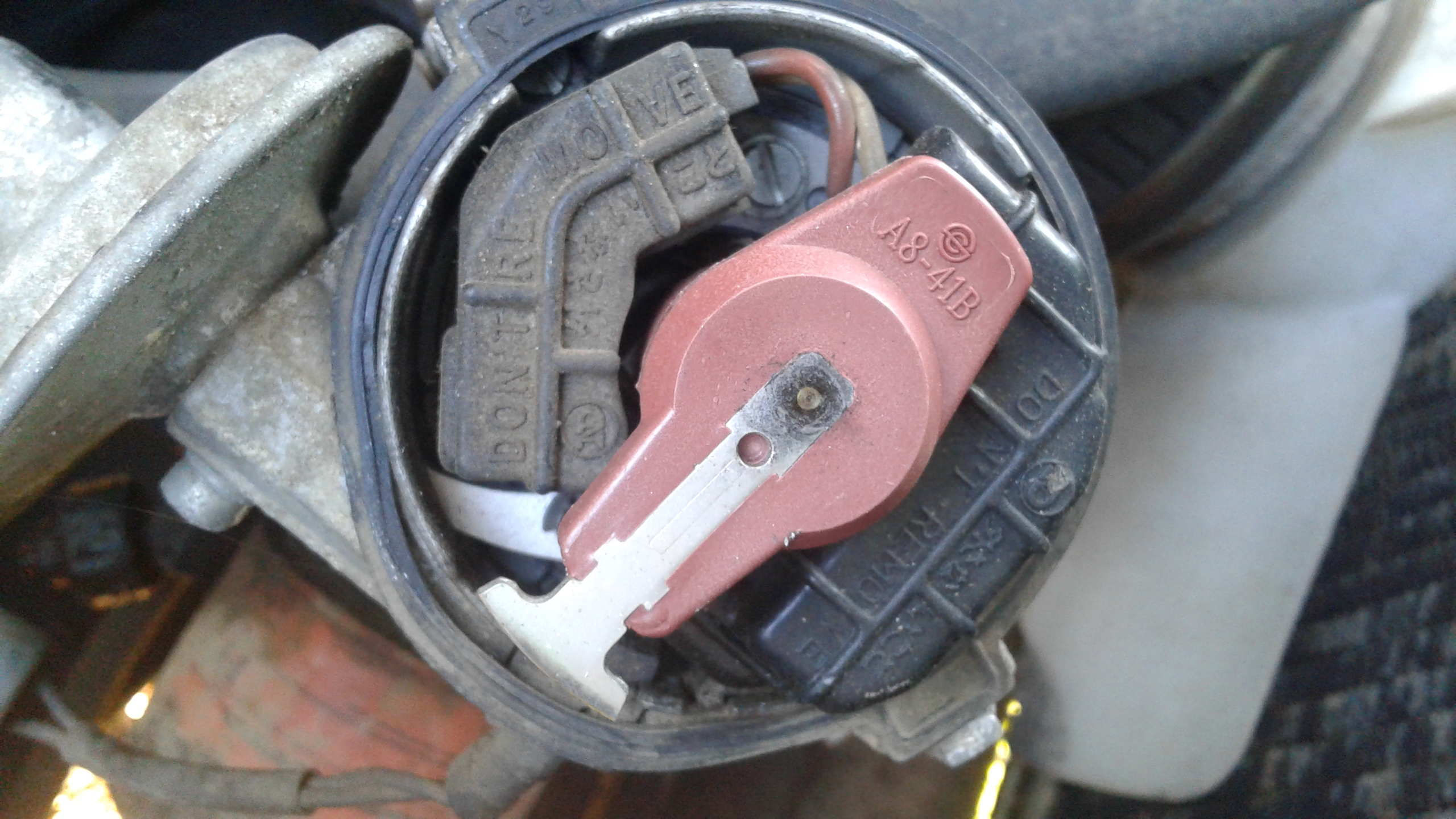

The newer Isuzu electronic distributors do not have a built in coil like the GMs do.
They still have the coil on the inner fender.
They have a built in ignitor rather than a remote one on the coil.
First pic is of an early distributor with remote ignitor.
Second pic is of a later one with built in ignitor.
