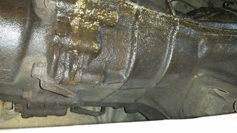

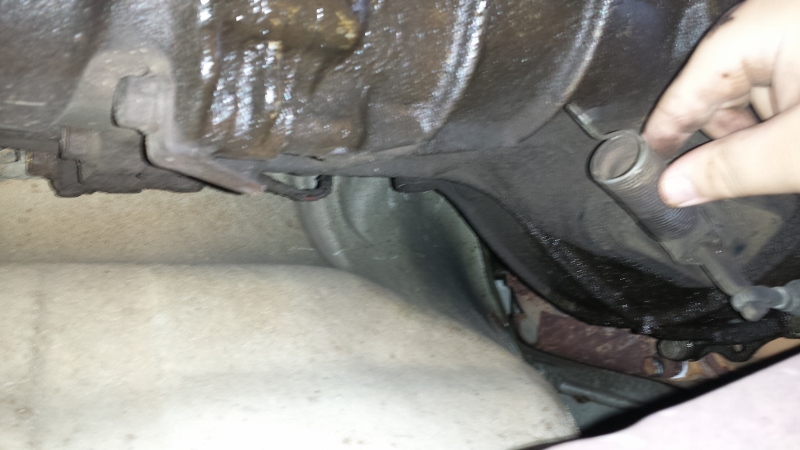

I took a couple of pictures I found where that spring connects to but the piece is broken, I assume I still should look into adjusting my cable?

This is what I found.

That is the return assist spring for your clutch arm. If the hook end is broken off the spring first try bending a new hook using a pair of locking pliers and a something like a pair of needle nose. If the end is broken from the end of the metal piece the spring hooks to just drill a new hole. If you can't repair the spring just replace it with something similar, if it's a little stronger it won't hurt, the spring assures the throwout bearing retracts fully & doesn't drag slightly against the clutch fingers. Jack is correct, this spring is not causing your shift problems, you need to check the adjustment. Either a Haynes or Chilton's manual for your truck will have a clutch adjustment procedure & pictures, not as good as a FSM but good enough in this instance. Don't try measuring the gap at the firewall, just make sure you have about 1" of freeplay without clutch resistance at the top of the pedal stroke when pushing with your fingers & make sure you multiple cycle the clutch to seat everything after every adjustment.
While you are under the truck check your tranny lube. There is a fill plug about half way up the side of the tranny- it's usually about 15/16" head- the lube should be flush with the bottom of the hole. If you wish to change it (a good idea) the drain plug is in the bottom of the transfer case. Drain the old lube, fill with 10w30 motor oil until it runs out the fill hole, takes about a gallon.

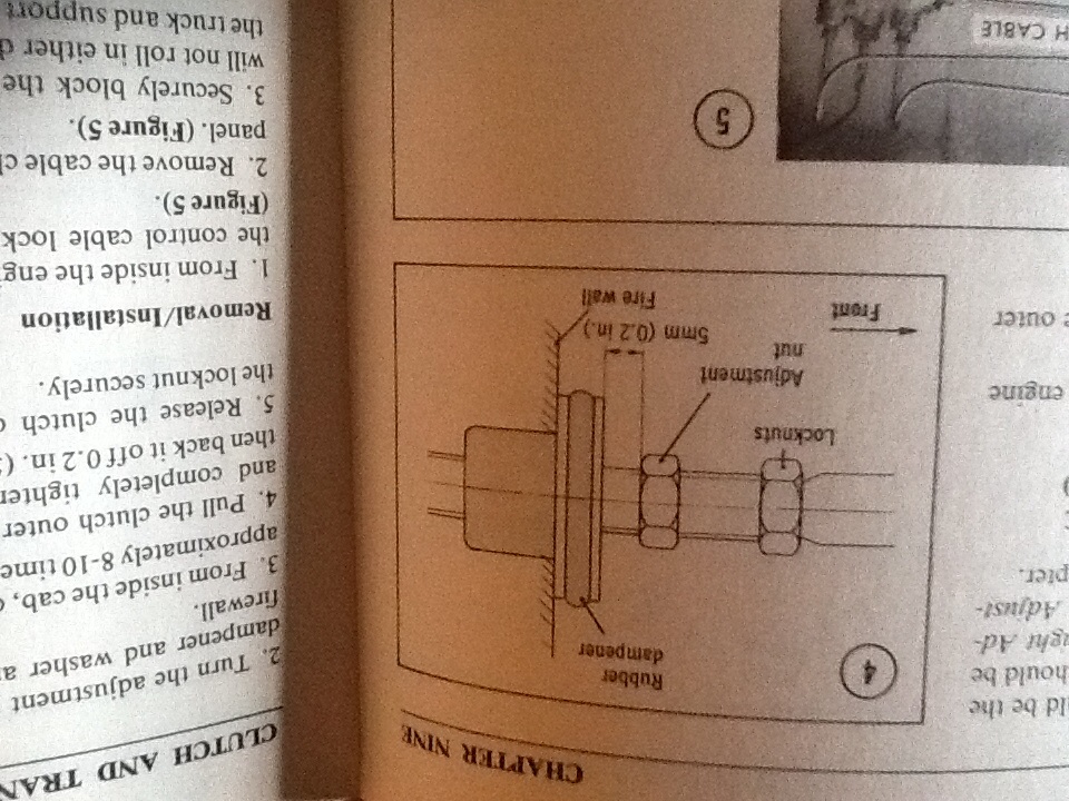

It's real simple. Loosen the jamb nut on the cable at the firewall. Tighten the nut and take out all the play. Get in the truck and press the clutch pedal about 10 times. Go back to the engine compartment and loosen the adjusting nut until you have about 2/10 of a inch free play, tighten the jamb nut and your done. This should take 2 or 3 minuets. Make sure the clutch pedal bracket s not cracked, the pedal should be at a 90 degree angle to the floor. Other then getting yourself a manual I don't know how else to help you with this.

Okay thanks! This helps a lot!! Thanks so much guys I will go out and adjust that here shortly
