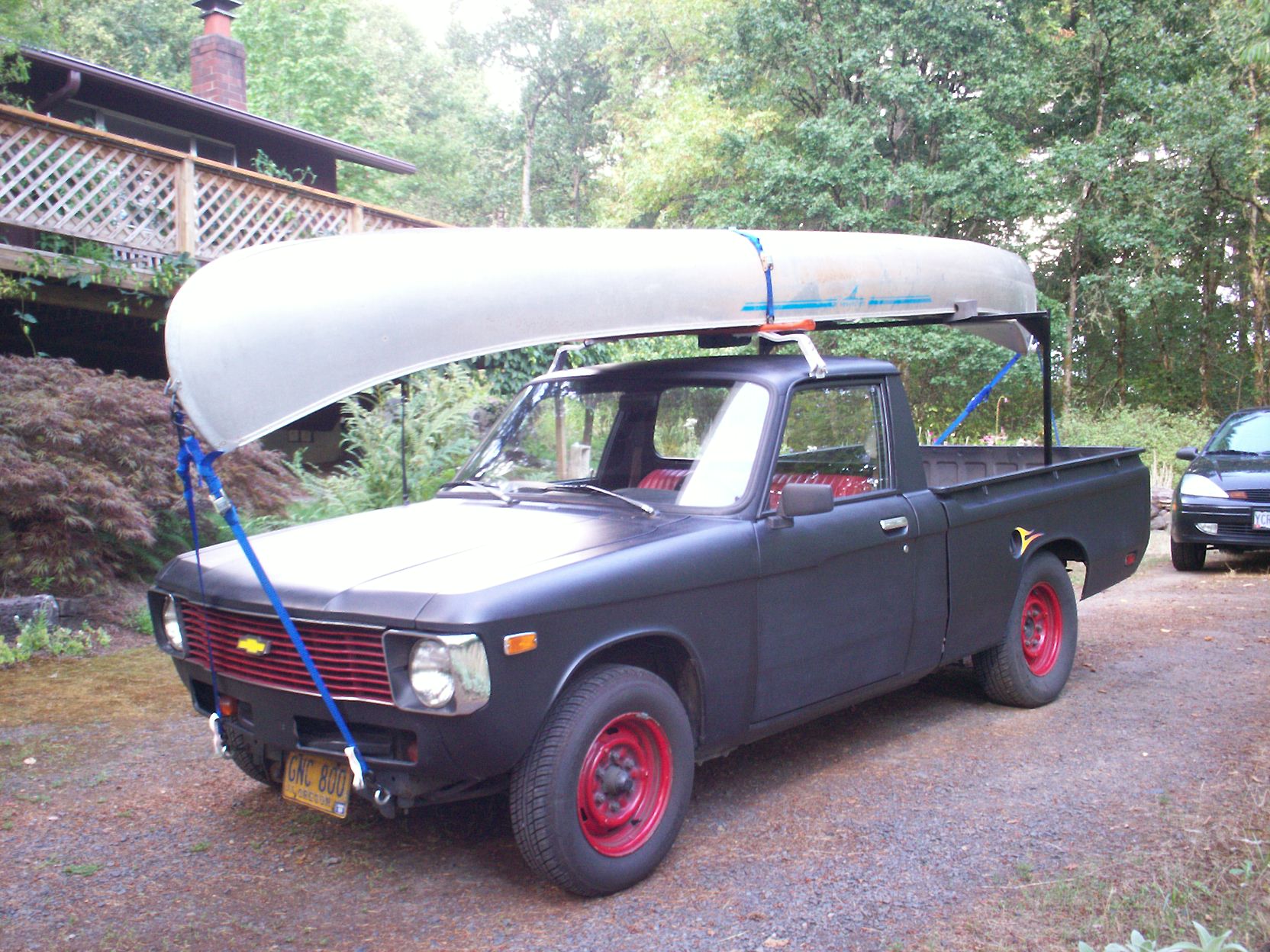

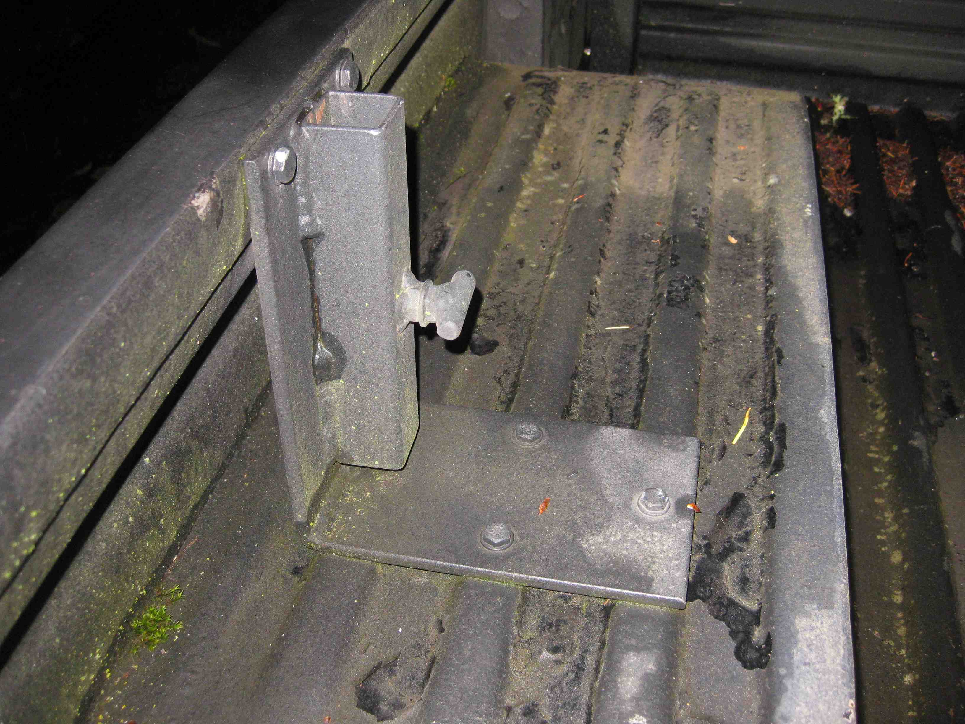

Here's an idea I came up with, a removable bed rack so I don't have the hassle of a trailer. I took some measurements down to a local welder and he made it up for me. He also welded some big eye bolts to the front frame so I can run tie straps to them; at the rear, I run tie straps to the built-in cargo hooks on the tailgate.
The front bracket is an old school luggage rack that clamps to the drip rails; I found it at the local thrift store for a buck. It works great; I've been all over Oregon with it and no problems. I think I'll add some wood strips to the top of each bracket, so there's no metal-to-metal contact on the canoe.

PostPosted: Fri Jun 14, 2013 8:22 am
Posts: 906
Location: N W Arkansas
What about using strips of old tire instead of pieces of wood?
PostPosted: Fri Jun 14, 2013 12:41 pm
Joined: Fri Jan 18, 2013 4:28 pm
Posts: 36
That's a great idea! Wish I'd thought of it...
