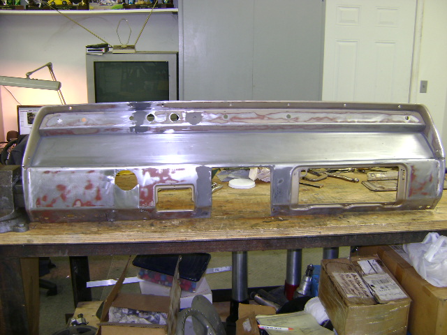

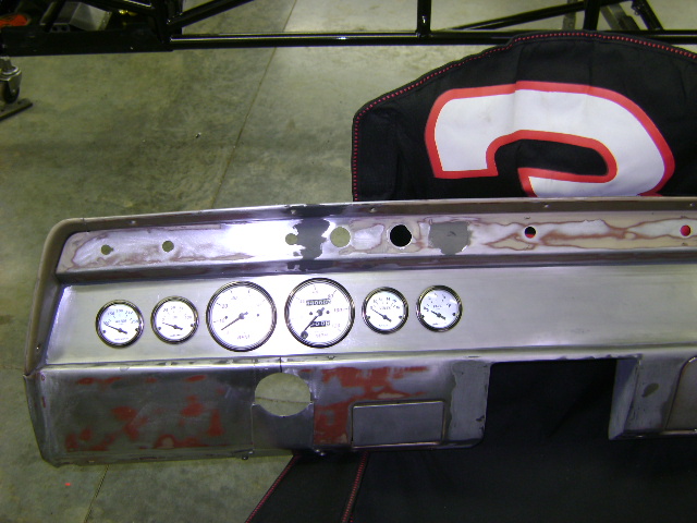

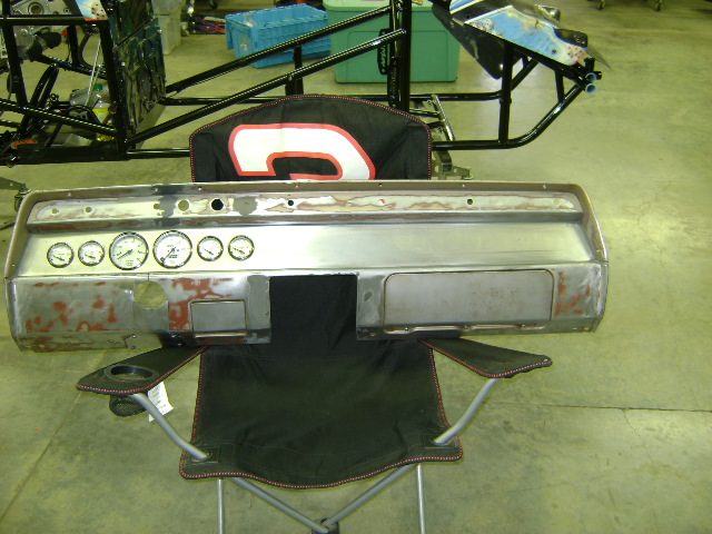

the dash insert is about done . 6 holes for the gauges and one for the radio and off to the painters.

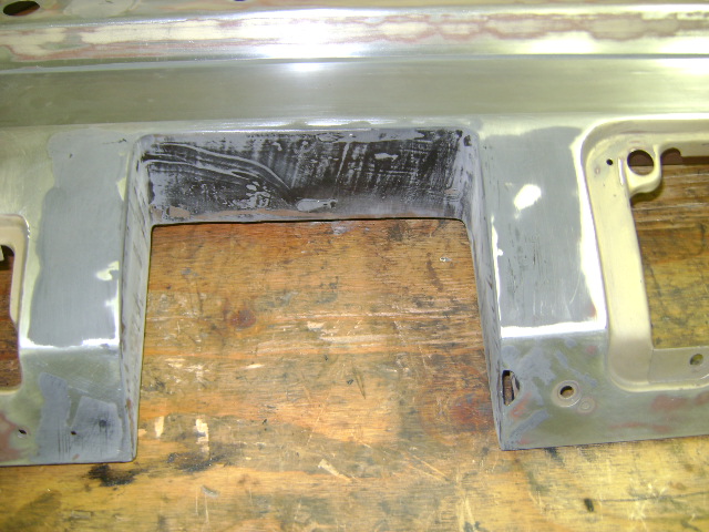

the heater hole that we put in the dash was a littel backyard looking so we made a box to kinda take the [ just cut out look ] out of the dash .
a littel more sanding and all well be well .

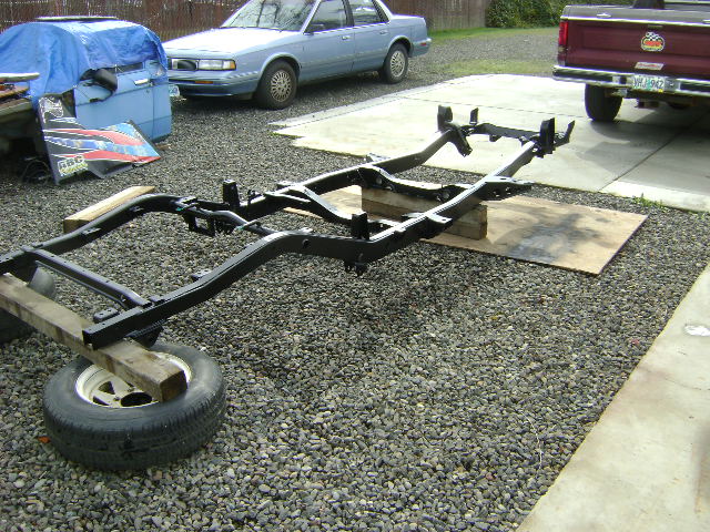

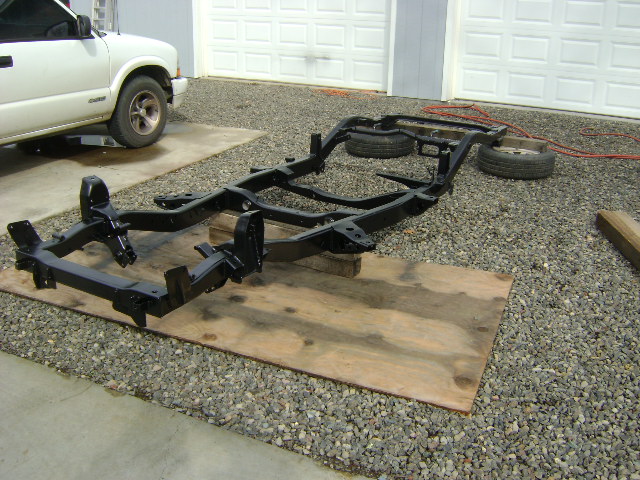

well been over at the coast visting my kids and now back to work on the luv . called the powder coaters and they said thursday or friday the frame well be done . then ill transfer all the susenption on to the frame . the motor well be done soon then i can set it in the frame and then put the cab back on .

yes it well be nice to have it all together . cut the holes for the gauges in the dash insert .

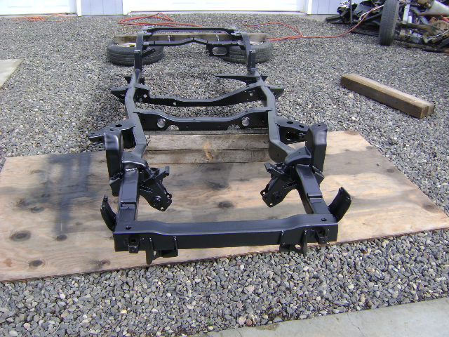

well just got back from the powder coaters and the frame looks great .

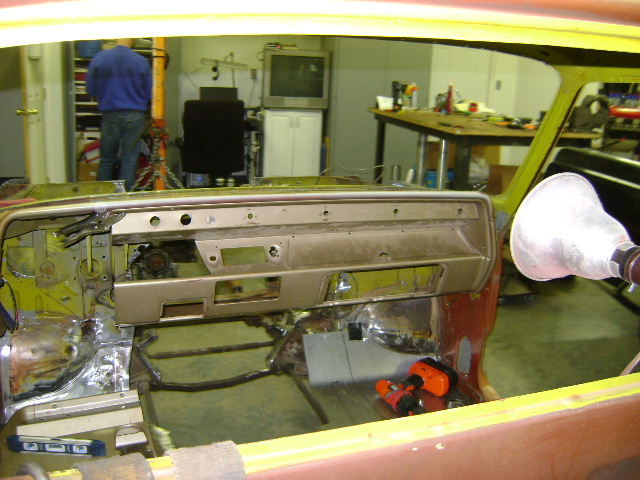

so that year chevelle dash will fit without cutting or is there some fabrication to do? besides of course the heater box hole. Looks very nice my truck looks great except the dang ol' dash haha. My uncle is a chevelle fanatic he would love me to throw a chevelle dash in mine and i like the way it looks and the fact its METAL!
1980 Chevy LUV 4x4 Weberfied Sold
1974 Chevy LUV 4x4 Weberfied
 Post subject: Re: Norms 75 luv build
PostPosted: Sun Mar 13, 2011 1:26 pm
See pics on page 2 :roll:
PostPosted: Sun Mar 13, 2011 2:48 pm
Joined: Mon Jan 17, 2011 6:08 pm
Posts: 152
Location: NorthWest Washington
i saw the pics just wondering if it was cut down i couldnt really tell it was a nicely done job.
PostPosted: Sun Mar 13, 2011 7:43 pm

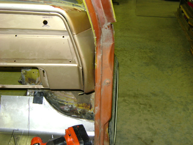

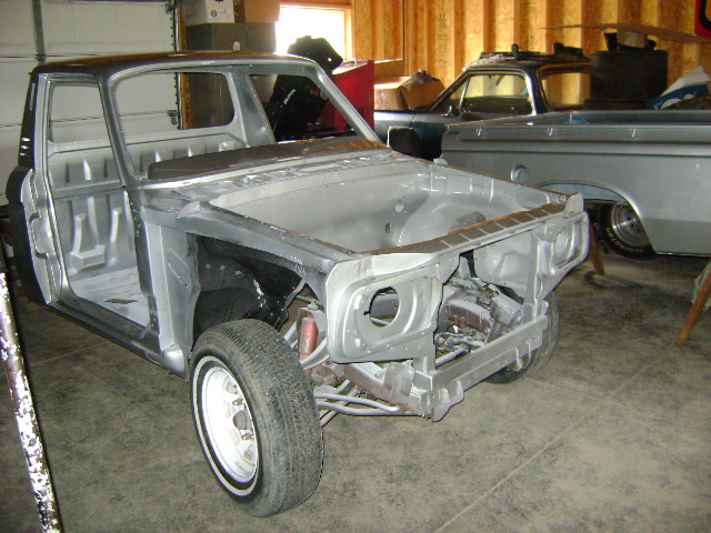

I see a big differnce in these 2 pics he posted (and weld marks)
PostPosted: Sun Mar 13, 2011 11:49 pm
Posts: 158
Location: cental point oregon

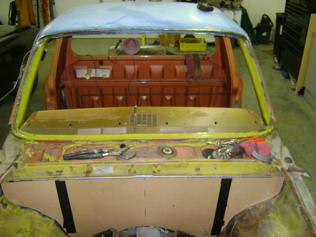

yes theres fab work . I cut the top part of the chevelle dash 3/4 of an inch off the where it meets the windshield . then took 3 7/8 out of the center of the top ,
shaved about 1/2 of an inch off the sides where it meets the a pillers
. the insert we took it out of the insterment cluster .
If i did it again i would take everything out of the center . the heater hole was a after thought and cutting everthing out of the center would fit right into the after thought . all and all it wasnt to hard just take your time have alot of vision and measure measure measure fit fit fit then cut and weld simple ha ha .
