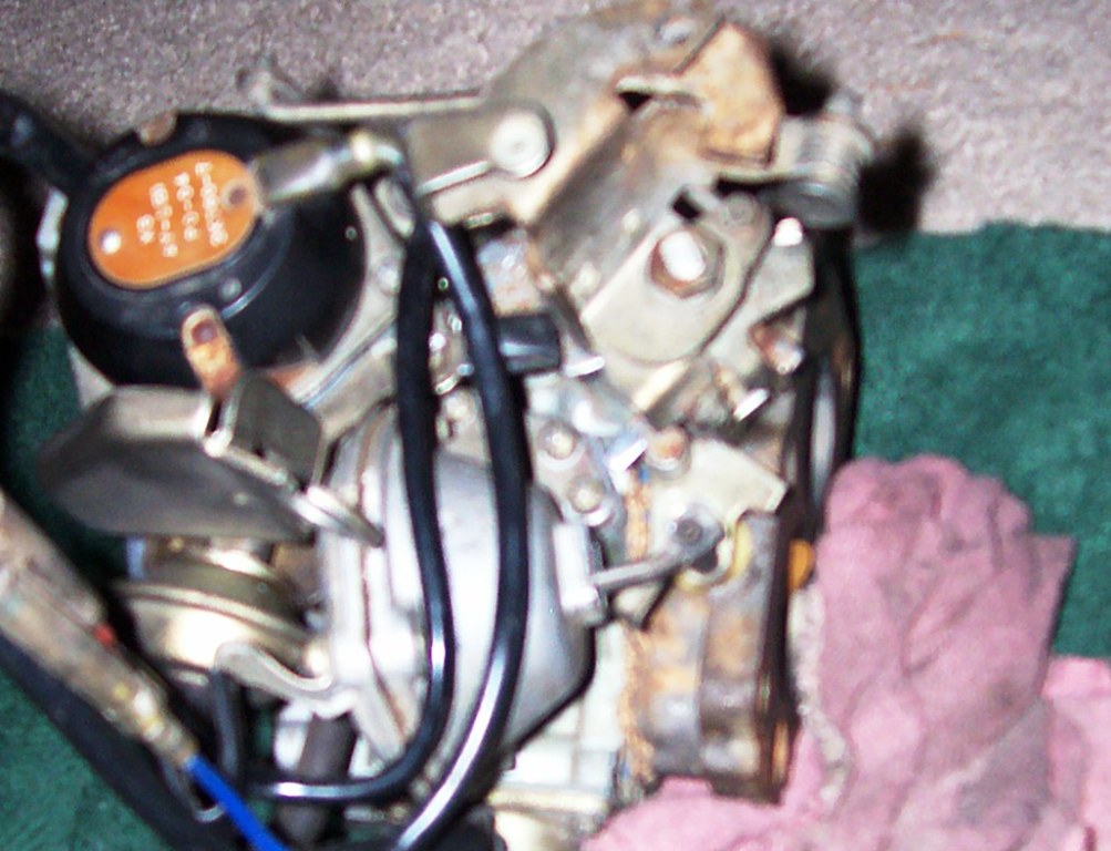

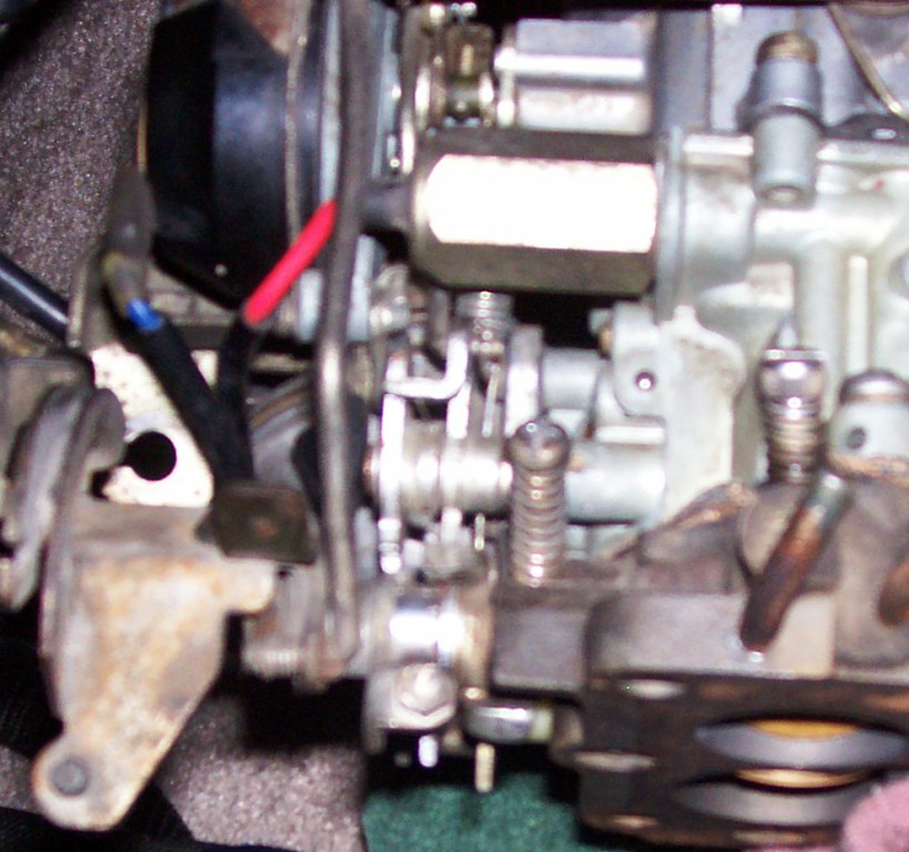

mY stock DCH-340 isn't right after a rebuild. Anybody have the ability to photograph thier (same or simular carb) linkage so I can see where to place the linkage for it all to work? The parts on the mrimary shaft are the problem. Only getting 1/6th throttle movement & sticking in open(full throttle) when opened all the way.

I'm looking for how the parts are placed on the rods for the primary. When the arm from primary hits secondary, it only gives me 1/4 throttle total. I'm stuck? I can't find even a diagram of how it's to look properly put together. No same carb's in the bone yard to look at either. Nor anybody with stock luv's by me in north Seattle.

I did look. I guess they are in place. I think the 1/8" gasket I made for between the throttle & main body may have a partial blockage or some material come off & block something. I'm stuck? After it was rebuilt, it ran for 5 minutes then when someone turned the mix screw all out for awhile...it died and backfired. Maybe got too wet & fouled plugs? Thinking I"m back to square one darnit.
