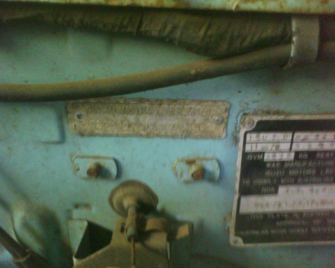

i couldnt find the VIN on the cross member, does anyone have pics of where it is? also i have found what i assume is the VIN on a plate in the engine bay pic attached
the plate reads
GENERAL MOTORS HOLDENS LIMITED
B200091687281
is this my VIN?
alsoin the picture the other plate on the second line stamped 11-79 i assume this means my luv was built in november 1979?

Pull the air vent or as i call it the cowl vent cover (where the wipers come out of) and the VIN will be stamped on top on the left side-- well in the states anyway LOL. yours should be the same. Good day to ya mate
