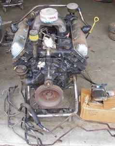

Been looking at this for quite some time now. Anyone out there with experience on the D or DX series blocks? I know they have a robust bottom end and are sometimes used to build stroker SBC's. The Olds diesel has a warped and curious reputation, but I think it would be an interesting swap into a Luv. Considering the astonishing lack of overall power in the C223, as far as swaps go, this seems to make some sort of sense to me. The '79 LF9 engine was rated at 105 HP, nearly twice a stock C223. The 5.7 had weak head bolts which now, after 20 something years, has been addressed. Plus it has mechanical injection, which is SVO friendly, and a relatively simple wiring circuit. Olds 5.7's seem to come up on craigslist for between $50-$200, which is cheap compared to a decent C223. Torque might be an issue, but it seems you could retain the stock rear end. There are guys running 1.8's with 100+ horse, right?
I'd like to hear from you guys that might have experience with this block. I think a TH350/400 will bolt up to this engine as well, so the trans bracket would be more familiar territory. What about the water pump? If the block is the same as a 350, would it interchange with a shorter one?
Image Image
As to the why?!?...I'd like to try to run a truck on veggie oil, and I'd like to try a V8 swap at some point. Seems like if I'm going to actually tackle the project, I might as well build what I want, right?
Like to hear your comments :)
PostPosted: Thu Aug 30, 2007 9:05 am
I don't know of a shorter water pump offhand. And the pump is an olds pump. I don't think sbc stuff will fit it.

olds diesels and all olds blocks having nothing in common with chevy smallblocks.
another thing you might want to address is the weight issue. DXs are heavy suckers.
in my eyes its just not a very cost effective swap for the power your lookin for.
but im never one to turn away a project. i think itd be cool. and if you ever wanted to put like a 455 in the truck when you were tire of the diesel, you could. motor mounts are the same.

The Old's diesels did have issues but they are easy to over come , lets see what you need.
The engine can be installed as some gas one's have been used.
The weight of the motor is about the same as a chevy big block.
Any BOP trans will fit if you have the vac pump and valve on the injector pump for the auto trans (they also use a different governor)but that can be gone around.
You are going to have to change the rear end as you are going to need a gear ratio of at least 3.25 and would be better off with 2.73-3.00 due to the lower RPM,s the diesel run,s at.
Any used motor you will have to rebuild the injectors and the pump as they will be wore out and when worked on they will be upgraded witch will make the motor run better than it did from the factory.
This all adds up to a pretty good expense but if done with the right gearing and tune up you will get some where in the 30-35 mile per gallon range and it will still be spunky when you hit the throttle because of the low weight of the pickup.
There is more info if you decide to go on with this project ,and i think you should as it would be different and cost effective when done.
So a hardy good luck and go on with it and just ask when you need help and you shall receive.
