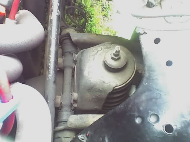

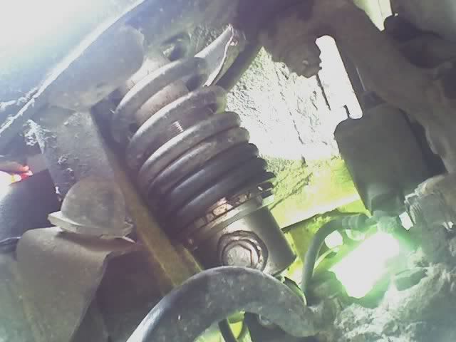

Here is an example of a mount made to use the existing shock pocket on one of the old dirt trucks We ran.

Yeah, if I was buying new, that's the route I'd go. The pics show a set that are "preowned" dirt track shocks that were $50 bucks for the pair. I've had taller "preowned" shocks, and cut the factory mount and made some mounts to fit.
A set of double adjustable HAL's are pretty sweet though. I think the springs on this set up is 200 lbs due to the engine, cab setback. Not positive as this one was built so long ago...
