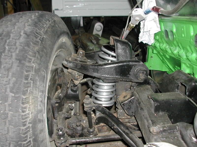

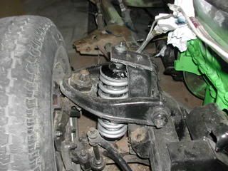

Here is what I come up with, HAve it bolted on for a trial fit. Seems to be OK. Will weld a piece on and trim it and round the edges smooth.
Wonder what thickness I should use. 1/4 or 5/16 or 3/8
Guess the only thing is I will have to take off the upper control arm to replace the shock and spring. Not sure how else how toget it back on whe the mount is permanent

I noticed when the upper control arm comes up it actually shortens the distance between the inner ball joint and frame. The control arm will actually contanct the coil as it goes up but has a 1 inch gap when in the actual mid travel if that makes sense. I found I have to check the clearance in 3 different spots. Extended, mid travel and compressed.
I went ahead and cut out a portion of the shock tower so I can move the top in some. If I use the stud mount I will weld a piece of 1/2 plate to the tower and it will be approximately 1-1 1/2 inches further out than the original hole.

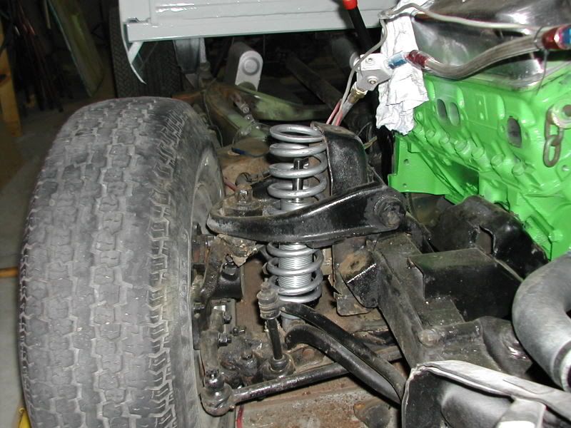

I decided to keep my stud conversion. I found today All I have to do is cut out the entire top hole out of the mount and weld in a new piece of 5/16 in it's place right on top the same width. Just move the hole over about 1 inch instead of like the pic I posted earlier with the piece sticking way out.
I cutout more of the inside pocket and it let me move the coil overs toward the inside more and the shock set right with no bend in it.

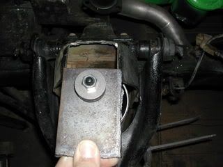

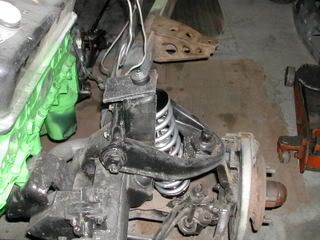

Will get some pics of my mount tonight. Looking at your 4x4 pic I 'm not sure but the way i redid my top mount I think the stud conversion on my coil overs might work. The bottom mount stays the same and I think the angle will also stay the same,
I cut the lower plate off were the lower bump stop mou nts so it would clear the coils. I also cut out the thin outsisde steel inside the pocket because it would rub the springs. I have the plate to weld on the top of the mount in place of the upper part i cut out as shown in the pic. I drilled a new hole approximately 1 inch further out on top to aloow for the coil clearance on top. All I need todo is weld on the plate, trim it and paint. I used 5/16 plate. The stud conversion goes in. Set the shock and coil in first and then top coil holder and then screw on the stud mount.
If ya need any help just give me a holler and I will run over or you come over and look at mine.
The pic with my thumb is were I flipped the plate around to show what I cut off the top of the mount

What I did was cut almost up 4 inches or more on the thin outside layer on the pocket. Cut throught the entire bottom. I bent the lower bump stop holder compleletely down. Will cut it off when I get the chance, I took a bar and hammered the the entire outside metal flat against the frame or you could cut along the top and too and just take it out.
be carefull and not get into the inside portion that is bolted to the frame or part of the mount.
if i can i can get a pic tonight since I have my coils off and the upper Arms off to put in new ball joints.
Your coils might rub a bit when putting them in but everything clears fine when together and setting on the ground.
