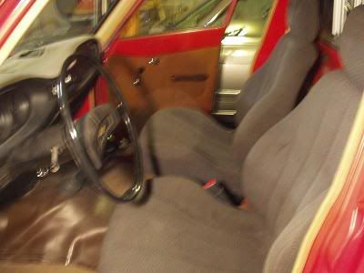

i got some acura integra seats oh man they are comfy and the fit LIKE A GLOVE. i only had to drill 4 new holes for them to fit. it took about 45 min to install them.
kevin
PostPosted: Mon Nov 01, 2004 12:53 am
Posts: 2361
Location: Eagle Point, OR
Those seats look comfy :D

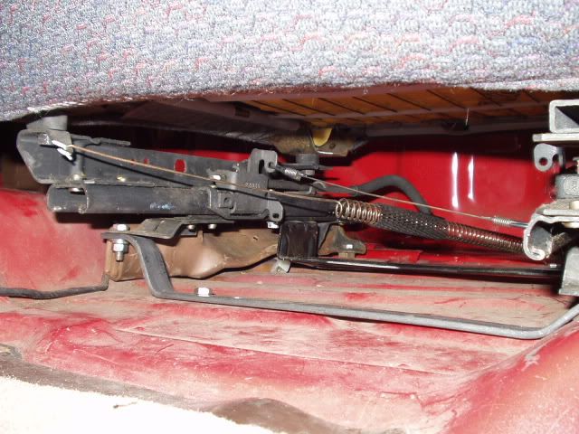

i finally got ONE of the seats in today, after about five hours of hammering, drilling, bending and swearing. so, for anyone who is interested, yes, -Pontiac Sunfire- seats DO fit in a Luv. it isnt a direct fit however. i had to drill 4 holes in the bed for the mounts, and then fabricate two 1'' by 18'' adapter plates. in order for the front seat to sit properly, the seat carriage must be mounted BACKWARDS. if you want these seats in, dont plan on fitting anyone in over 6 feet tall. they dont allow you much clearence. so im not sure how much work any of the other seats would require to put in, but to put in both buckets count on an entire days worth of work, and your going to need some scrap steel and some bolts to get them in, also alot of washers or spacers. they sit at a close height to stock though, and are pretty comfortable. its probably less work if you didnt have a bench seat like me.
heres a pic of the bottom of the seat, you can see one of the brackets we fabricated.
PostPosted: Sun Nov 07, 2004 12:35 am
we dont want a botom pic we want a top pic
