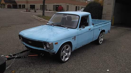

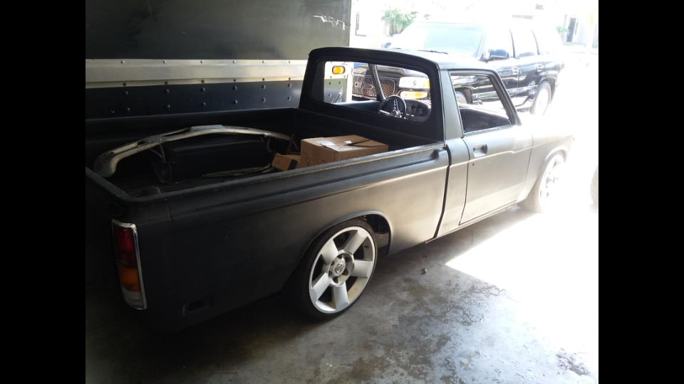

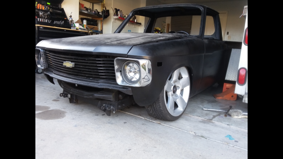

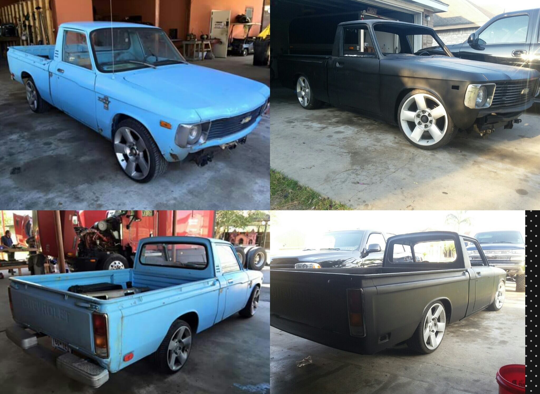

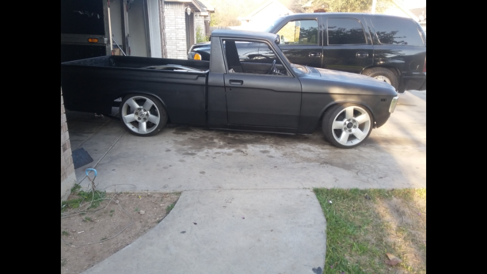

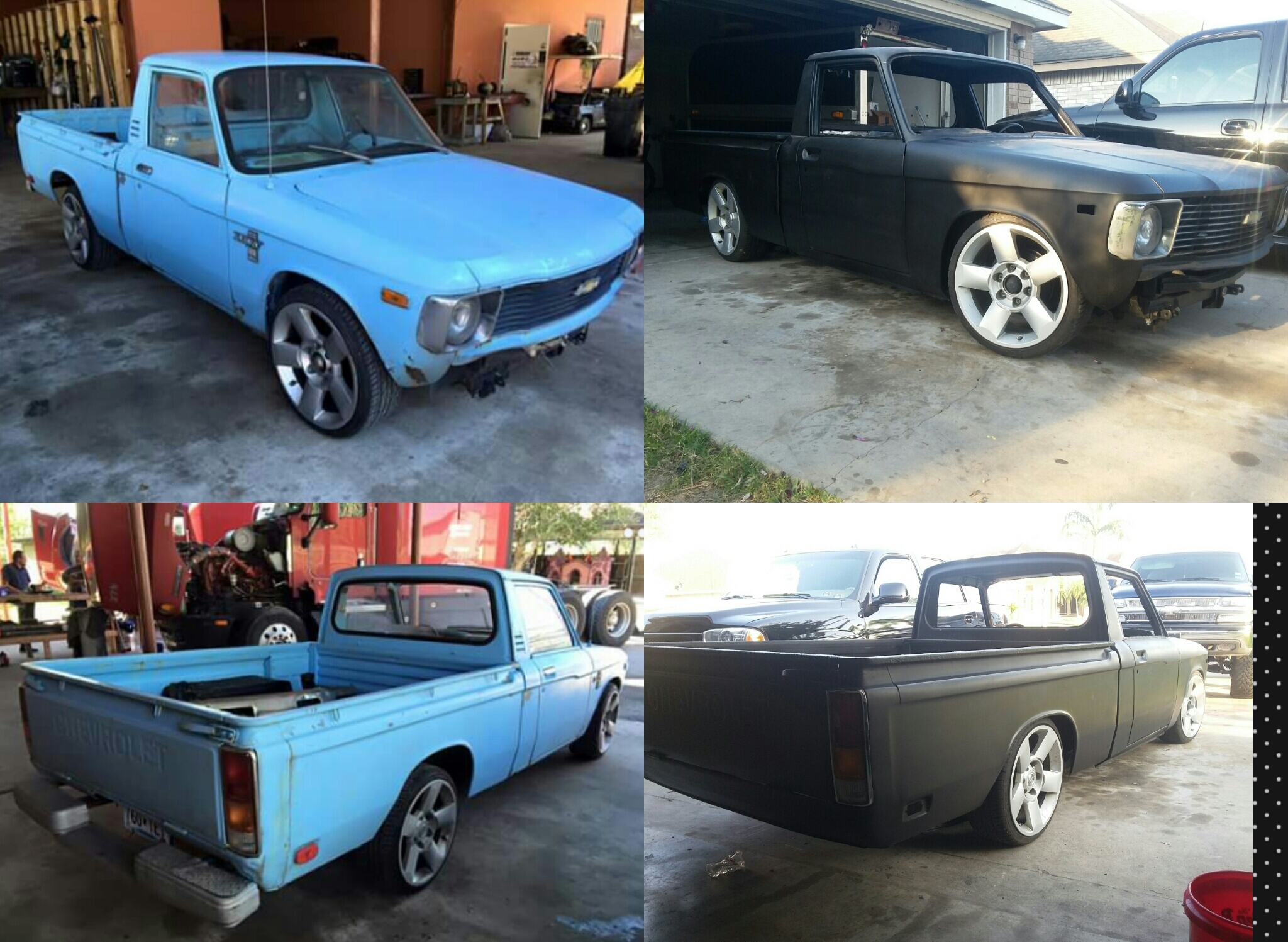

I just gonna post pictures of my project. Any questions feel free to ask.
My luv project
https://youtu.be/wd5eCjrNL6U

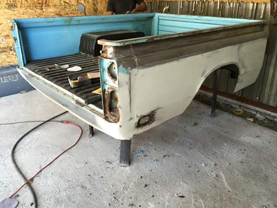

File comment: Rollpan

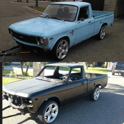

My luv project

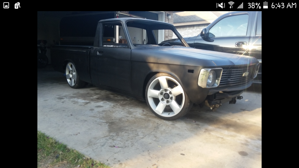

My luv project

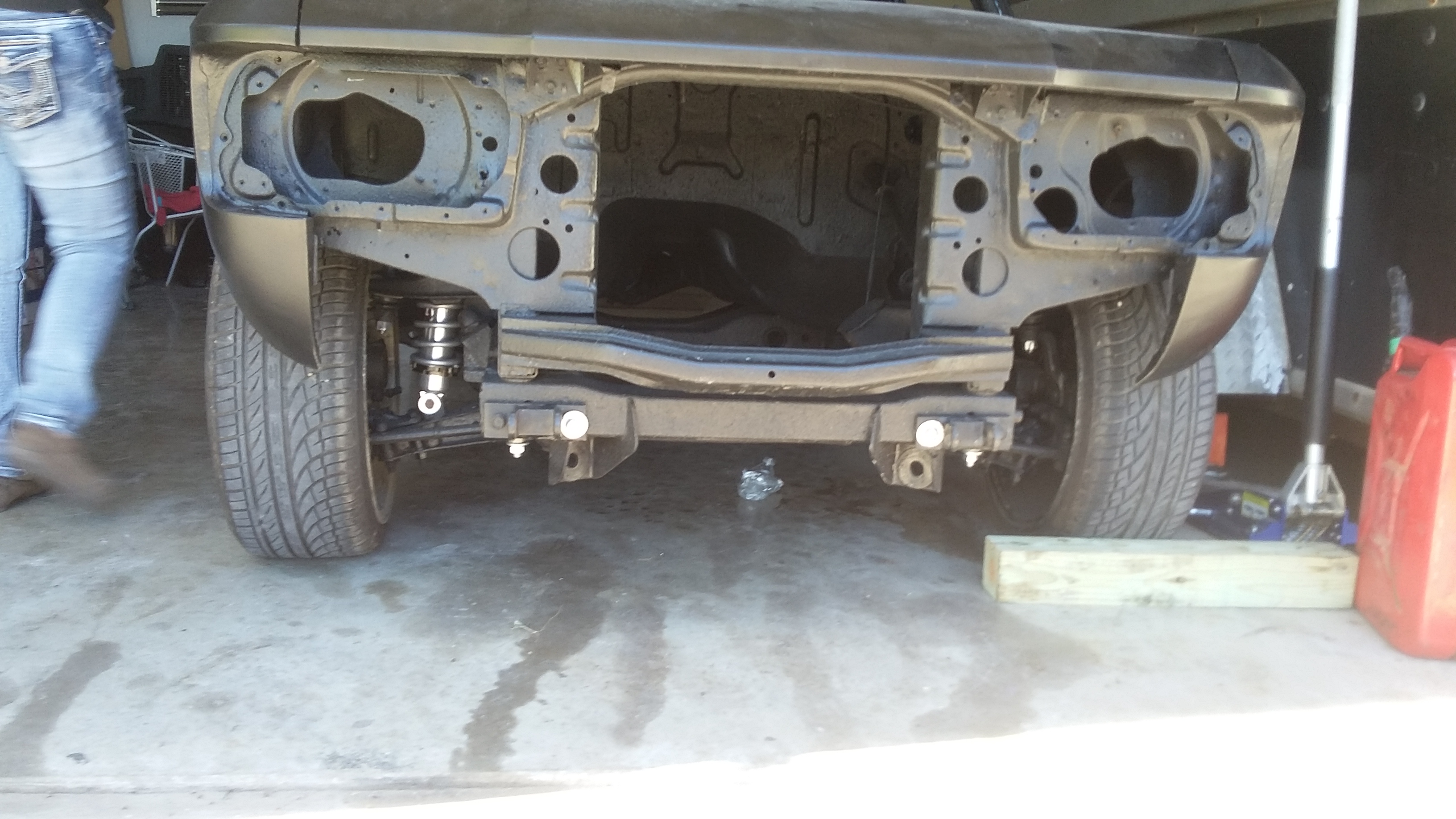

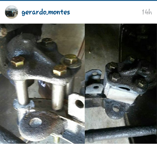

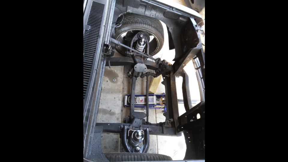

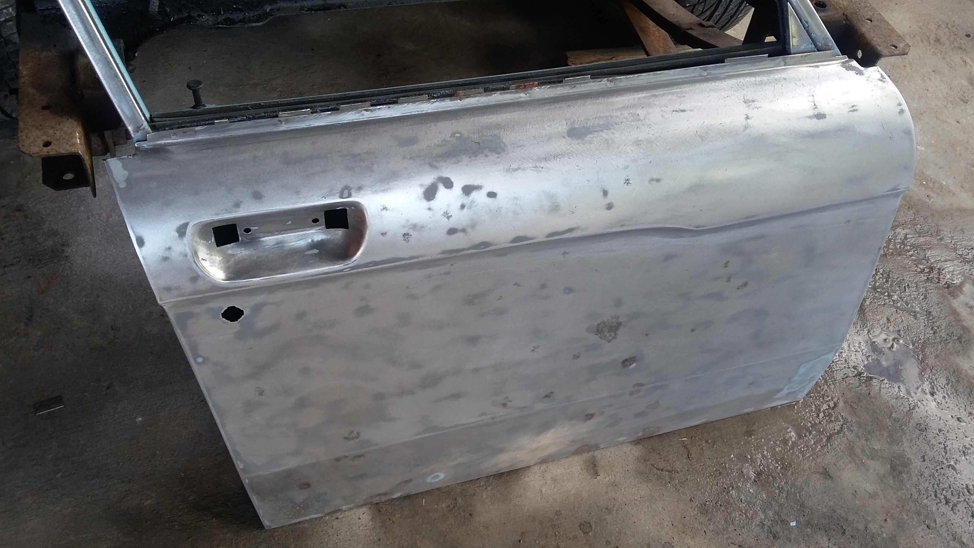

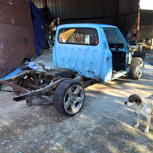

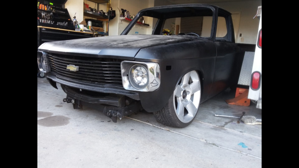

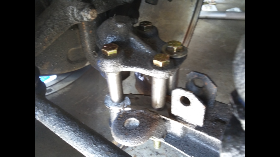

montesgerar wrote:
You did a lot of work with the body. Looks great.
Did you put a spacer under the ball joint (not sure if the pictures are displaying in the quote, but it has the name of the picture at least)?
PostPosted: Tue Mar 01, 2016 3:30 pm
Posts: 83
Location: Minnesota
Zane wrote:

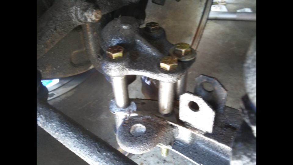

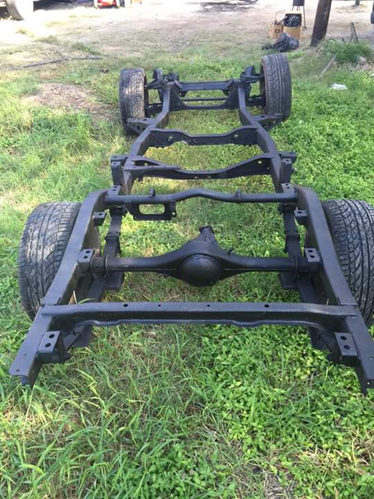

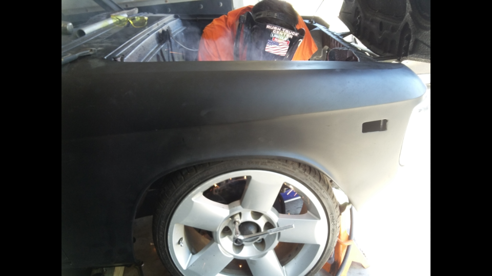

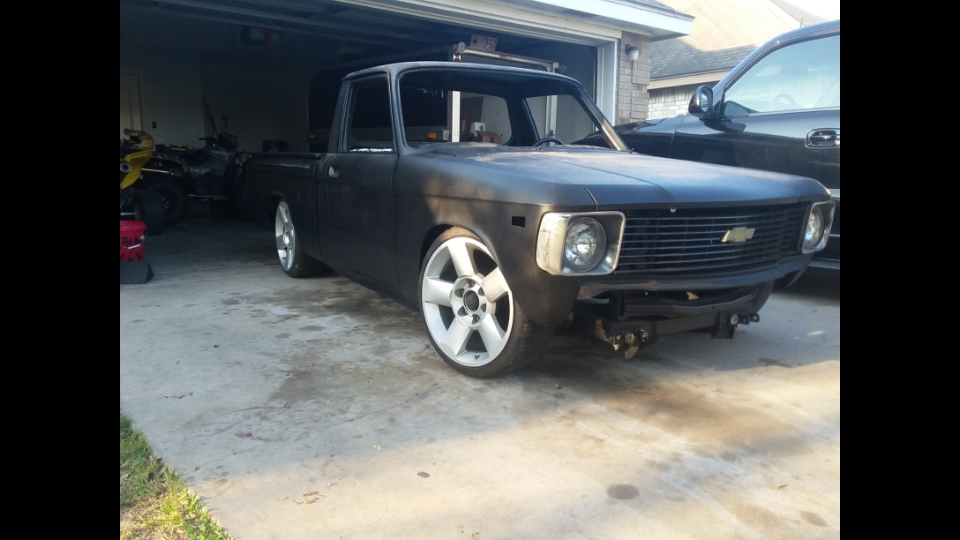

yeah we took all the truck apart and we sandblasted all parts and chassis.

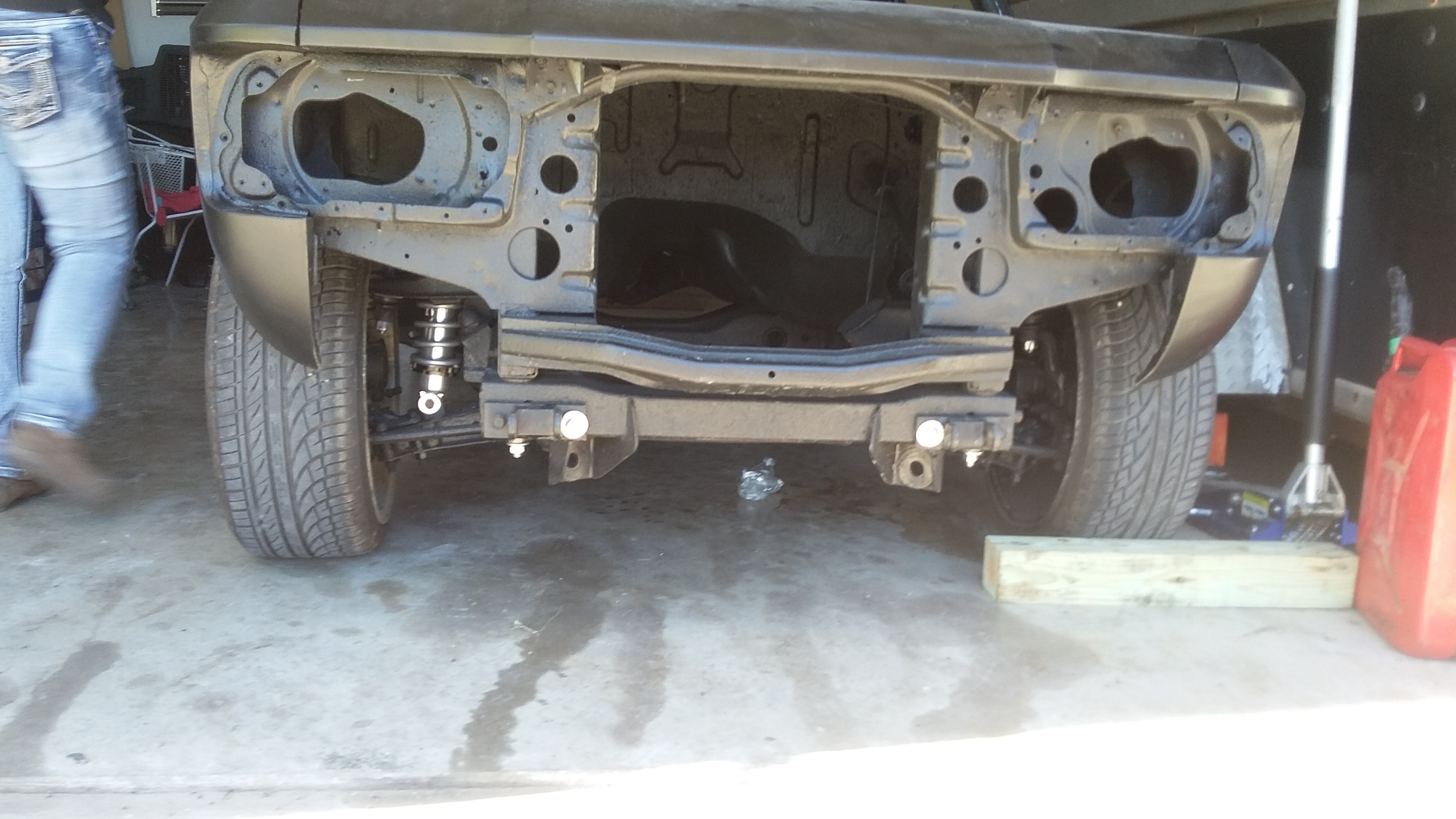

yes those are the lower balljoint spacers. i made them with steel tubes (2") and 5/16 steel plates. its very solid and strong, looks like it works pretty good. also i made some cuts (and welded after) on the upper arm to get a better balljoint angle. bump stop is removed. i currently making some brackets for the coilovers.

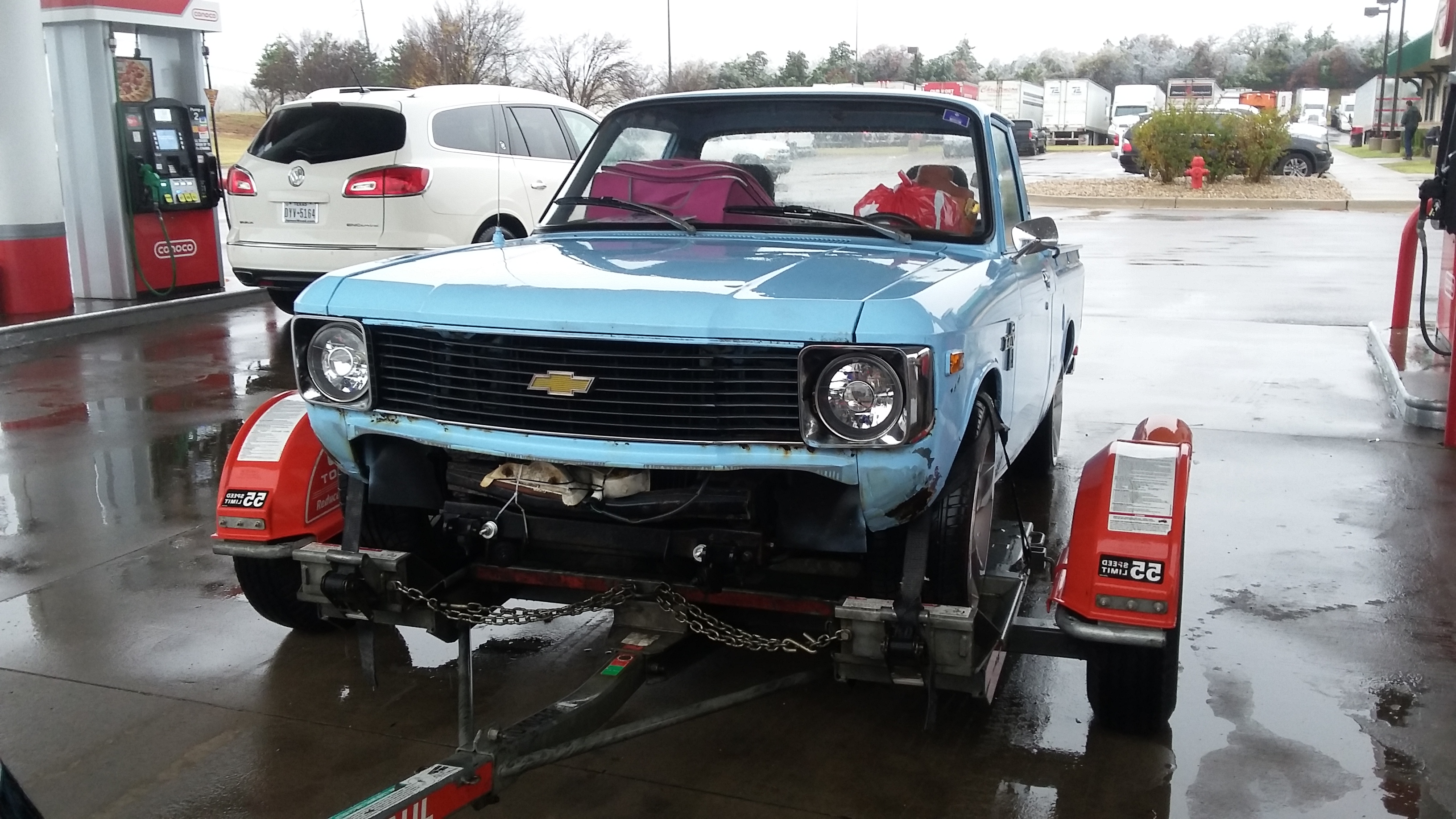

Luv was towed from Mcallen texas to Minnesota 1500 miles lol

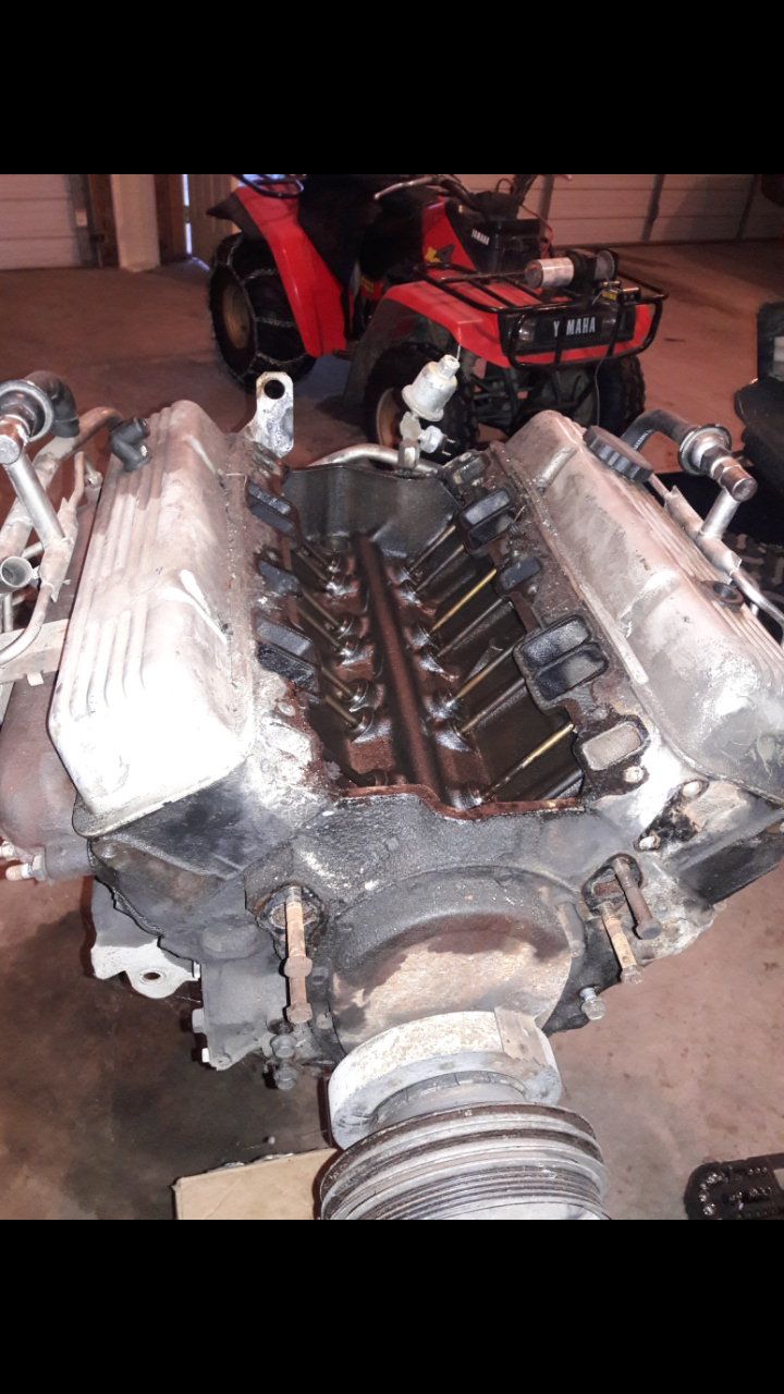

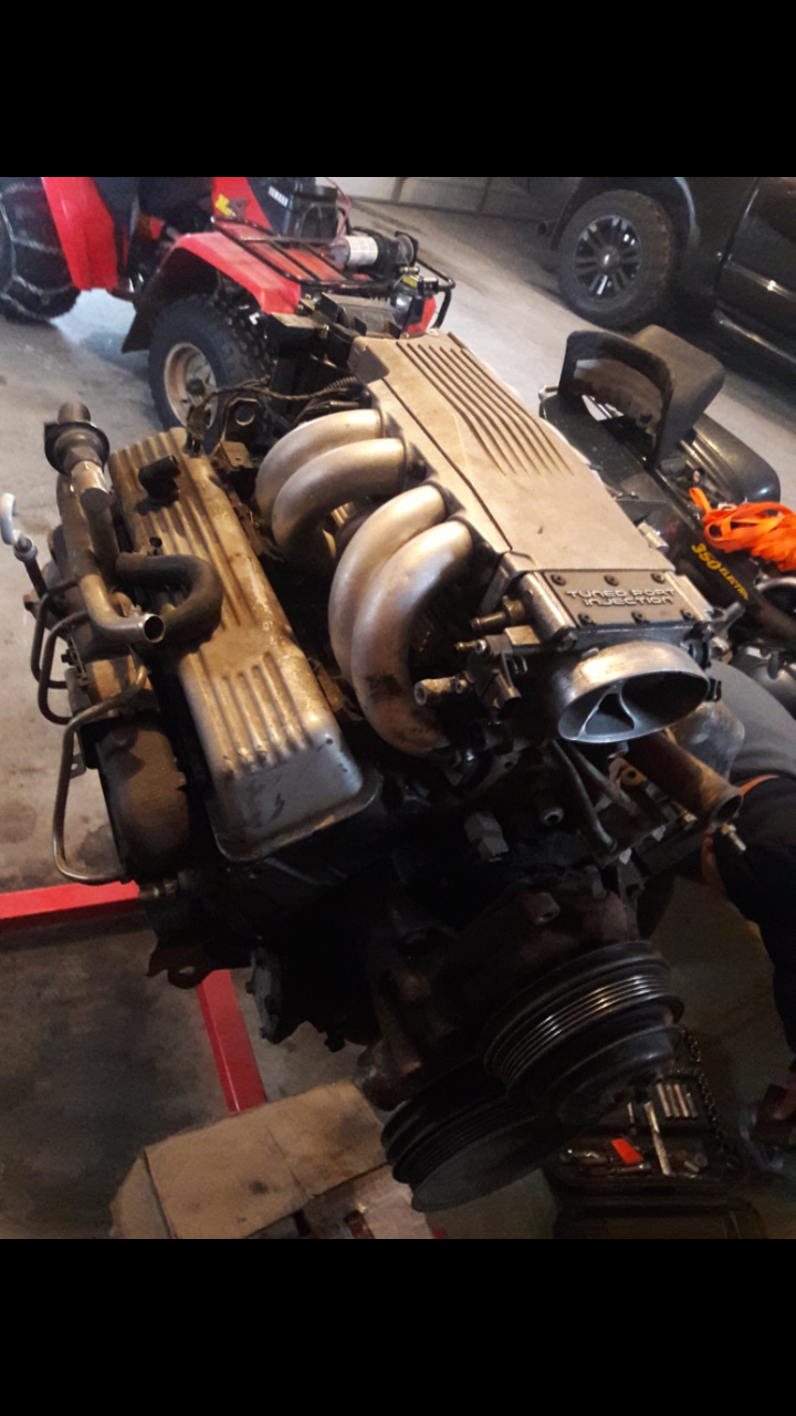

Time to finally work on the motor. I ordered a swap kit from powerbyace.com 1987 camaro 350 tpi engine and th350 transmission, stock TC.

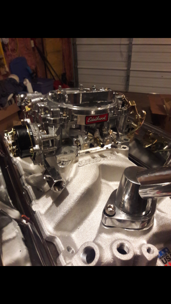

I ordered an edelbrock intake manifod (2701 i think) edelbrock carb 600cfm, mechanical.pump, Short water pump, SWP one grove pulleys, SWP.alternator bracket, chrome alternator, tall valve cover. Etc
