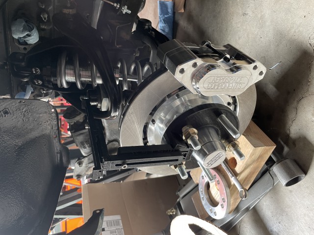

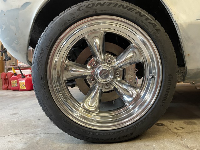

I went with the American Racing Torq-Thrust II wheels for the front on my Aerospace kit.
They are aluminum, Polished, 17 x 7 in., 5 x 4.75 in. Bolt Circle, 4 in. Backspace. (Summit Part Number: ARE-VN5157761)
I used the Mr. Lugnut (Summit PN: MLN-HR83-6710-4) hub centric rings. They did need a little bit of light sanding to massage them onto the snout of the hubs. Really only to deal with the machining tolerance of the snout of the hub.
I designed a 3D printed tool to help with my selection since I removed the torsion bars and welded in coilovers.
And the Continental ExtremeContact Sport, 215/45-17, W Speed, Blackwall DWS 06 PLUS - SIZE tires. (TireRack PN: 215/45ZR17)
The truck is still under construction so can't comment on how well the tires perform.
