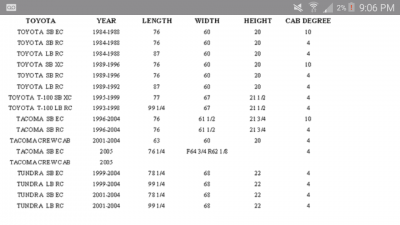

Did yours maybe come from a T100? Those are 77 x 67
I'm seeing 76x61.5 for the Tacoma regular and extended cab I believe these measurements are the topper size so worth may be over bed size slightly, not sure

On the chart that last column is the degree of the slant at the front of the cab. 2,4 and 10 degrees. That is the issue with fitting a Luv. Mazda seem to be straight at the front. Also for hard bed covers I was told a Nissan Frontier fits a Luv.

Yeah i was looking at the slant angles whichever company makes those toppers wouldn't work but I have seen a couple that don't match the cab curve. I will have to do some measuring and comparing at picknpull and see what I find . Would be easier than making my own at least.

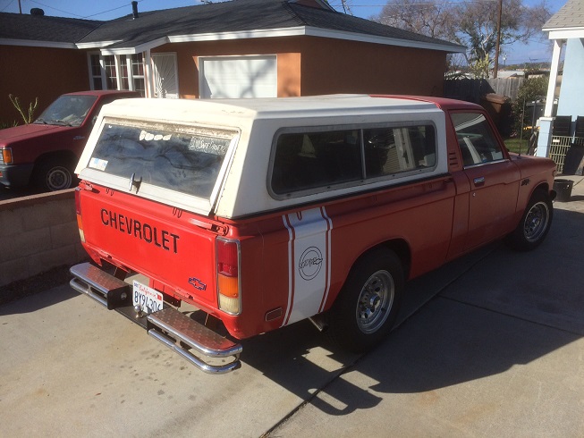

It only took 4 years to find it but I finally did. This is a real old school shell that came off a 72 Luv that has been sitting since 1986. It's a little dirty but in good shape otherwise. 8)
Just set in place for now. I need to change out the handle with a new one. Its rusted in place.
