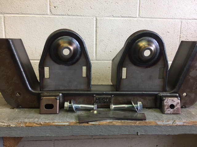

Hello I'm working on gathering parts to build my 78 LUV and have a line on getting a new Heidts universal Mustang ll crossmember kit (cross member and 2 two spring supports) for a $150, good deal?

Check this off the parts to acquire list, Mustang ll crossmember kit, $150
