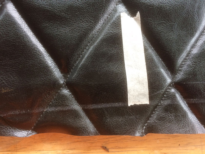

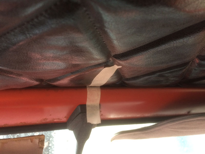

So its just hanging there I took pieces of masking tape and taped reference points for front back and sides. then took a light crayon and traced the edge of the opening where the vinyl is tucked in. All the way around and make sure you can see it.

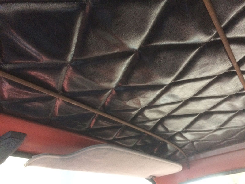

Now that tape for alignment comes in. I started with the sides and then went front to back. The adhesive is repositionable for a short time. I thought it went in easier than expected.

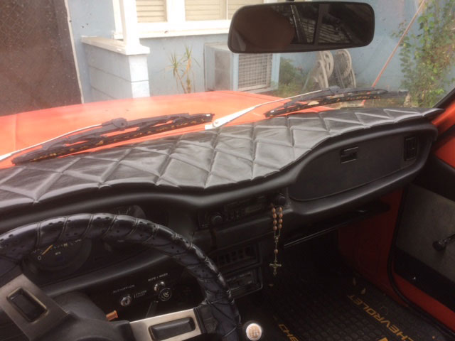

Here is a test fit for the dash cover. I used the adhesive to fold the edges over. I have it under a stack of truckin magazines drying right now.

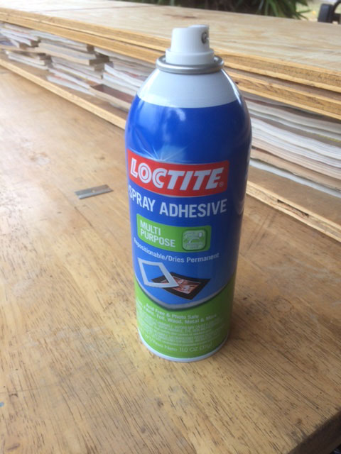

Ok, it looks like the Loctite glue I used was not strong enough to hold the fabric up to the metal roof. So I am going to retry gluing it with some 3M professional grade fabric adhesive. I will update this when I get that done. We had some upper 80's last week and it was sagging when I got in last Saturday. The glue is still tacky but not holding it in place. :roll:

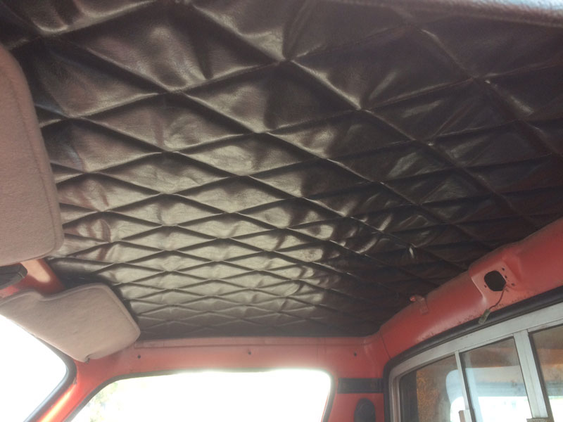

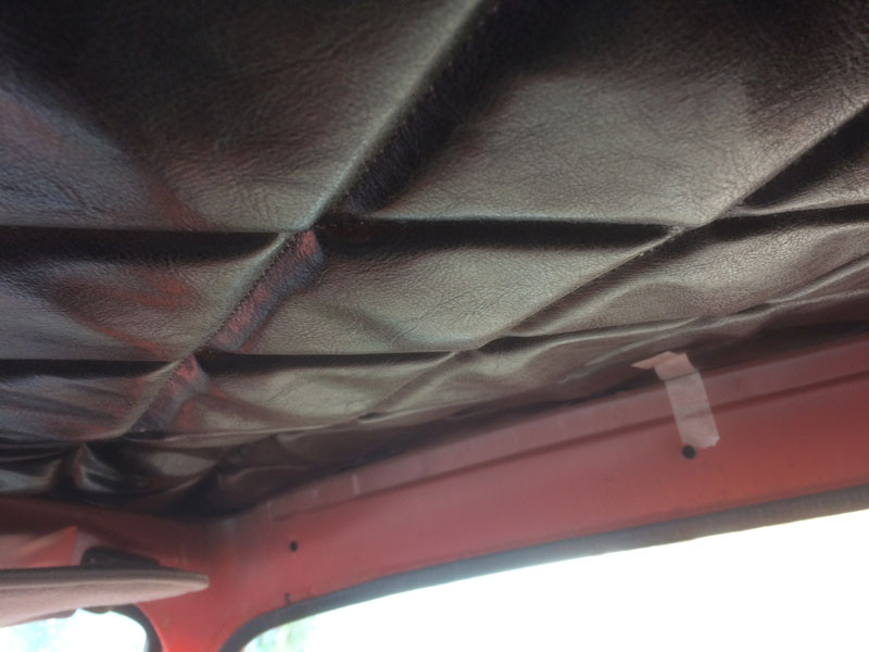

PostPosted: Mon Feb 13, 2017 3:31 pm
I got the headliner glued in again and it is holding well now. I wound up using 3M super 77 and so far it is working well. I also used some cardboard along with the original headliner bows to hold it up for the first 24 hours. It has been a couple weeks and it's sticking good. The original glue I used is more for crafts not upholstery.
