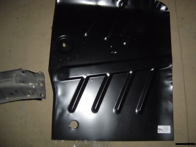

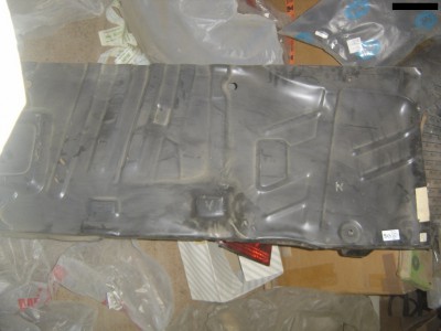

i got floor pans for my rebuilt

Gasto, so what did you have done there? Did you have an existing pan and it was fabbed up from that? Or do you just want to sell those to me? Lol Any info on what you did is appreciated. I haven't seen the car yet and have registration issues to deal with bringing an out of state car in. A wobbly cab isn't helping any.
PostPosted: Mon Jul 10, 2017 2:38 pm
Posts: 66
Just found them here in Greece from old stock.Also found the rocker panels and a front bumper.
