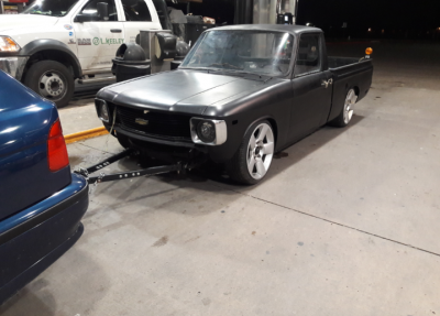

Hey this is my 80 luv lowered on 5 inch rear blocks and custom modded upper arms, torsion bars deleted, lower balljoint spacers. Rear monroe arimax shocks ma824

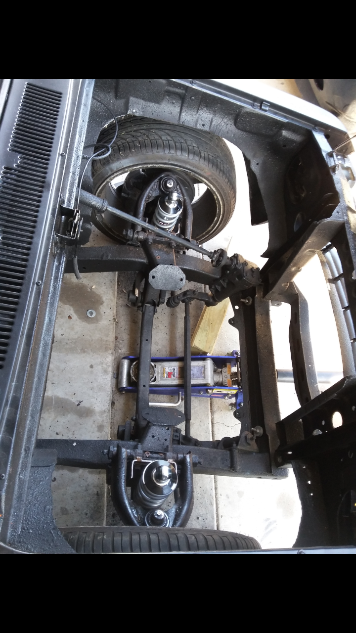

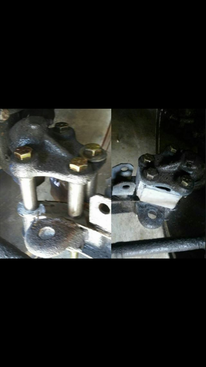

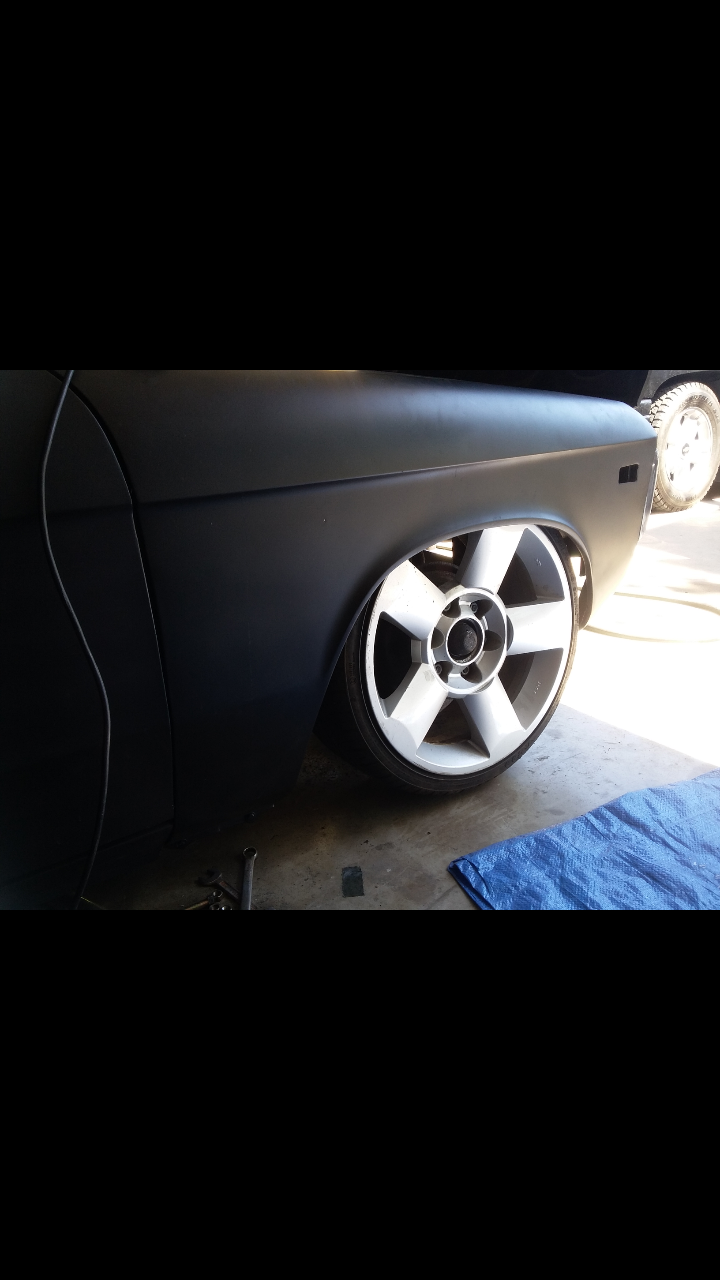

Nice looking ride. Any pics of the front suspension mods?
 Post subject: Re: Flat black Luv!
PostPosted: Wed Mar 29, 2017 5:57 am
Posts: 83
Location: Minnesota
I have upper arms modified, cut and weld.for.a better balljoint angle. 1.5 imch spacers for the lower balljoint

That's a nice looking lowered truck. What is the size of your wheels/tires?
