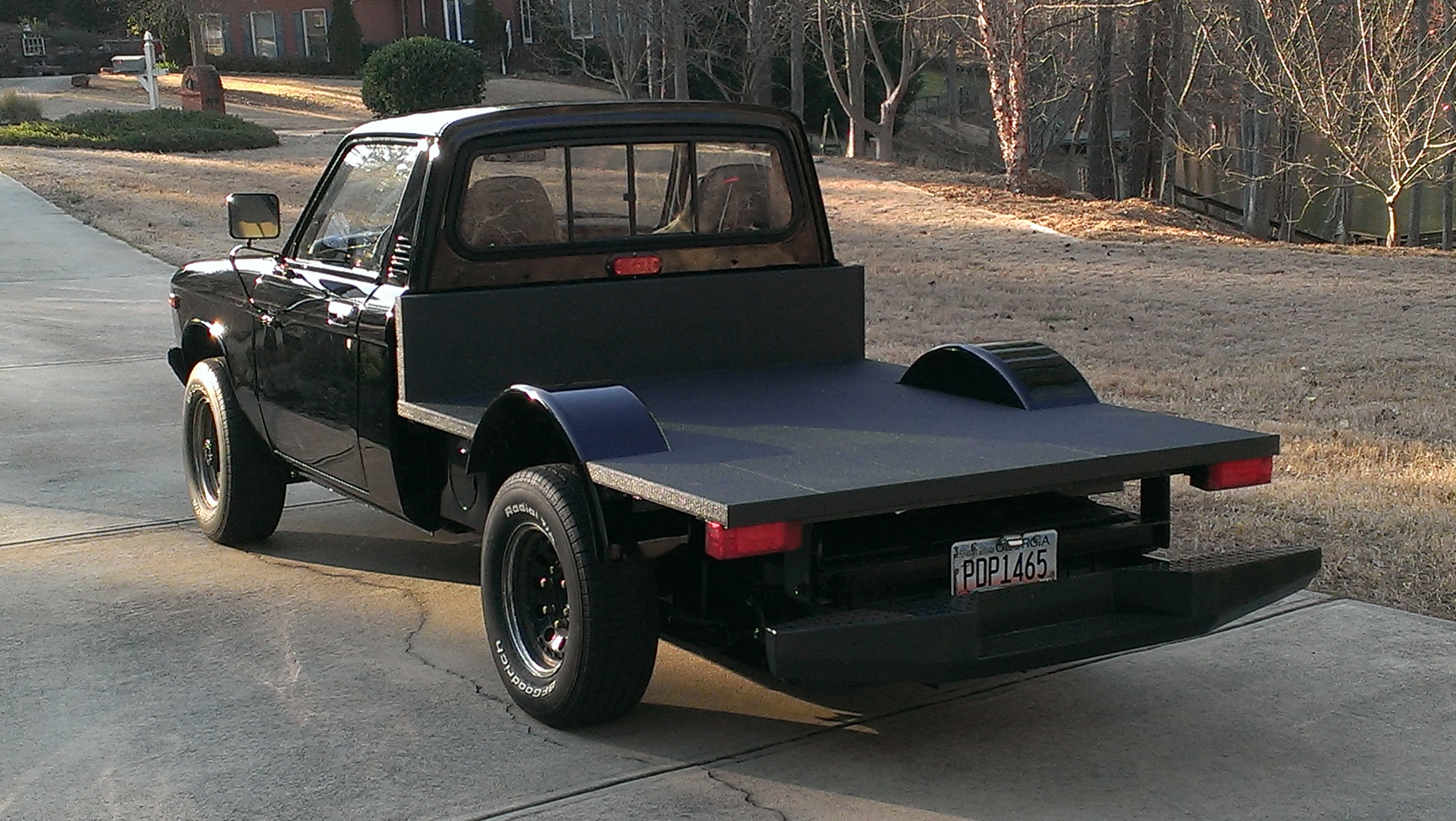

I replaced the bed on mine with aluminum.
Saved a lot of weight since the aluminum bed only weighs @110 pounds.
I bought a used set of bleachers and bolted the benches together to make a flat bed.
Added aluminum angles cross wise for support and made a hinge from some 3/16" plate welded to an angle and bolted to the bottom of the bed.
Had the AutoTech guys shoot it with bed liner and the flatbed LUV looks great.

Your bed is nice! Although I would only have one on my daily driver luv...prolly not my street/strip truck. Good craftsmanship though. :smt023
