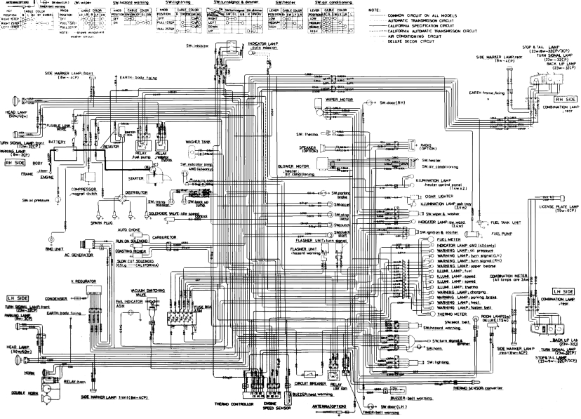

I've posted the wiring schematics for a 1980.
It's not very clear in some places but this is the best diagram I've found.
Hope it helps.

Thanks for the info and the wiring diagram.
