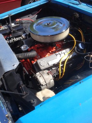

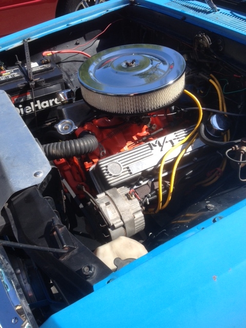

PostPosted: Fri Sep 26, 2014 8:49 am
Mine is also under the hood in the stock tray but it has an stronger strap holding it in place than the stock bracket.
