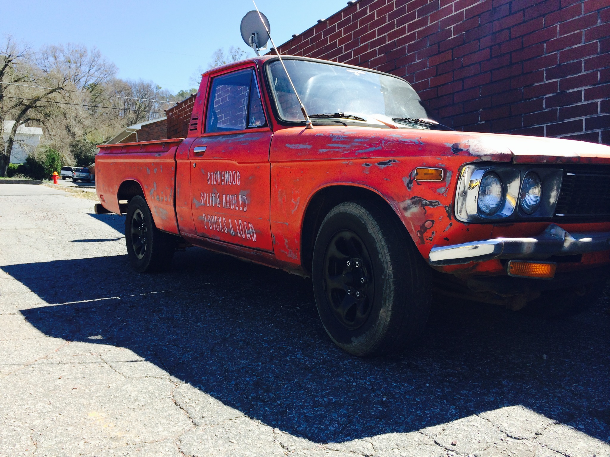

Looking to lower my 75 Luv. Would I just use drop blocks in the back and adjust the torsion bars in the front?

Yes.
PostPosted: Sun Mar 16, 2014 5:19 pm
Blocks in rear reindex torsion bars instead of just cranking them down
