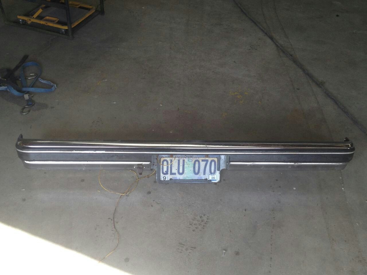

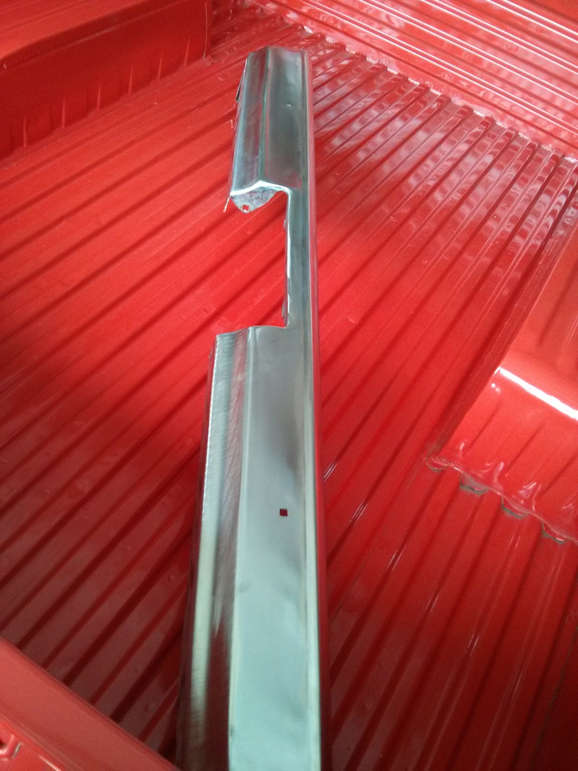

So, I gave up on trying to find a smooth rear bumper for sale and decided to make one. Essentially, the idea followed an article I found online on Sport Truck Magazine's website: http://www.sporttruck.com/techarticles/0811st_1989_chevy_s10_rear_bumper_conversion/. They used a 1st generation s10 rear bumper as a foundation, took off the plastic impact strip, cut and welded steel plugs into the holes left from the mounting points for the impact strip, and re-chromed. Anyway, the link to their article is there.
The only difference with the Luv, is that it's a couple inches narrower than a 1st gen S-10. So, we had to take 2" of width out my the bumper and license plate bracket. This was taken out of the middle of both the bumper and the license plate bracket. The bumper mounting brackets from the S-10 were reused with some small modifications.
At this point, the bumper as you see it is ready for chrome. Depending on their schedule, hopefully I'll have this back and on the truck in a month or so. I'll post more pics then.
