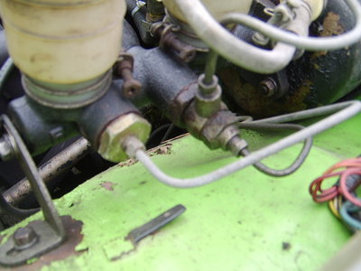

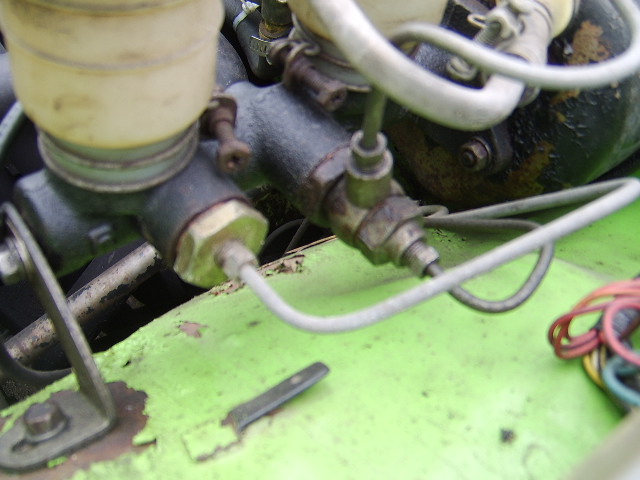

 Post subject: Re: I need help (brakes)
PostPosted: Sun May 12, 2013 5:03 pm
Posts: 590
Location: Spokane,Wa.
Yep,looks like the set-up on my 76 with automatic tranny......

Yea that's it... Do I need a prop valve? Is that setup made for 4 wheel drum ?
PostPosted: Sun May 12, 2013 6:09 pm
Here is a 78 set up.
PostPosted: Sun May 12, 2013 6:13 pm
Ok, I will start over. If it does not have an exteral proportioning valve, the master will either be sized for the different volume, or it will have one internal. So, if you have discs/drums factory, you either need to remove the valve, if it is external, or get a different master cylinder that does not have one...
