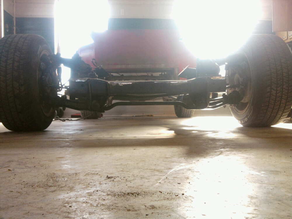

4x4 to 2x4 soaking the splines on the torsion bar ajusters to get the height way down and still have some spring to it,

I pulled all the 4x4 components off my luv to go 2wd with a 4.3. Around page 15
viewtopic.php?f=33&t=22916&start=300
Its fairly straight forward but dropping the axle out is a headache
Make sure to seal off the back side of the hub to keep water and dirt out
