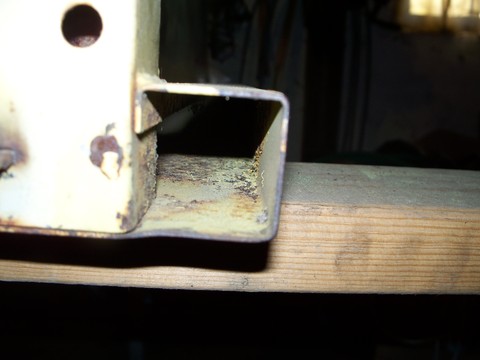

File comment: how should i tackle the rust in here?? (cheaply but permenently)

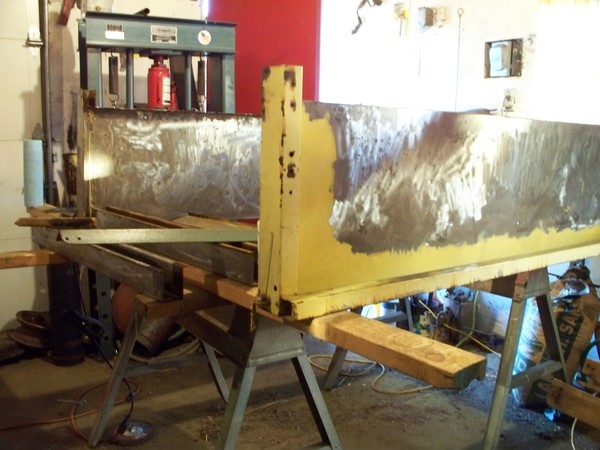

File comment: still strippin for paint

as you can see from the photos im taking the bed down to bare metal, i kept finding little pockets of rust that hadnt broken through yet so i wanted to "clean house" the cab is a different story im going to start sanding that down today or tomorrow but it doesnt need to be taken down to metal. Should i buy two different primers? (metal etch for the bed and a normal filler primer for the cab)?
also my tailgate and the cross sections of the bed are soaking in a molasses bath, i'll tell ya how that one goes after a few weeks haha
Cars have no class anymore. so take em to school

I would also suggest to make sure that everything is absolutely CLEAN! Nothing worse than having to re-shoot paint when there is fisheyes or trash in the paint. I painted at Daktronics for 4 years. Have everything clean and tacked before you paint.Use compressed air(that has been through a line dryer/water separator) to blow any solvent out of cracks then tack. I would also say to make sure to use the appropriate type of reducer with your paint and add hardener(if required). I would use an acid etching primer then a filling primer. Then block sand any high spots ,use body filler then prime again. If you look at your public library you should be able to search for how to books on body work and paint.Make sure that you don't use too fine of sandpaper...you can actually make the pores of the metal close if you sand it with too fine of a paper!

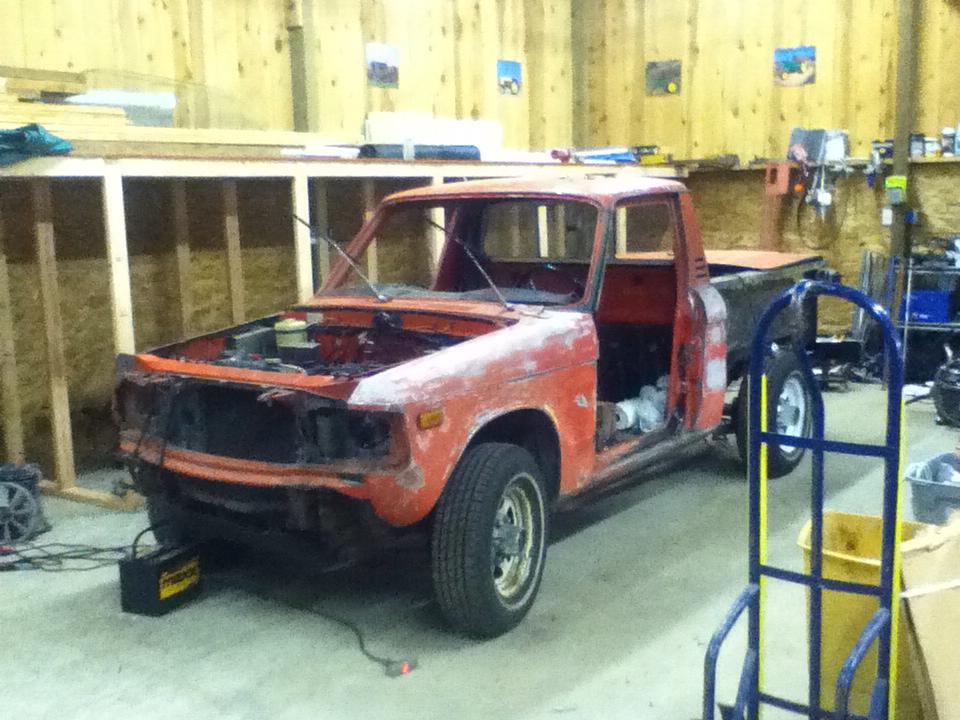

Thanks for all the advice guys! I did my reading and everything, I'll shoot the first layer of primer in 2 weeks or so. Heres a picture of my progress for ya
