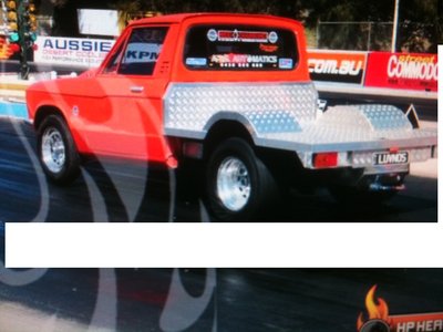

Hi i have been to the strip after the changes to the suspension and it seemed to run straight and hook up real good. First run 11.20 at 122mph just useing the foot brake to 3200rpm. It did a 1.51 60ft and just got the wheels off the ground. Then i tried the transbrake for the first time. Stalled to 4800 and bang. It hooked up so hard it flattened the diff pads and rolled the 9" upwards untill the uni's binded and broke the yoke and pinion straight off the diff centre. It was lucky that my tail shaft loop held as it bent the tail shaft and wrecked the loop. Back to the drawing board. I have since fixed the problem i hope and will be out in a week or 2.
