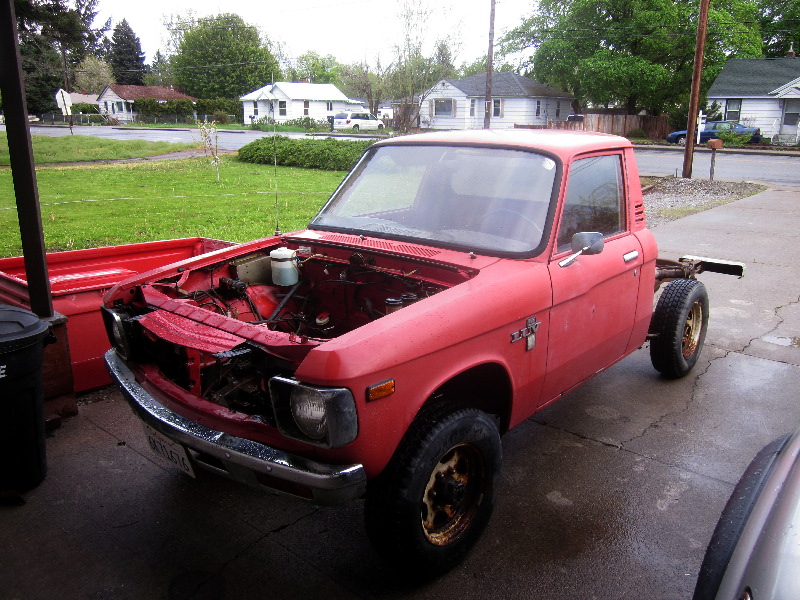

I am going to blast and paint my frame under the bed, it's got a nice even patina of dry California rust (just a light rusty surface scuz, no rotten areas what so ever), if I were still in California it would probably be fine forever as is but now that I'm in a wetter environment I want to seal everything up to prevent future rust issues.
I removed the bed with no issues, I will be sand blasting all of the rust off and will paint it with a good rust proofing primer and finishing it off with a good quality black paint, of course I'll be pulling the fuel tank for a clean out and replacing all of the rubber lines and wear parts visible after paint.
I don't really want to pull the cab but probably should so I can hit all of the frame, Can anyone detail the steps involved? The engine and trans are already out as well as the seat and floor mat.
Thanks!

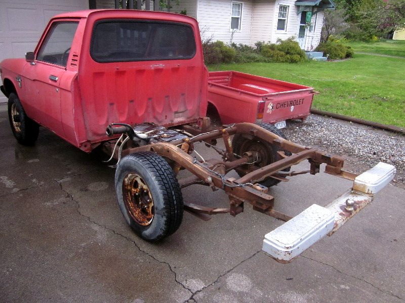

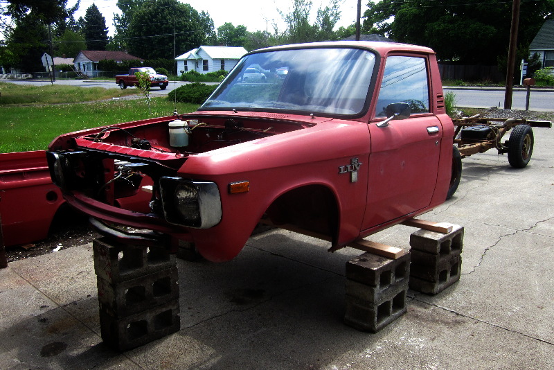

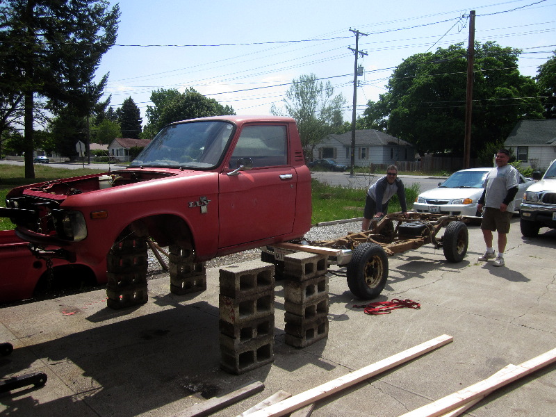

Well got it off without too many hang ups. Here's the short list of what I did:
*Remove front marker lamps from bumpers
*Disconnected the brake lines at the junction block and each wheel
*Disconnected all fuel hoses
*Release all of wire harnesses from the bendable tabs on the frame
*Removed all (6) cab to frame mounting bolts
*Disconnected the steering column from the box
*Run a strap under the front frame cross over (the one under the radiator) and lift it with an engine hoist
*Place cinder blocks stacked on each side in the rear with the holes facing the inside of the truck
*Use a floor jack with a wide soft wood pad on the lift point, slide it under the truck from the rear and lift cab slightly
*After the cab was up a foot or so I slid a 2 x 4 through the lower holes in the cinder blocks accorss the underside of the cab to give the cab a resting point while I repositioned the jack for a higher lift and repeated with a 2 x 4 in a higher hole in the blocks. I repeated this several times in order to get the cab high enough to allow for the rolling chassis to be pulled out from under it.
*After rolling the chassis clear I reversed the jacking process to lower the cab close to the ground for better stability while I clean up the frame.

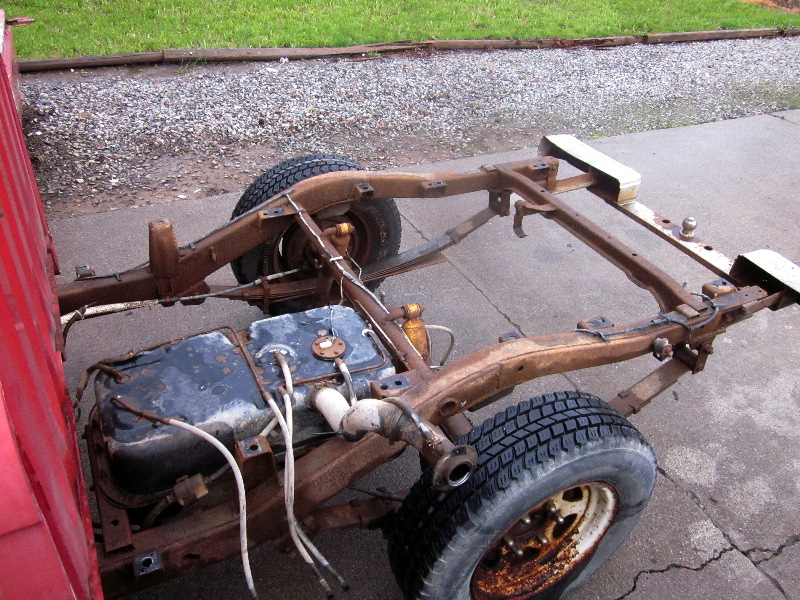

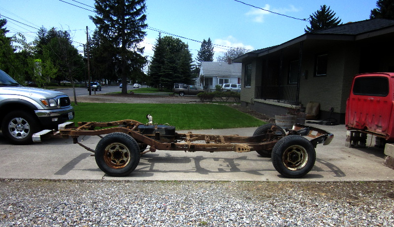

Here is the chassis

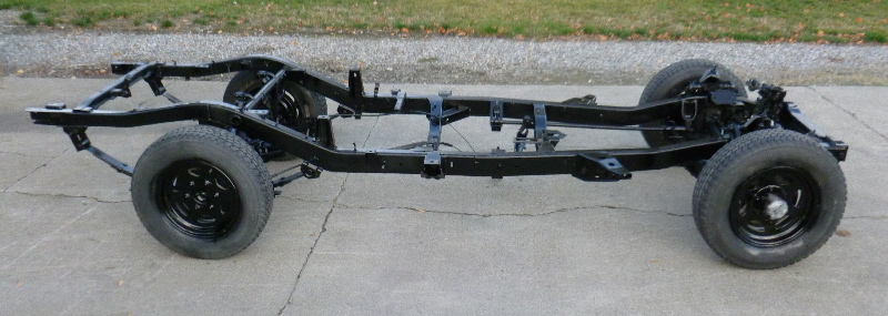

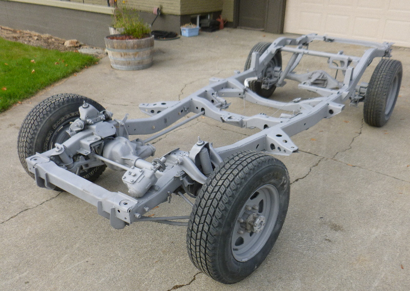

Well it's been a while since I've had some other distractions, back on track now! I finished sand blasting the chassis to rid it of any and all surface rust then painted everything with "Neverrust" (basically a rust prohibiting black paint) then topped it off with another coat of black enamel. I think it came out looking great! I am now pulling off suspension parts and rebuilding/detailing them as I go, when that's done I'll be mocking up the rebuilt engine and Trooper 5 Speed trans for the new cross member fabrication project.

Wheels will be painted the original white after I get the tire pulled off, black is just a rust proof primer.
