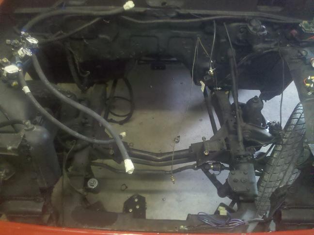

PostPosted: Tue Jan 25, 2011 3:37 pm
Joined: Thu Jan 20, 2011 10:03 am
Posts: 16
1981 LUV!
http://i1029.photobucket.com/albums/y35 ... 1295547781
PostPosted: Tue Jan 25, 2011 5:06 pm
Joined: Wed Jan 19, 2011 3:02 pm
Posts: 14
yea that looks like more crap then mine had. im not sure you could try to find really short headers.They have some that are as big as stock manifolds and then you can just run more exhaust pipe.On mine the ones i had fit right in there it was a little bit of a tight fit but i put them on the first time with the motor in there.

PostPosted: Fri Feb 11, 2011 1:58 am
Posts: 335
Making the the motor mounts on a 81-82 is one of the easier mounts to make, basically they are the same as the S-10 kit. All you need is two pieces of 3" plate cut it into two pieces about 8" long, weld these to the old mount surfaces then add two ears to attach to sbc stock mounts. If you would like some pictres of mine, PM me. The engine compartment is entirely different from earlier models! As far as headers, if you find some to fit pls let me know about them, I'm currently using stock sbc ex manifolds.
