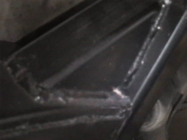

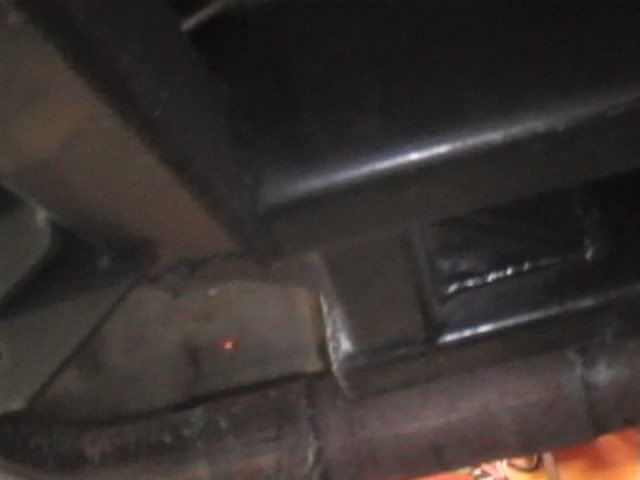

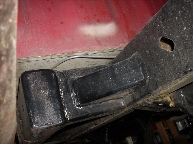

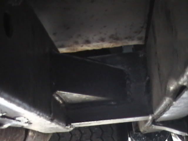

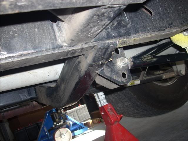

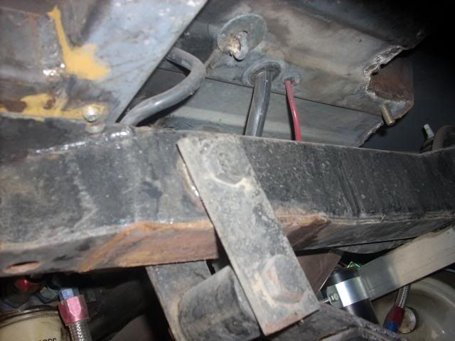

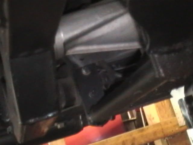

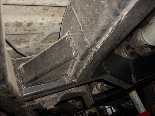

Just for your info i used another set of frame rails from a parts truck to narrow my truck. Sorry i don't have pic's of the complete frame but i do have some from underneath that could give you an idea keeping in mind that it was built for heavy street use but can be lightened for racing(maybe 20-25 lbs).
 Post subject: Re: back half my 72
PostPosted: Wed May 05, 2010 11:59 am
This is just so you can get an idea for your project.

JFYI on my truck i did it for the street with no cage but once a cage is installed the inner frame rails can be removed to save weight. I did it this way to stop twist and it worked.
