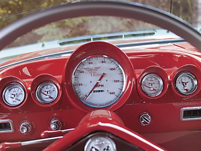

i have one of two ideas on how to "pretty up" my entire dashboard.
one idea is to find a dash cap, and install it over the dash and either fiberglass the front of the dash or sand and paint it and go with a bare metal type of look.
the other idea i have is to find a donor dash from a 60 to 66 C10 chevy and cut it down to size, and use that as a basis for a custom dash with custom gauges (or the like after using the stock luv guages) like this one Image
what do you guys think?

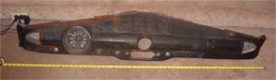

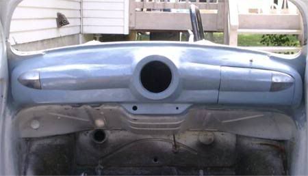

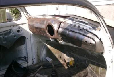

I have thought about a different dash. I know a guy that cut down a 40 something Ford dash and put it in his VW. I think he cut it in about 4 places and welded it back together... It looked great. It is in a Volksrod.
Not sure what to use, but I thought I would like to use this at one time. 59/60 Chev Dash

Here are a couple pictures of Nick's dash
That was a early thing Nick did on his car. So it can be done.
