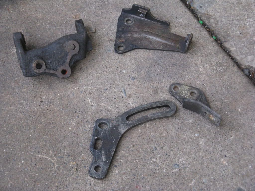

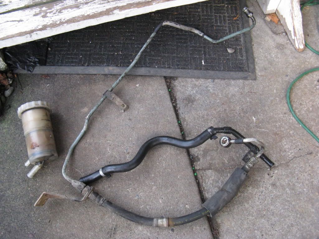

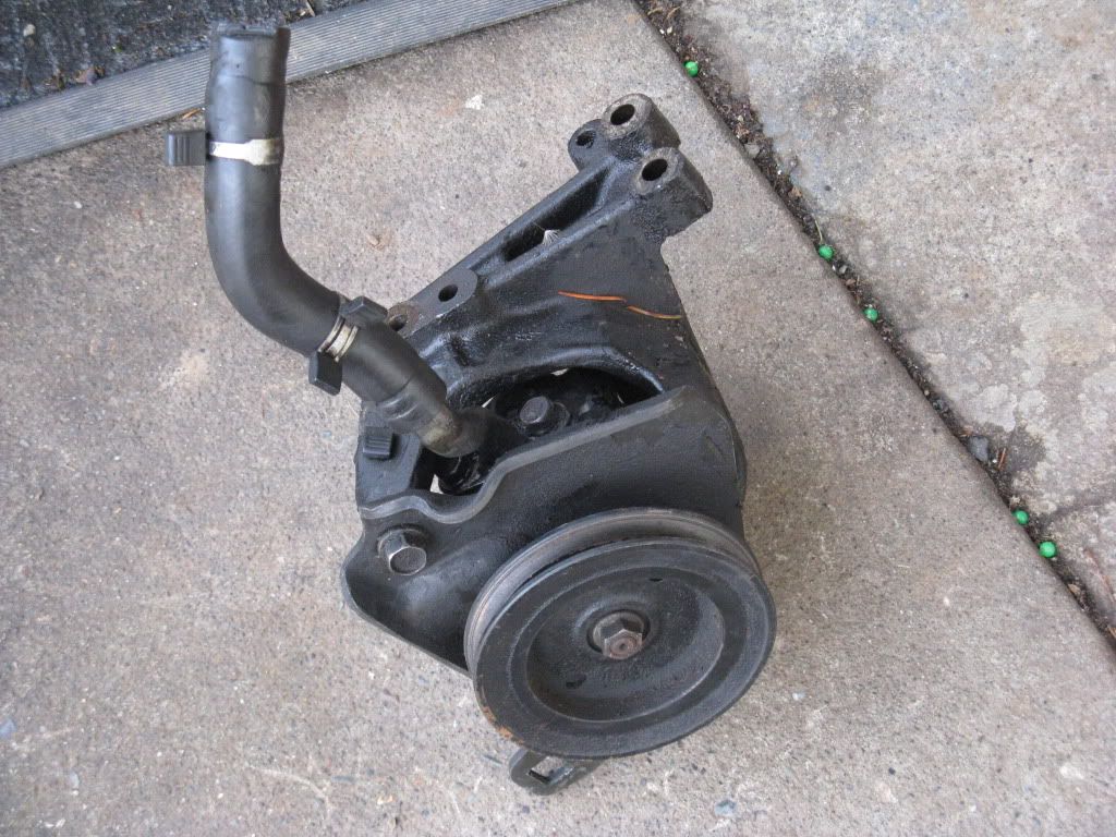

here are the pics of the power steering assembly

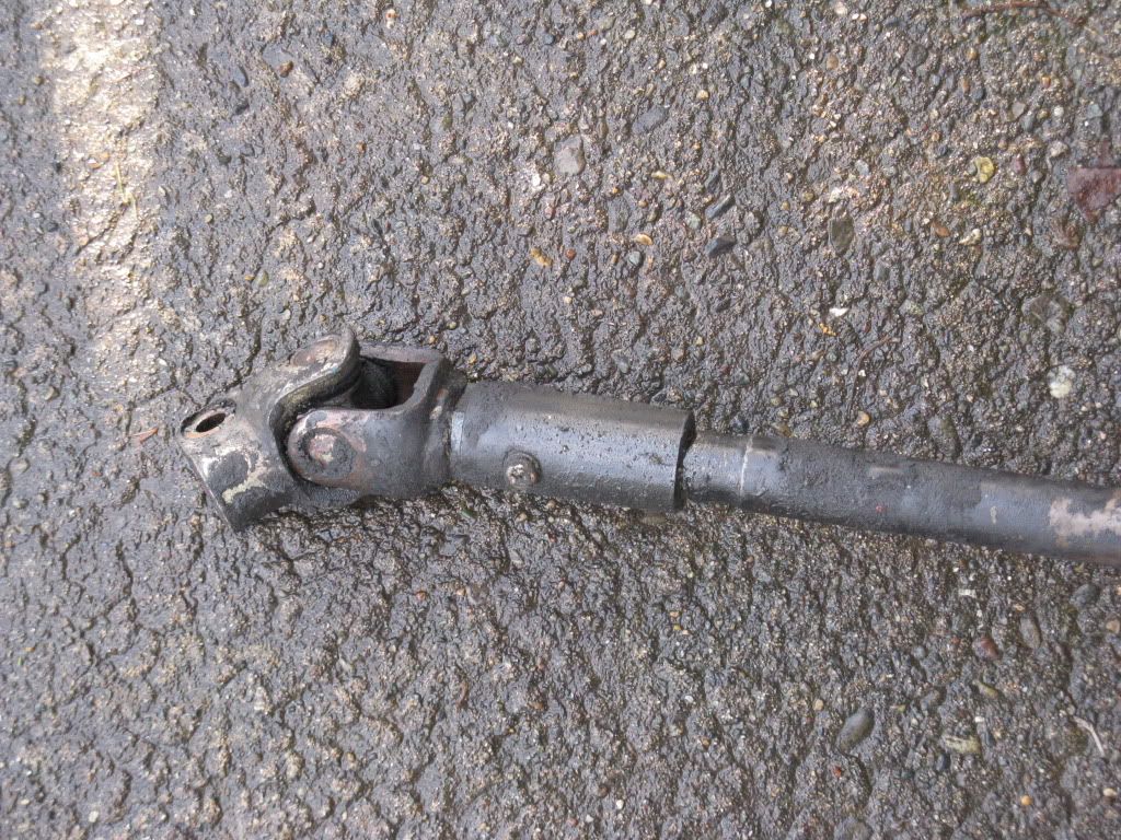

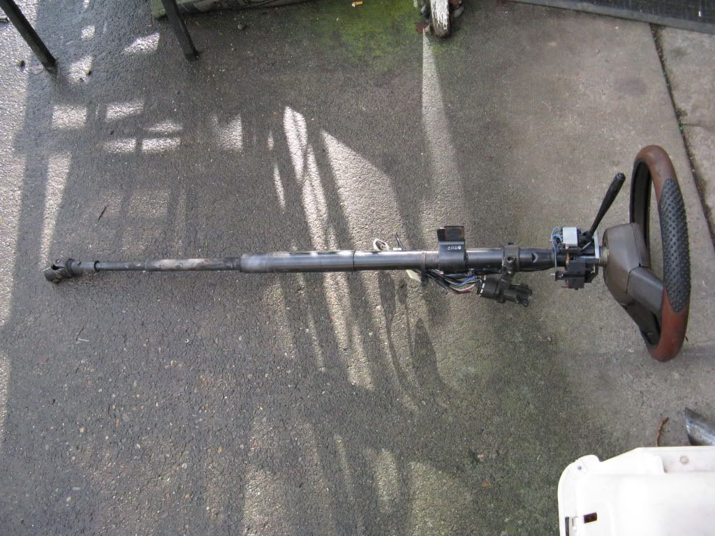

i pulled the whole steering wheel so i could show you guys that you need this little u-joint or else it will not mate with the gear box
you must make sure you grab these brackets

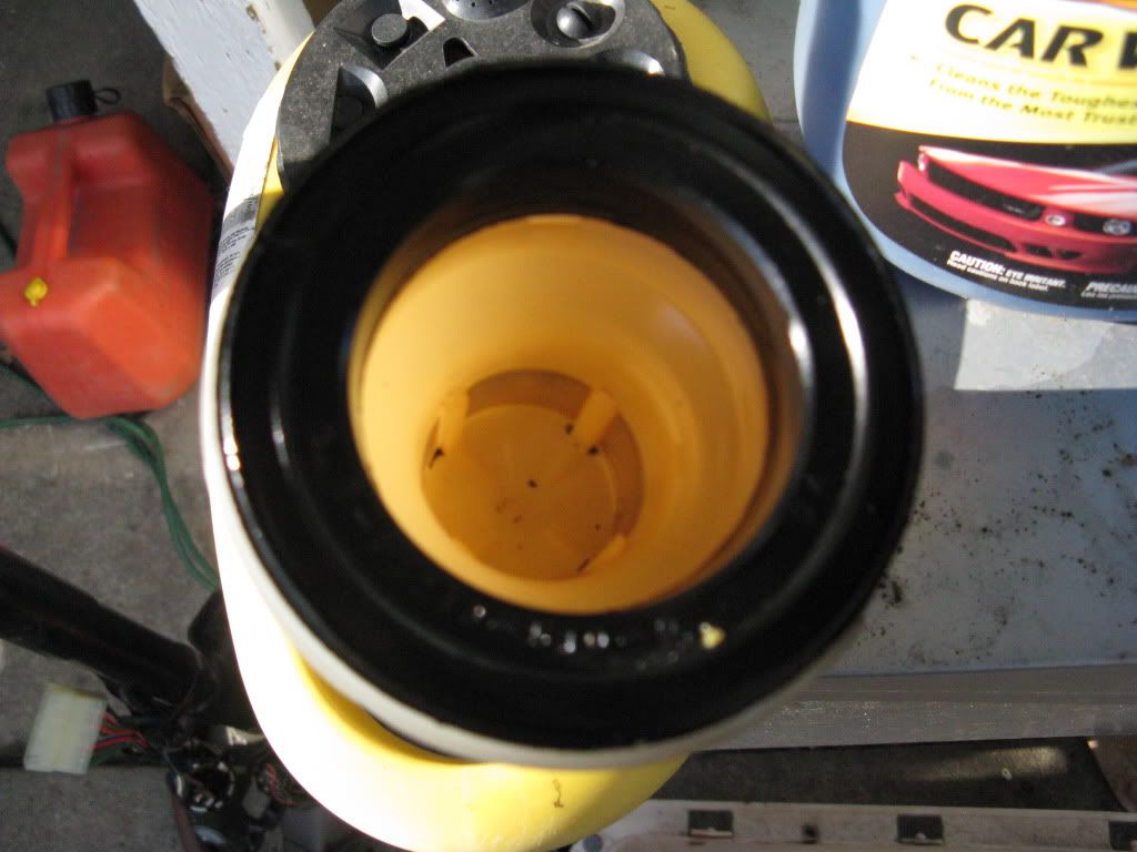

you must make sure this rubber ring and the filter are in good condition.
