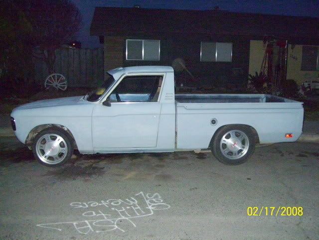

the shop i work for has a kit we use in all kinds of cars and trucks it comes with solenoid wire a hidaway back up button all the stuff you need.on the luv it dont take much to open these doors if you like i can get a price tomorrow i shaved my doors a few years back and made my own weld in panels the key is to weld (tack weld)them in slow and all the way around take your time slower is faster and when you grind the welds down take all the time you need if the metal gets to hot it will warp and do it in the shade keep it kool i hope this helps if you have any ? please ask and if i cant help i am sure some one here will ok ttyl

remarkable it was your truck that i got the idea from, so ya if your shop sells a kit then i would like to know how much it is.
i am fair with a welder and have a little hobby wire feed that might just do the trick.
