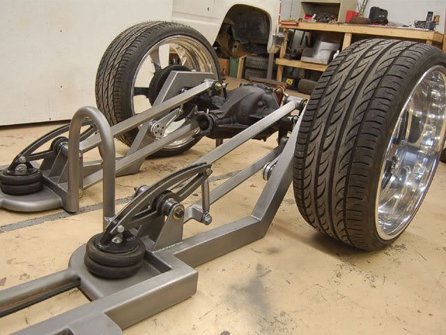

Heres some pics of a setup i like.
1980 4x4 KBD40 ISUZU/Chev Luv
That is a watts link w/a parallel 4 link with cantilever lift, a little extreme for the first time bagger! Badass for sure though! BBT does some amazing work!

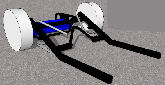

This is the type of setup I was thinking of:
