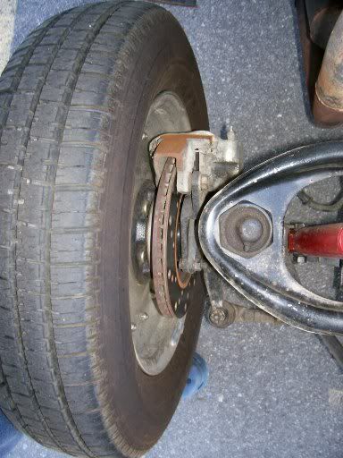

toyota hubs will have the same pattern as the ford. 5 on 4.5. ill try and see if i can find the pic of tj whites' toyota hub swap.
if your still goin for the adapter though, i think luvrv8 has adapters on his luv. you might shoot him a PM.
:edit:
heres that pic.
PostPosted: Thu Sep 07, 2006 6:03 pm
I used the toyota hub and had a machine shop build spacers for the bearings then heated them put them on the spindle so now they are just about permanent. If you use adapters that are fairly thick try looking at the 88 up t-bird for wheels. this will also work if the rear is to wide. 8)

I used 94 toyota 2WD hub/rotor asy's the seals fit but needed to build spacer rings so the bearings would fit then used Mopar 2.2 head bolt washers to space the caliper.If you look close at the picture that Farmer Joe posted you can see the spacers between the caliper and the mount bracket.I am trying to get a camera to get better photos for people. hang in there :lol:
