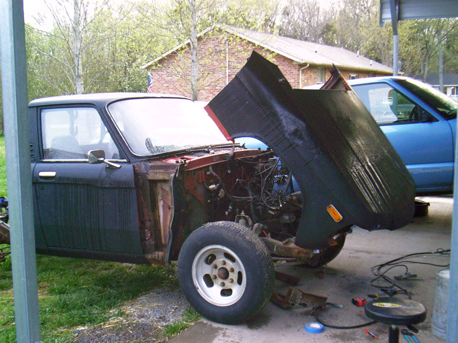

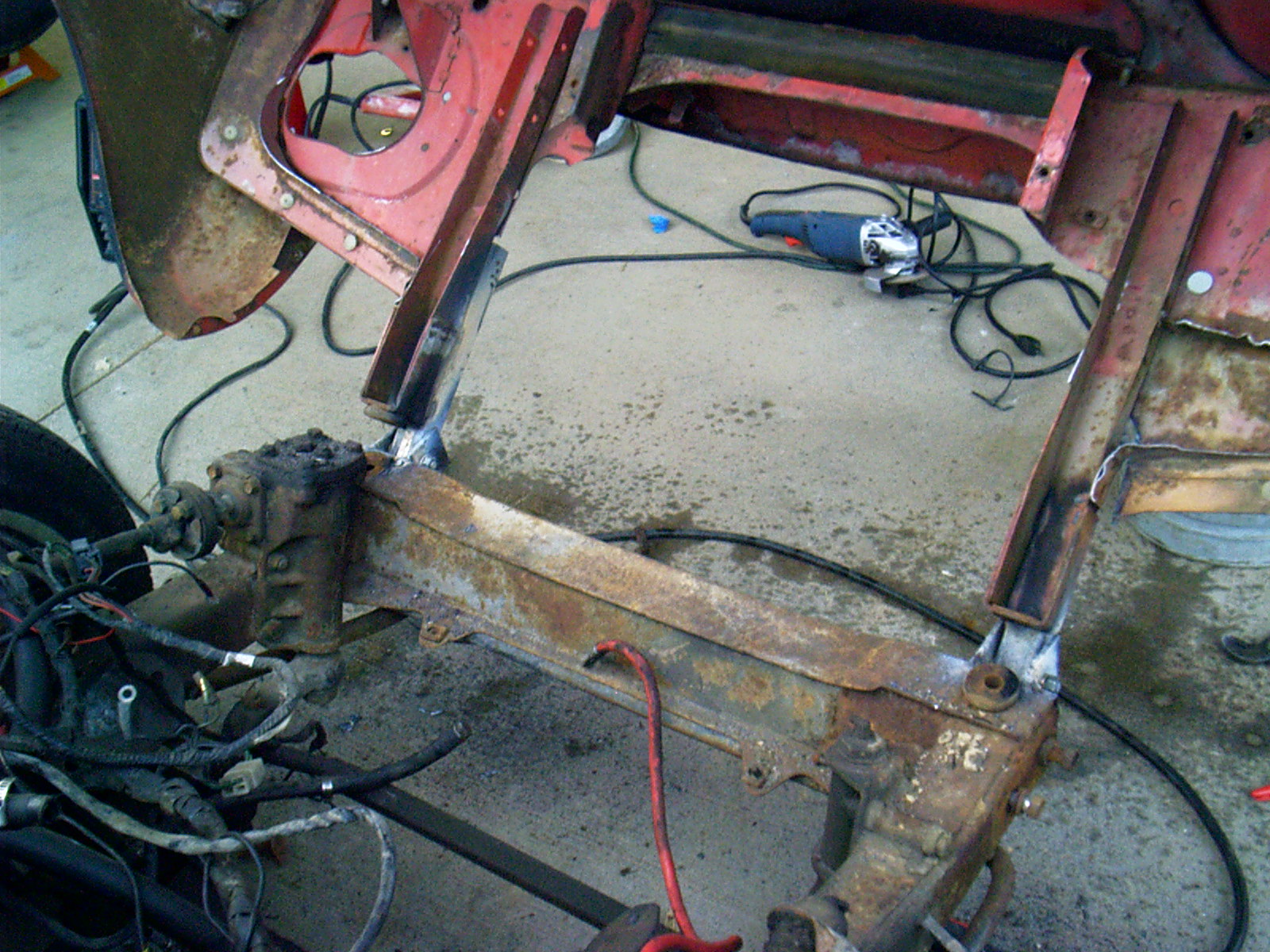

my tilt front end designed by me going to put a shock on both sides like one on the back window of a blazer so when i pull the hood latch it pops open its self. yeah it shuts like the hood did origanally except the whole front end now.

No inner fenders ...i am going to turbo my ls1 6.0l and need the room plus it wont be driven daily or in bad weather just a ratrod.
