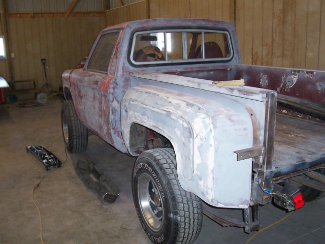

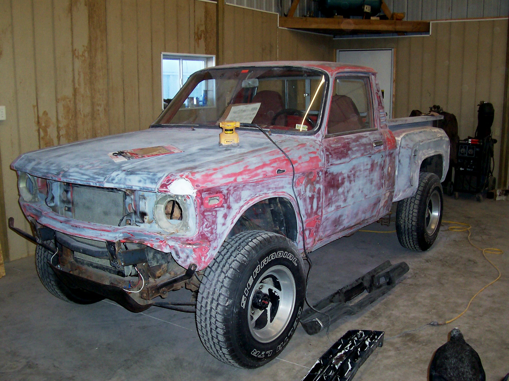

I'm sure every one will have an opinion about body work do's & don'ts, so as a newbie to body work what advice can I get about body fillers ( Bondo) I am going to using case IH primer and Paint to be sure that they don't rebel against each other. And I'm doing a severe amount of sanding. i have a sand blaster, but I do NOT intend to use it on the body panels for fear of ruining paper thin metal...... Help ? Pictures will be up shortly

ok just got these uploaded....

jus keep sanding!!! dont sand blast! as far as a filler, bondo sucks, use a diff brand, make sure you apply in thin layers, and sand it to a smooth finish!
 Post subject: Re: Body Work
PostPosted: Sun Feb 15, 2009 9:46 pm
you never want more than 1/4 inch of filler on repairs, also use a filller primer when you prime the truck.

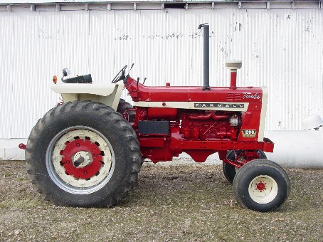

that's what dad suggested I use. I can't remember the number, but I will be an earlier International color. It will be the cream white IH and the brighter red IH paint. It's that Iron guard IH brand stuff you get. Damn good paint. So they say.

That will be a nice combo. (Nice looking tractor)
