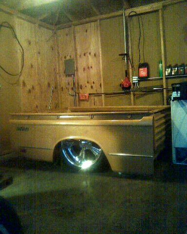

 Post subject: just mocked my wheels

Nice, What size you running?
20 x 10.5 and 5in back space :D

that looks really good. cant wait to see the full truck with the wheels. question? is that chrome trim on the bed orginal.
it doesnt look like it was.... but the light gave it a big glare/shine. idk if that will be on the bed when finished with the truck.

What size are those wheel's and are you going to have to mod the frame or the body to fit the wheels???

no and yes.... i have a ford 9in fitted to where i have room to play and not have rubbing issues. also i am backhalfing my frame it is going to be square tubing and will be fitted to what i need for gas tank and air tank compressor 4 link etc. they are 20 x 10.5. with a 6in backspacing, they are billet specialtie wheels. im running tires that are pretty much even with the lip and are very wide i must say. im body droping the cab and adding metal to the bed so the truck sits flush. i think it would look better that way.

Looks like it will be very cool. what size are your front wheels?

havent decided completely yet... i just go the back to mock up the bed and start my backhalf on the frame. but im prob gona go w 18s 75% sure if not 19s, but that would be pushing it and wouldnt look as nice i dont think. my front wheels wont nearly have as much lip to them. im prob gona go w/ 3 or 4 in lip.
