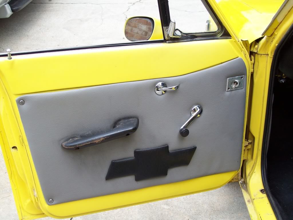

it's pretty easy if the panels are in good shape, if not are the panels good enough to make a template off of. i had to replace one of mine on the stepside i bought, what i used is not sure of the correct type of wood it is but it's like press board or the stuff the make peg board out of just without the holes, you can get it at any home depot,lowe's, etc....made my panel cutting all hole for the door handles,crank and clips.....i first used headliner material over the press board to hide the holes and clips that would show through the vinyl i used....spray an aerisol type of glue or whatever you have..... becareful some adhesives will melt the backing on the headliner material.....once you have everything right( make sure all holes that need to be cut through the headliner material is done before the you use the final material) take the top material your using and start at one end attach it and work from end to end i used staples to attach this material to the back of the board.....once you have the fitt you want carefully cut the final holes for the window crank,door handle and screws for teh arm rest.

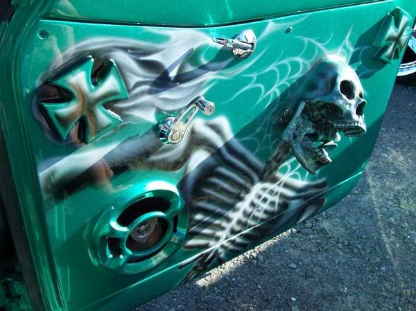

Mine were trash, so I made used them as a templet and made my new panels outta wood, fiber glassed them, did the body work and turned out great

Bagged79: 8O Those door panels are sick.

[quote="800xl"]Bagged79: 8O Those door panels are sick.
Thanks man, I appreciate it!

CT'S LUV wrote:
Damn dude, that looks sweet. I think I might do that to my LUV once I get cracking on it again.

thanks.

Very nice panels CT's LUV. Nice and clean, well laid out. Only thing I would do is get some vinyl dye and get the arm rest looking nice and black again.
Bagged79, again, very nice... Although I'd be a little worried about that skull biting me when closing the door. Love that truck though, absolutely beautiful color.
