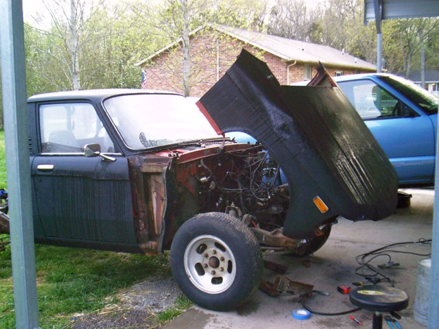

PostPosted: Mon Sep 29, 2008 9:44 am
Posts: 259
Location: Murfreesboro, TN
my tilt front end designed by me going to put a shock on both sides like one on the back window of a blazer so when i pull the hood latch it pops open its self. yeah it shuts like the hood did origanally except the whole front end now.

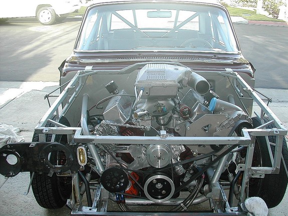

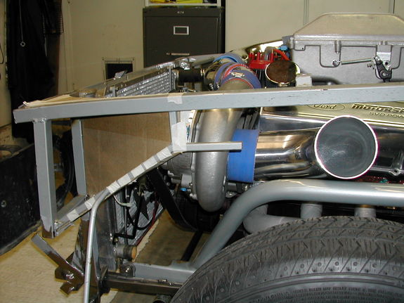

PostPosted: Thu Oct 09, 2008 5:51 pm
Posts: 445
Location: Roseburg,Oregon
look at this design he doesn't really show his hinge but its a nice setup, slides then tilts. I take back what I said on 1" sq. tube it can look nice. Soon the frame and hinge design will take place just been planning I may change some things so will try to update again.
