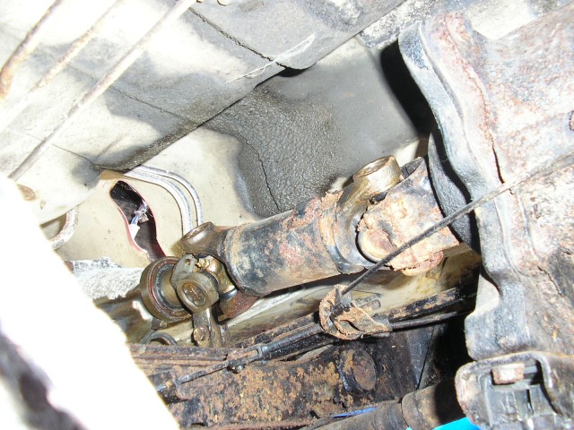

I used the Hooker small block kit, i have a 305 in mine with the turbo 350 trans. I'm pretty sure the axles are the stock ones, used the stock length drive shafts. They are both solid axles, spring over axle conversion with a 3'' body lift that will be coming off soon.
File comment: Rear drive shaft from t case.

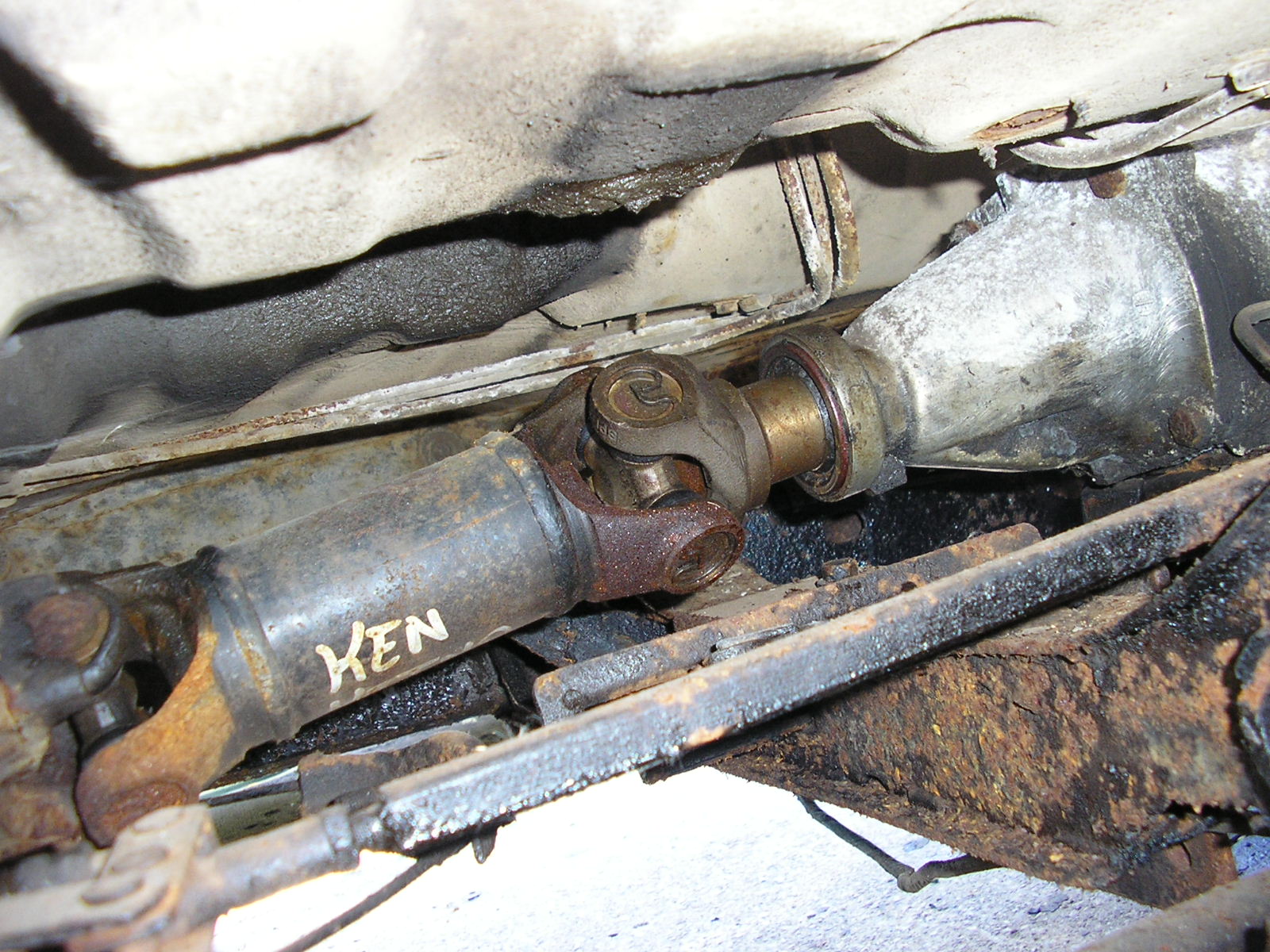

File comment: Had a custom drive shaft made to connect the 350 to the NP203.

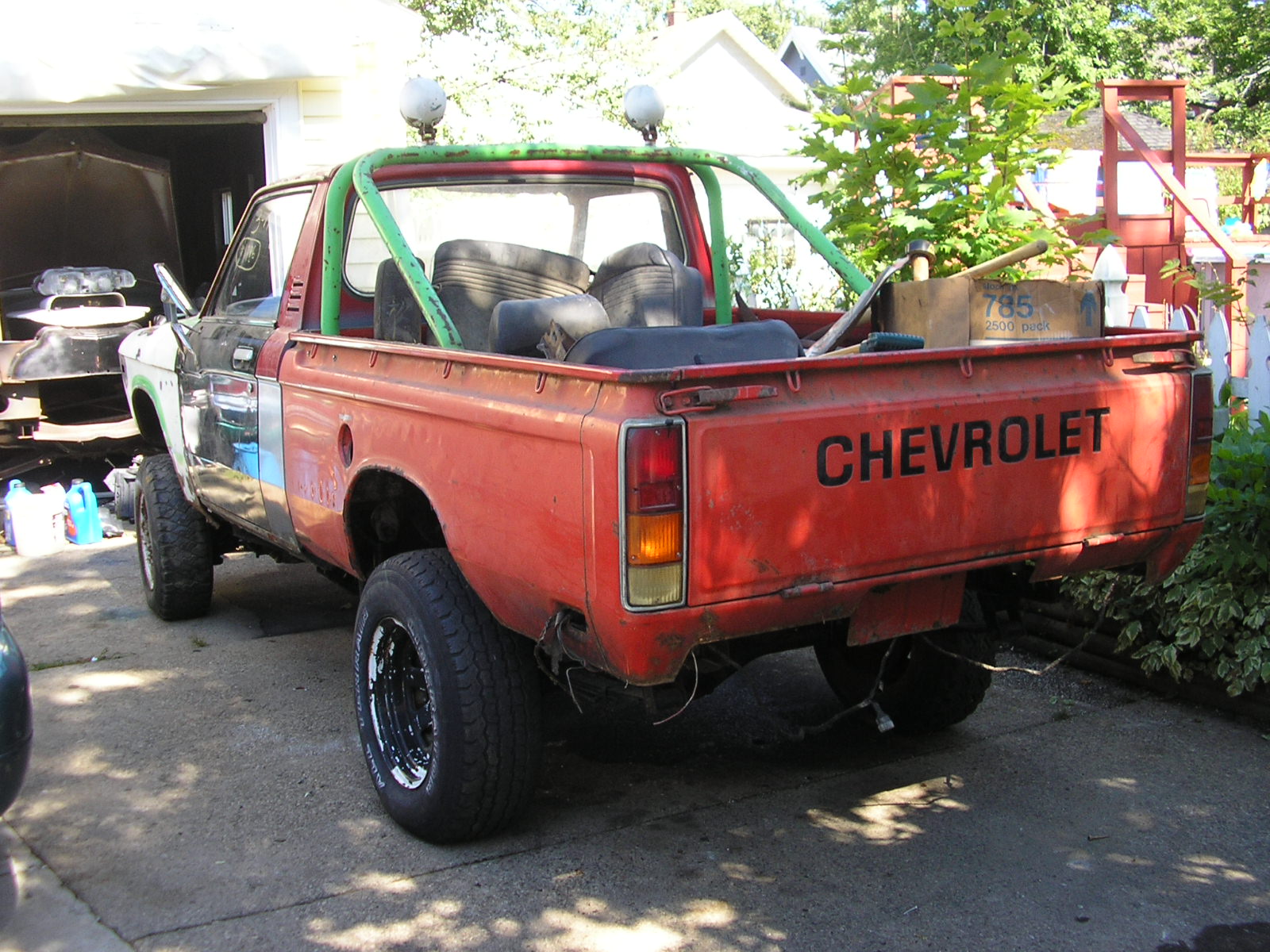

Only thing is i dont know if the hedman headers will fit, i never got the hooker headers because i used to have the ram horn manifolds until our garage got robbed so now i have the hedmans.
File comment: How it sits.

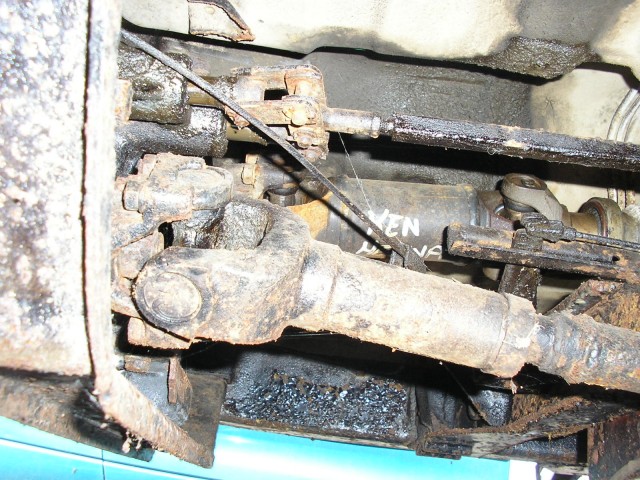

File comment: Another shot of the shaft from the tranny.

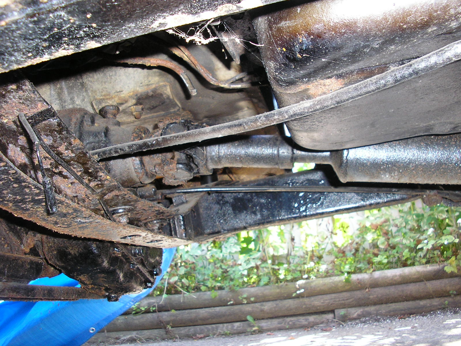

File comment: Drive shaft to the front.
