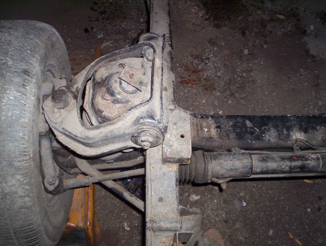

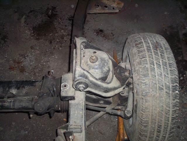

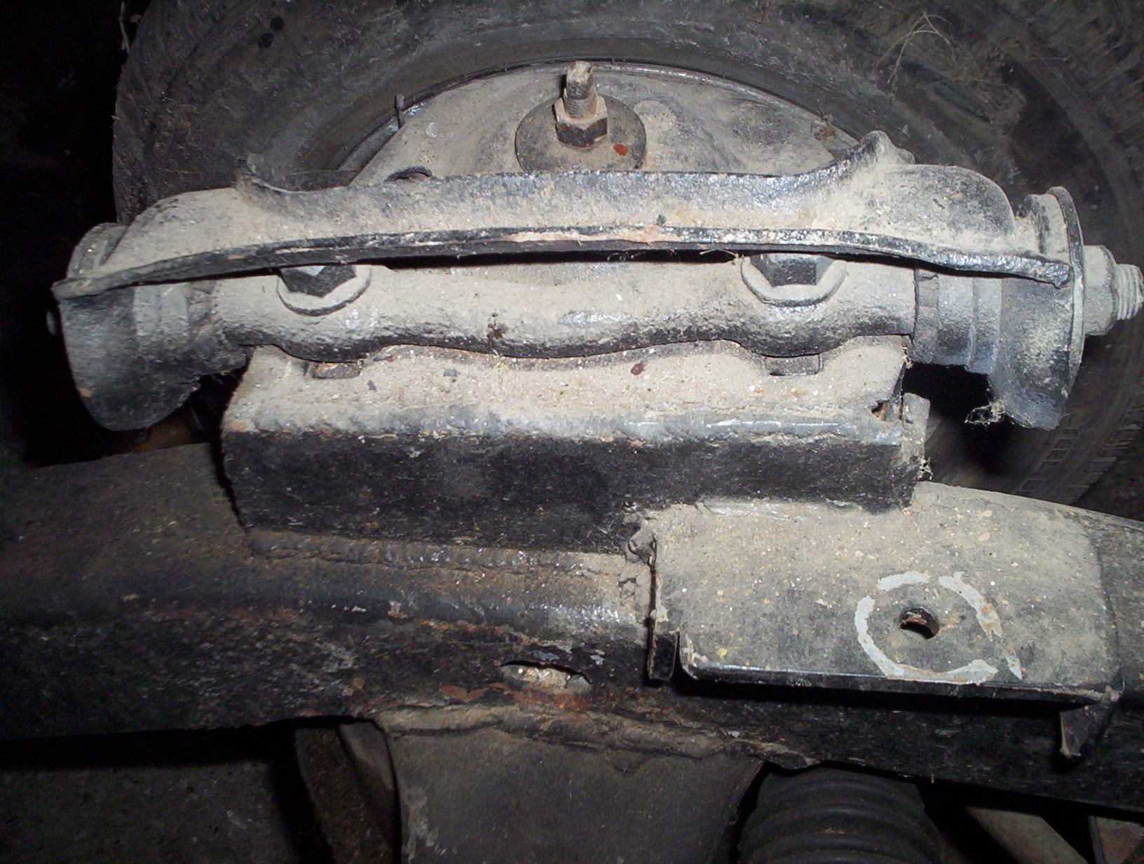

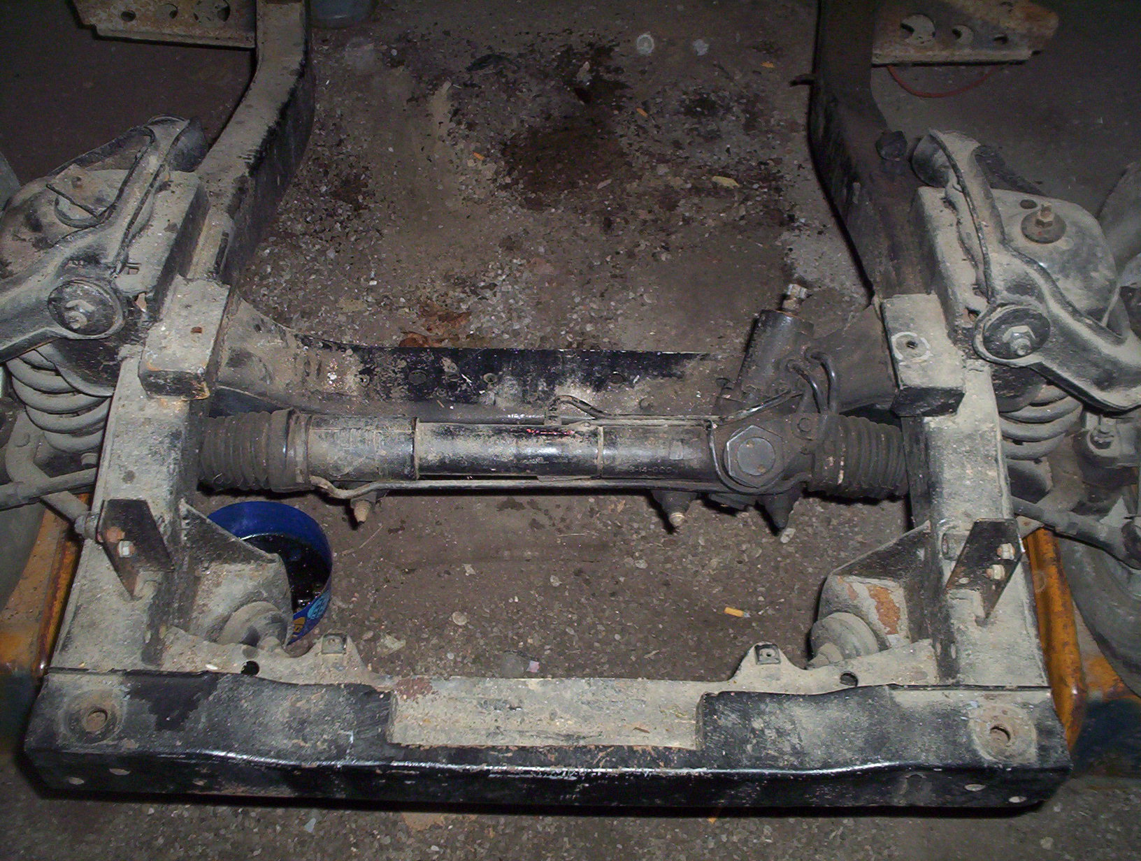

here i did some picks i just notched the frame i just uesd the cross member the mustang II has a rectangel subframe i cut it and then notched the luv frame

more
