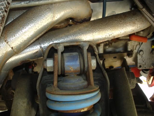

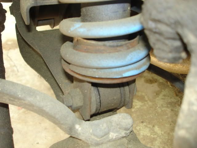

Here is a couple of pics of the coil over conversion on mine. It's pretty simple.

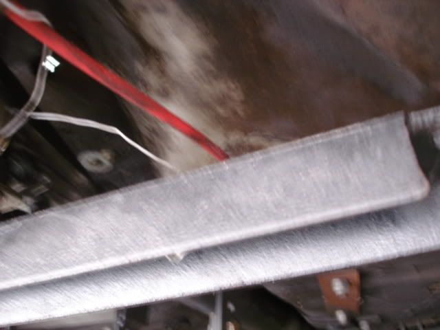

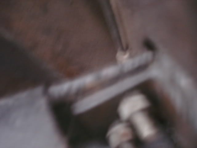

And here is the tranny crossmember, kinda crappy, but maybe you'll get the idea...

Ahh I see. Tranny mount looks simple. I could actually make it a complete bolt on even the side angle iron,
On the coil overs looks like it is regular shocks with the coil around it and some sort of round brackers for the springs.

Yeah it's all pretty simple. Those are Afco non adjustables on the shocks though, not stockers. I'm looking for a deal on a set that will work, I haven't forgotten...

So did you raise your shock mount up at the top by cutting it off and redoing it for the different shocks. Be nice to find a stud mount for the coils.

You can cut 'em. I have done that on several. It just depends on the shock length. If you order new, you can get one to fit without changing the pocket.
